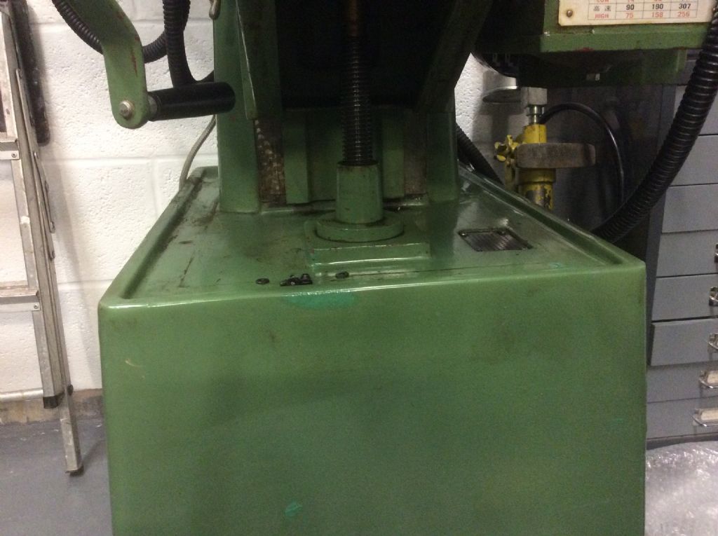

      Could anyone tell me if its easy to dismantle a myford vmf milling machine. Is it possible to transport in a transit van or is the machine to heavy. I don’t know how much one weight as there isn’t much info on the Web about this machine. I’m hoping someone out there has one to let me know if it’s possible, and if it’s easy to detach the column and tray from the base, etc. Can anyone help please.

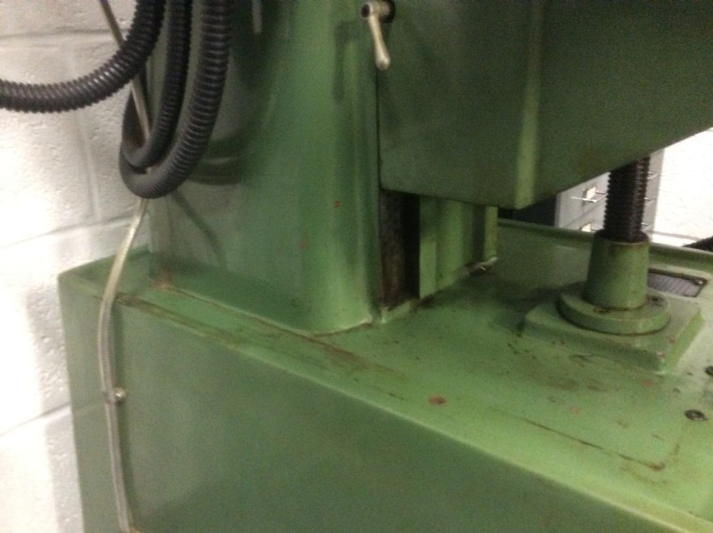

                                              As a VMF owner I can confirm the Base & Column are a one piece casting, to reduce weight the Motor / Quill Head could be removed first but is quite heavy 50-60 kg? The Ram could then be slid out. Sure the X-Y Table could be removed if desperate requiring a fair bit of dismantling but don’t underestimate the amount of wiring to disconnect first though, would recommend transport on a Pallet as a unit if at all possible.
                                              Could be a good purchase if in good condition & if not abused, they are a great versatile mini Bridgeport machine ideal for the smaller workshop, a Raising Block would be worthwhile modification to increase capacity depending on requirements, also as clogs has mentioned a Quill Lock is desirable & I am currently looking at options but seems feasible if you have a second machine to modify the Motor / Belt casting with a Locking Peg arrangement into the Belt Pulley.

                                                Just to be clear Waggonerman, when you say the Base (as per "Base & Column are a one piece casting&quot do you mean the stand (the chunk in contact with the floor) or the bottom of the column forming the horizontal of the L shape. If the latter then the column can be demounted from the stand as we have said.
                                                The lathes website says the stand is cast steel as per the VME. I will duck out of the discussion at this point as you actually have one of these it makes more sense for Nigel to talk to you.

                                                  Thank you all for your help. Sounds like the vme and vmf models have a solid column and base all in one. I did wonder at pictures of them as there is a fillet radius at rge bottom of the column which looks part of the base/stand. I will try to find a pallet truck, pallet and a tail lift Luton van should make it easy without stripping it at all. Kind regards Nigel

                                                    Please see pics below showing Column to Base area (Swarf Tray removed for clarity), as you can see there is no bolted joint, it all being one casting, beware if moving that it is quite top heavy & has a smallish footprint, would strap Base to the Pallet just to be safe if transporting in this way.
