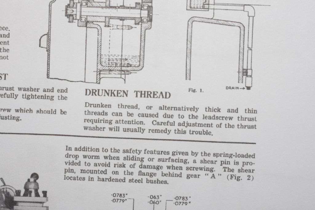

                              #442035
                              Nick Hughes
                                @nickhughes97026
                                From the Myford manual, dealing with replacing the Half Nuts, so ignore the reference to the Saddle and Carriage:-
