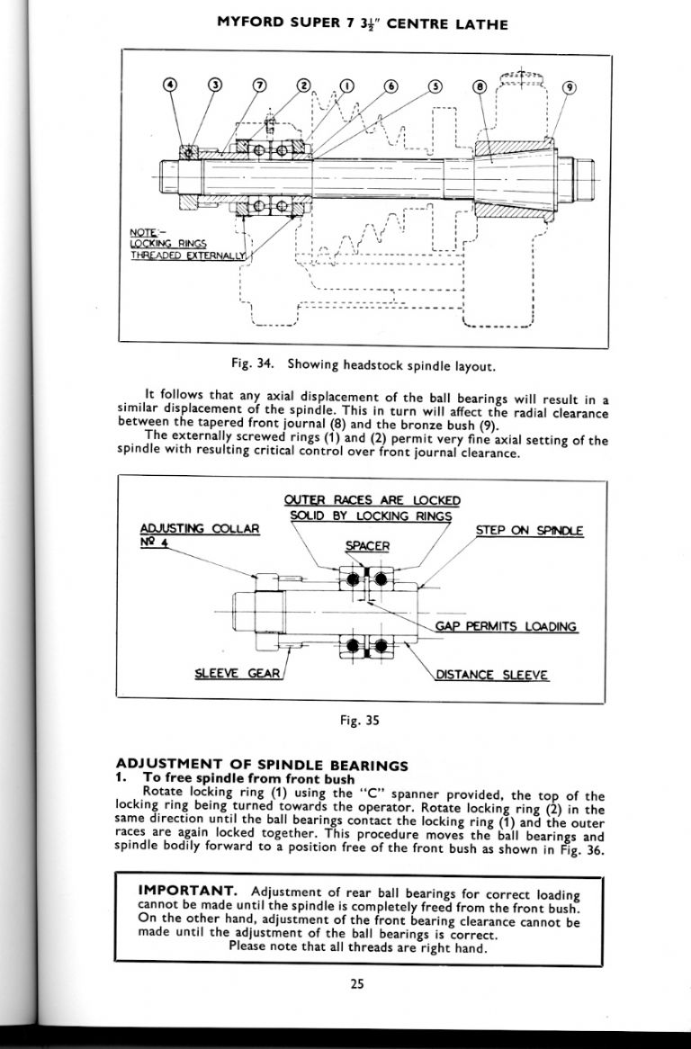

                                      A drawing of old arrangement is found here
                                      **LINK**
                                      What is overall length of old spindle?
                                      I know that one shall not scale from a sketch but?
                                      #372716

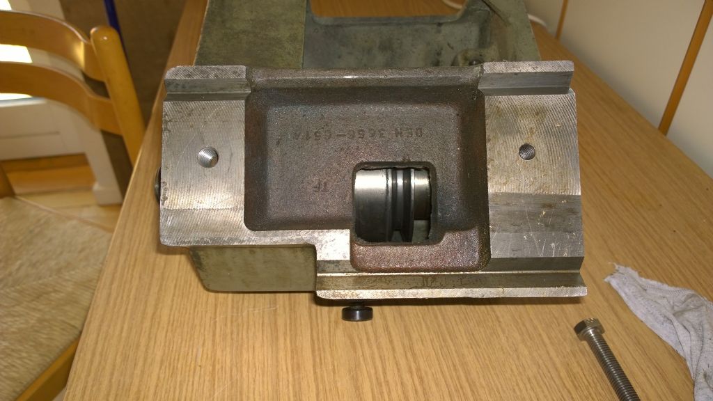

                                        I don't know if it's the same guy making these but I bought a similar 30.5mm through capacity ER40 head through Myford Bits and it's been running reliably for several years now. I have turned thousands of parts on the big bore conversion and it's a joy to be able to chuck up a 1m+ length of bar when you're making parts from stock that's 20mm or more.
                                        There are 25mm parallel OD Morse 2 Taper Sleeves from ArcEurotrade allowing you run your MT-2 taper tooling in the headstock.
                                        #372732

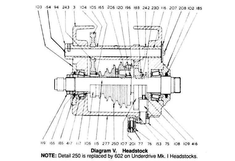

                                            The present headstock bearing hole is approximately 52mm and have been bored out to either 55 or 62mm allowing spindle of either 35mm or 40mm.
                                            Let us asume 40 mm spindle with hole 32mm and bearing outside 62mm.
                                            I have thougth of something like it for upping chineese lathes 180 and 210 sizes
                                            **LINK**
                                            The Roy Milner Gentleman has surely acces to a line borer.
                                            Line up relative to existing 52 mm holes.Bore through 62 mm.Make two spring ring ditches say one mm wide and 2 mm deep and we are in pure Boxford country.
                                            Cheap and dirty and very good

                                              It's my assumption that it has just one taper bearing front and another at the rear as it uses a split adjusting ring clamped with a cap screw at the rear of the headstock, I've not had to strip it yet so I don't have bearing details.
                                              If I ever do strip it I might convert my "spare" head too,

                                                    Pauly,
                                                    I haven't needed to strip it yet and it's used every day for production work at the moment, I currently have a rush of orders owing to people being at home with nothing to do but fit upgrade parts to their projects.
                                                    When I get around to stripping it I will put all the dimensions into CAD and I have an idea or two for improvement when I convert my spare head,
