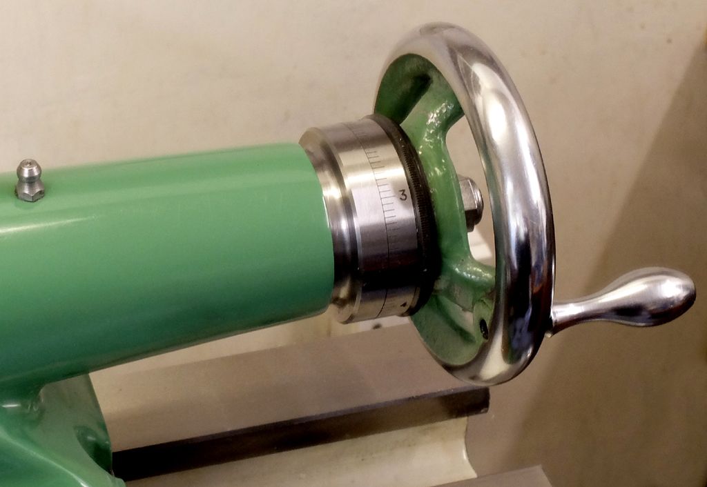

        There has been some recent interest in the proposed Myford Super7 tailstock micrometer dial design by Graham Meek. I'm fortunate in owning one of the imperial version prototypes made by Graham himself and thus am able to report on same.
        The design, in similar fashion to Graham's saddle handwheel dial design, uses a gear train built into the assembly to rotate the dial such that tailstock barrel travel can be accurately determined from the dial graduations. As Graham has mentioned in one of his posts the gearing methodology is perhaps counter intuitive but he has cleverly achieved the required ratio in a reasonably sized unit. The unit incorporates needle roller thrust bearings which in addition to the Myford tailstock thrust races, which are retained, give a silky smooth handwheel action. The dial can be positively set to zero with a smooth action using a friction arrangement as on the saddle wheel. Perfectly reliable.
        Aesthetically the design is very pleasing, and is complementary to both the lathe and the saddle handwheel micrometer dial. It doesn't look like a bolted on after thought. Note that a complete turn of the handwheel gives 0.3" travel to the barrel whereas a complete turn of the dial indicates 0.5" travel of the barrell. This sits readily with the 1/8" graduations on the barrel. No alteration is required to the tailstock feedscrew or barrel nut.
        Graham has been described elsewhere as a worthy successor to the late George Thomas. He also designed a tailstock micrometer dial but I believe that Graham's design is an advance on that with a larger parallel dial that improves readabilty and an improved correlation between the dial and the barrel graduations. The friction lock for the dial is much simpler.
        In conclusion I happily recommend the dial for those in pusuit of accuracy, those who have the saddle wheel version will not need telling.

                      I attended the Doncaster exhibition and there was a lot of interest in Gray's Tailstock dial that I have fitted to my own S7 Tailstock. I was able to demonstrate the gearing of the dial using the Metric version that was set up on Gray's test rig.
                      I was intrigued to see the "similar" offerings on the Myford stand, which leads me ask the question "Has anybody bought one of these items, fitted it and made any sense of the graduations?"
                      Unlike Gray's design, these dials (fitted to a shiny new handwheel) have no internal gearing and are sold as a direct replacement for the existing handwheel. The links to the eBay listings are here for the METRIC version and here for the IMPERIAL version.
                      One turn of the S7 Tailstock handwheel moves the barrel along by 0.300" or 7.62mm. This applies to both Imperial and Metric S7s
                      Taking the Imperial version first, I'm struggling to understand how 0-60 graduations relate to the 0.300" lead, much less relate to the graduations that are engraved on the barrel.
                      The same applies to the Metric version, which is graduated 0-3mm and again bears no relation to the engraving of the barrel on a "Metric" lathe.
                      Rather strangely, the Metric dial would give a better degree of service as an Imperial dial, given the 0-3 (mm) divisions. Indeed, the chap on the Myford stand tried to tell me that "They have just been swapped over mate" until I pointed out that the Imperial dial would not be marked 0, 0.5mm, 1mm, 1.5mm etc. His reply was "Don't know then mate"
                      Am I missing something obvious here? I don't think so but I'm happy to be corrected.
