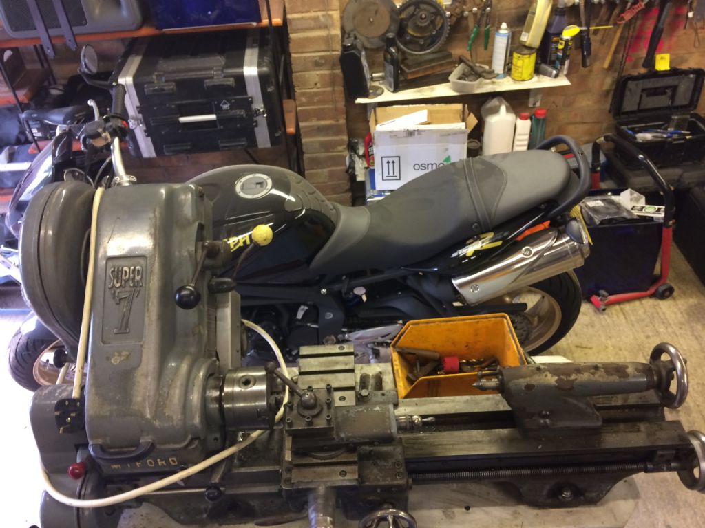

        img_1522.jpgHello All.
        I am a drives and controls engineer, I have applied this knowledge to customer with machine tools all my working life. I AM NOT A MACHANICAL ENGINEER, but have a reasonable understanding and a real interest.
        I have recently purchased a Myford Super 7 to restore and convert the spindle and main feed screw to CNC with positioning servo’s on both axis. I am fitting a 16mm dia, 5mm pitch ball screw to replace the main screw, this is the axis that will have one of the servo’s.
        As a learning process, I restored a basic lathe and fitted a vector spindle, just to understand the mechanics and understand what I needed from the next lathe to deliver the quality I needed.
        YouTube – **LINK**
        When the Myford is finished, I will sell the first lathe.
        The main use of the lathe will be to produce clock gears and pinions, but also parts for my vintage motorbike.

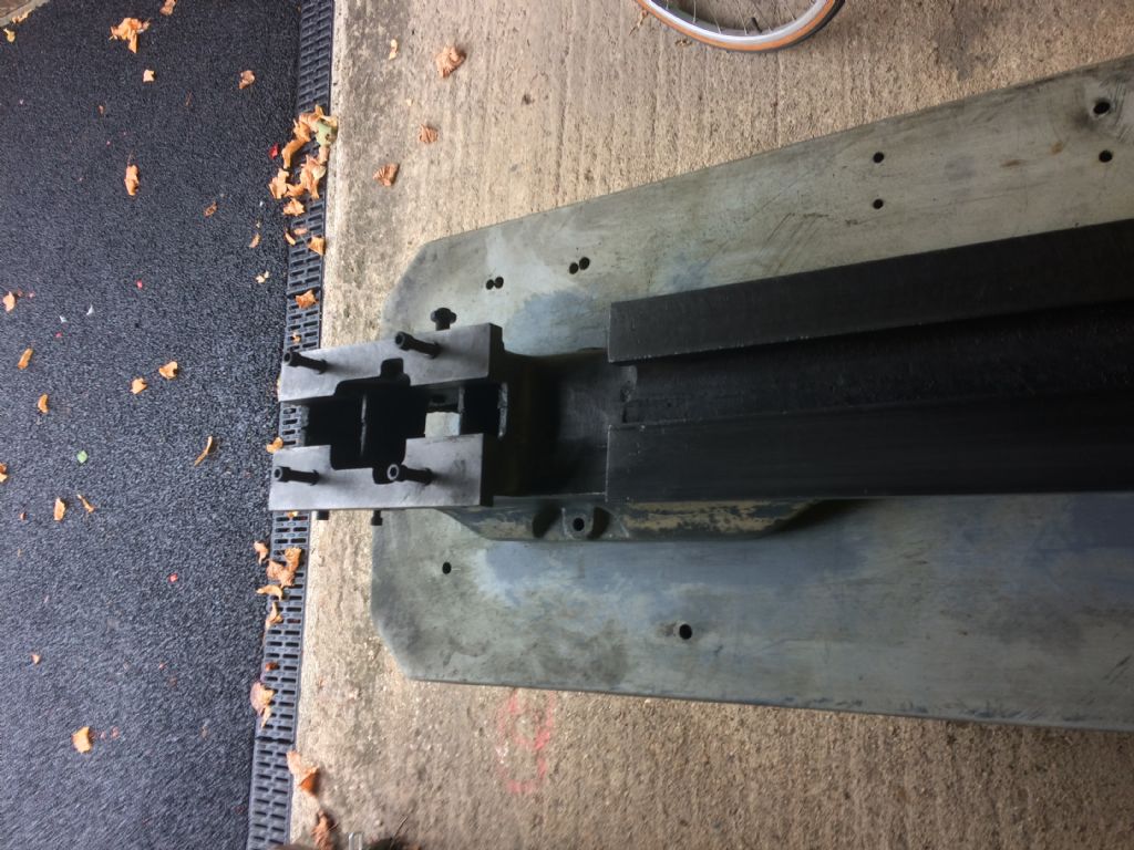

        The lathe is stripped and the bed is away being ground.
        I am going through each assembly and restoring as I go along.
        I selling the clutch and counter shaft, motor, all pulley’s including spindle pulley, rack, screw and apron and all other bits that I do not need. Some bits have all ready been sold.
        My first question is the top and bottom slides. There is backlash, I think it will be the nuts as these are made of an alloy. Where would I get 2 bronze nuts to replace the original nuts?
        I understand that backlash is not always a problem as it can be overcome with good practice, but I want to reduce it to a minimum
        I am tempted to replace these primitive screw’s with rolled ball screw’s and include a locking mechanism on each axis as the ball screw will not hold position as it does not have enough friction. This would allow servo’s to be added on these slides. But this may be a job for latter.
        I have many pictures I have taken along this journey and I will have many more before I reach the finish line. I am not sure about the norm of this forum but I am happy to share them.
        I would welcome the answer to the above question.

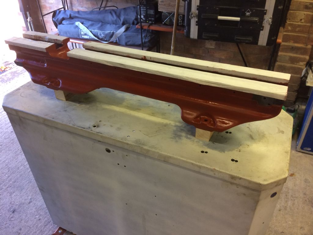

                                      Top coatBed primedJust starting to paint main bed with enamel

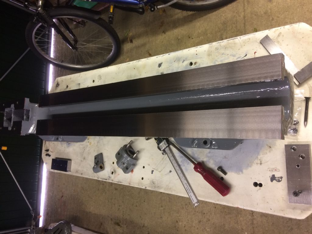

                                            Just finished the final bit of painting. Start propper engineering in the morningPainting finishes

                                              Posted by Andrew Davies 4 on 03/10/2018 12:45:39:
                                              Sorry to say that looks like a crappy regrind you got there.
                                              Did they skim the feet first and also do the vertical shears & undersides?
                                              Martin.
                                              Edited By blowlamp on 03/10/2018 13:21:19
                                              Edited By blowlamp on 03/10/2018 13:22:03
                                              #374366
                                              Nick Taylor 2
                                                @nicktaylor2
                                                Have to agree with Martin, it looks like they have left the corners 'sharp' as well, they will wear poorly. You'll probably have to relieve the internal corners of the saddle and tailstock casting as well.
                                                If you look at a factory fresh bed the chamfer is considerable.

                                                      Yes they did the feet first and the undersides (picks on request) , the only faces they did not do where the inner vertical and the inner underside. I do not think this will be a problem.
                                                      Can I ask what you think the problem is so I can look into it further? I have clocked all edges and they are fine.
                                                      It is easy to be negative from a distance, but constructive input would be better, crappy does not help.
