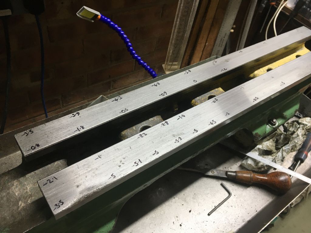

          Apologies all – I'm struggling to keep up with all of the information, but I'm formulating a plan for today:
          • Check the spindle bearing play
          • Adjust the bearings
          • Take spindle nose measurements again, this time without belt tension (last time measured under tension)
          • Try turning between centres to eliminate the possibility of headstock misalignment
          • Test the concentricity of the test bar
          • Lay in the sun to recover and contemplate findings
          Gray: below is a photo of the measurements showing the difference from the unworn end of the bed in thousands of an inch. This only shows the thickness difference. Somewhere I have a photo showing the width difference. I know there is an unexplained very worn area on the front of the front shear that I've posted about before, but I'm fairly convinced this is not influencing anything.
          Mike
          Edited By Mike Donnerstag on 30/05/2020 10:48:21

                Wow look at the wear on the front corner of the bed there at the left. She's been rode hard and put away wet. Looks like long and repeated use of a die stock or tap wrench on largish threads with the steel handle of the wrench/stock resting straight on the bed there. Was this lathe used commercially or for production work of some kind before your stewardship?
                But yes, that scarring will not unduly change carriage travel overall. Provided you have run a flat file over it to knock off any raised burrs and bumps that could well be there. Especially on the front vertical surface. A 10" single cut mill file is perfect for this job. It does look in the photo as if there could be some raised bruising around the edges of the scar. Hard to tell from pics though.
                More than the thickness of the shears shown here, it is the width across the outside (in your case of wide guide bed) that is critical. The wear on the rear vertical surface that guides the wide guide saddle is critical, allowed only 3 thou wear before a regrind according to Myford literature. You can also measure the width of the rear shear itself to ascertain the amount of wear on the rear surface. Wear on the inner vertical surface that far up the bed should be negligible as the tailstock does not go that far. Tailstock does wear those inner vertical surfaces where it runs bak and forth.
                Pete Barker
                Edited By Hopper on 30/05/2020 11:00:47

                        Hopper: I don’t know much about the use the machine had been put to prior to my owning it, but I think your suggestion of a previous owner threading using a die-holder would account for that bed wear.
                        Measuring again, apart from the last 2 inches of the bed, the bed width across both shears shows no more than 1thou of wear (not bad at all!), according to my digital calipers (the only micrometer I have is 0-1&rdquo. This includes the visibly worn area on the top of the front shear. The final 2” measures 1.5-2thou above that, which accounts for my initial wear measurement of 3.5thou.

                          Thanks for the info on the Bed, it does show she has had a hard life. I would hazard at a guess that the Universal Parting Tool has been used quite a bit on this lathe. There are slight nicks showing in the rear bedway which makes me think this is all Hacksaw damage. Having previously owned such an example. Luckily for me mine was not so bad and at the time I had access to the necessary equipment. An hour on the Snow Surface grinder soon had the bed back to new. The question then has to be asked why was the Hacksaw used in the first place, Inexperience perhaps? or Chatter due to a sloppy or worn bearing?
                          Looking at the wear across the bedways then on average you have roughly 1 thou more wear on the front edge when compared to the back edge at that station. This does not concern me as the tool height will only be effected by this.

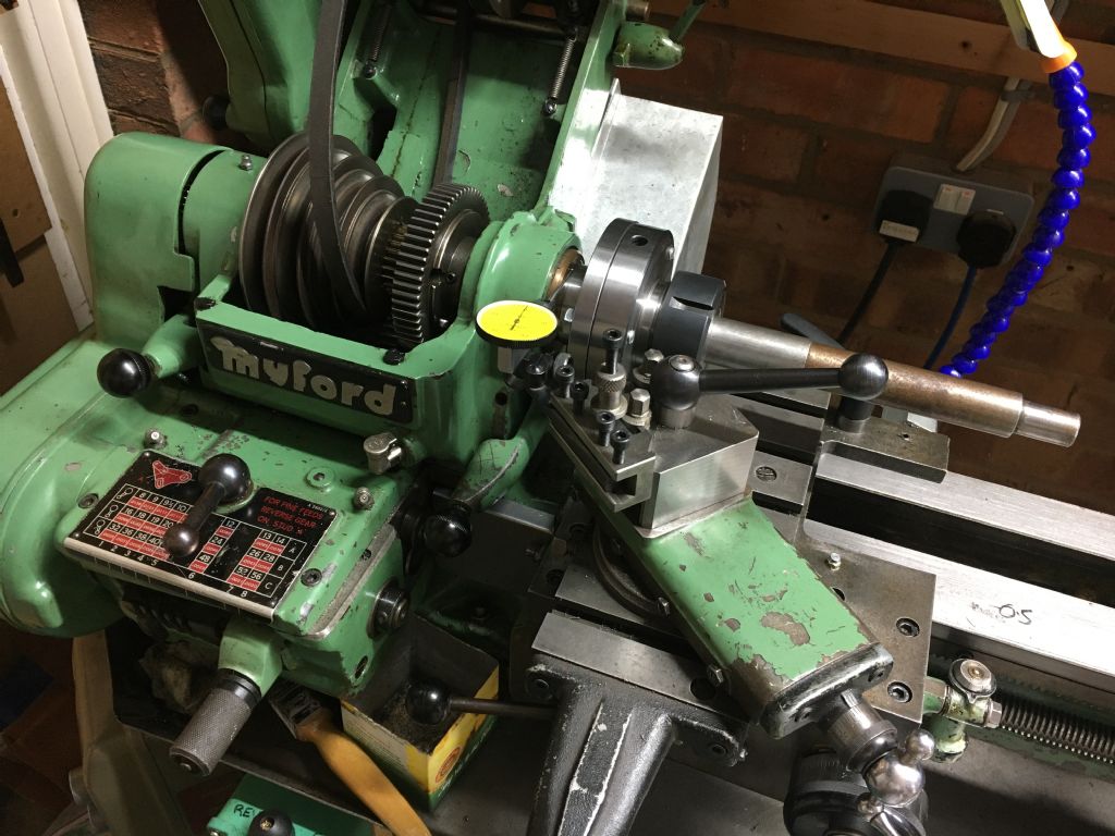

                                I’ve just chucked up a bar that gives me around 10” from the bearing as leverage to check bearing play and found the following movement:
                                vertical: 0.0012” TIR
                                horizontal: 0.0016” TIR
                                I’ll search for previous bearing adjustment posts to see if this is ‘normal’

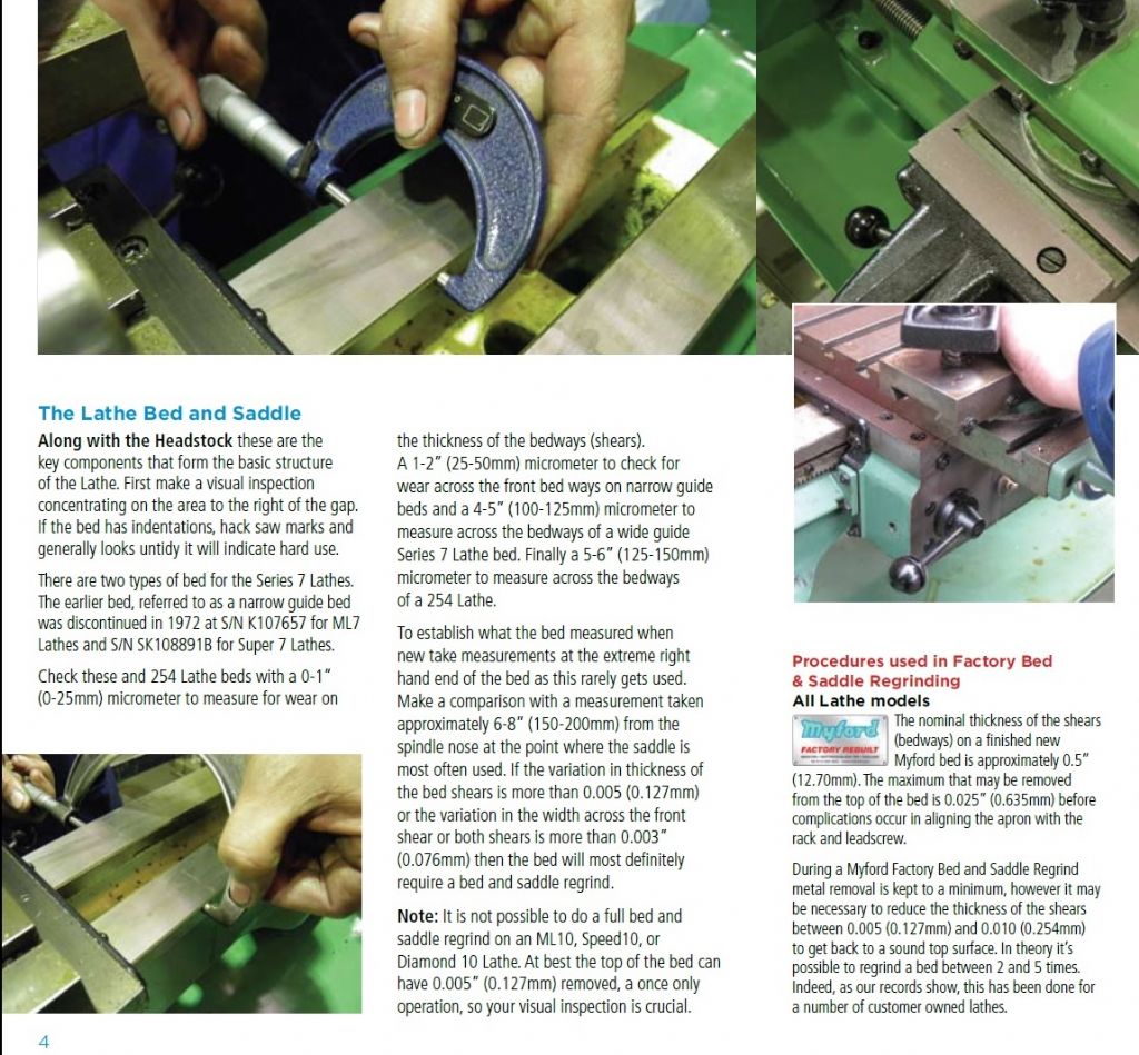

                                    Martin: The maximum wear on the bed, according to Myford, is given below, which is indeed 5thou, not 0.0005" (1/2 thou):
                                    Mike
                                    Edited By Mike Donnerstag on 30/05/2020 18:07:09

                                        That is not how I read it. The above really talks about the maximum metal that can be removed before the bed is scrap. (0.0025&quot and goes on to say that whilst they keep the material removed to a minimum they may have to take between 0.005" and 0.010" off to get to a CLEAN surface. By this I take the meaning as 'ding free'. If you use your logic you could just as well assume that the allowance is 10 thou.
                                        regards Martin
                                        #476160
                                        Mike Donnerstag
                                          @mikedonnerstag
                                          Martin: Apologies – I had only given you half the information! I've updated the photo in my last post with ALL the information that Myford gave on assessing lathe beds.
                                          According to the document, the allowance in thickness is 5thou.
                                          Mike

                                              Niko: I was using a bar held in a chuck, giving 10" of leverage from the front bearing, with all my might! Not that I'm all that mighty! wink I got between 0.03mm and 0.04mm on my metric gauge.
                                              Here is my setup:
                                              Anyone: Is this what you would expect?
                                              Just to reiterate my questions stated earlier:
                                              1. What radial movement they would expect at the spindle nose, using a bar held in a chuck as a lever?
                                              2. How do I measure the spindle end float (axial movement)? Do I need to use some kind of lever against the bull wheel for example? I understand this should be 'measured' as zero.
                                              3. Is it possible to obtain a 'new' spindle, if I deemed that mine needed replacement?

                                                Using your method the newer one gives 0.02 mm and the older around 0.04 mm of indicator movement. Niko.
                                                #476197
                                                Mike Donnerstag
                                                  @mikedonnerstag
                                                  Niko: Interesting. So, only just under my own measurement. I think I’ll assume the bearings are adjusted okay and try something else, such as doing a test-cut between centres.
                                                  Mike
                                                  #476198
                                                  blowlamp
                                                    @blowlamp
                                                    Is the lathe turning 'round'? Machine a short length of stock and use your micrometer to check its roundness – you should lock the micrometer once set to a nice slop-free fit and rotate the freshly turned portion to feel if it is notchy or tight then loose, which would suggest that there might be a problem with the spindle or bearings.
                                                    If that is OK, then I wouldn't worry about the spindle or its adjustment too much. You don't use the test bar as a lever at all – just light to firm finger pressure will do to establish wear, any more pressure is displayed as deflection and adds to the confusion.
                                                    Don't forget that the front bearing needs some clearance for an oil film to develop when it is rotating. The fact you stated earlier on that it was cutting cleanly makes me think there's not a lot to be concerned about with the headstock in general.
                                                    Martin.

                                                      Posted by Mike Donnerstag on 30/05/2020 18:08:40:
                                                      Mike
                                                      Edited By Mike Donnerstag on 30/05/2020 18:27:11
                                                      OK. Point taken, I was working from memory, never the most reliable of sources which is why I asked where the info had come from. It still seems a large allowance to me but if that's what they say, that is what they say.
                                                      I still would be concerned about the variation front to rear. If it was even, as has been stated it would not matter too much. I'm fascinated to see the resolution of this.
                                                      regards Martin
