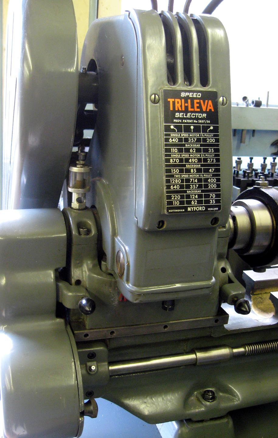

        I saw this on Tony's wonderful site lathes.co.uk
        http://www.lathes.co.uk/myfordtrileva/img8.jpg
        It shows a speed of 1280 rpm is possible for the ML7.
        Yrs,
        Jolly

              Posted by Jolyon de Fossard on 16/10/2012 23:23:53:
              Jolly
              That's using the Myford two speed motor to which I referred earlier. I haven't heard of any incidents of problems with Tri-Leva lathes so fitted, hence the choice of a 2800 rpm motor and speed controller which does the same thing only using modern technology.
              Regarding safety of chucks, if the same chuck is suitable for a Super 7 with a top speed of 2100 rpm then it is obviously OK in this application too.
              Andrew M

                My ML7 Tri-Leva with the 2 speed motor does 1280 according to it's speed plate.
                The motors used with the invertors are 1450 rpm and the 200% fequency used doubles the speed of the motor to 2800 rpm.
                Terry.

                  Do you run your ML7 at that speed occasionally ?
                  Yours,
                  Jolly
                  #101181
                  Terence Yates 1
                    @terenceyates1
                    Hi Jolly, I do run at 1280 rpm now and then. There has never been any problem, I just oil the layshaft bearings and turn up the drip feed oilers a little.
                    Terry.

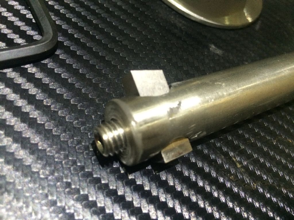

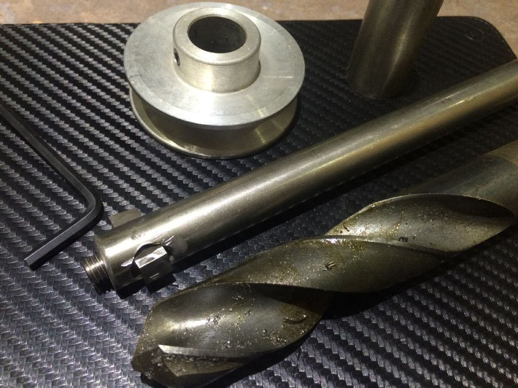

                              "I've ordered a new 2 1/2" pulley but it is 3/4" bore so I will open it up to 24mm. I don't have a broaching set and they seem a bit dear for a single use at this time so I propose to use the grub screw provided and see how it feels."
                              Presumably this would be for the keyway? You can do that in the lathe, too, no expensive broaches needed… see e.g.

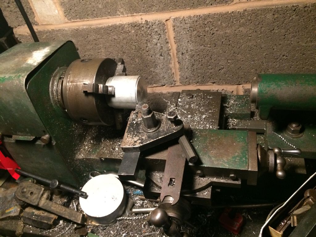

                                                  If so this should be a photo of the unknown old friend of a lathe I'd like to know the make of

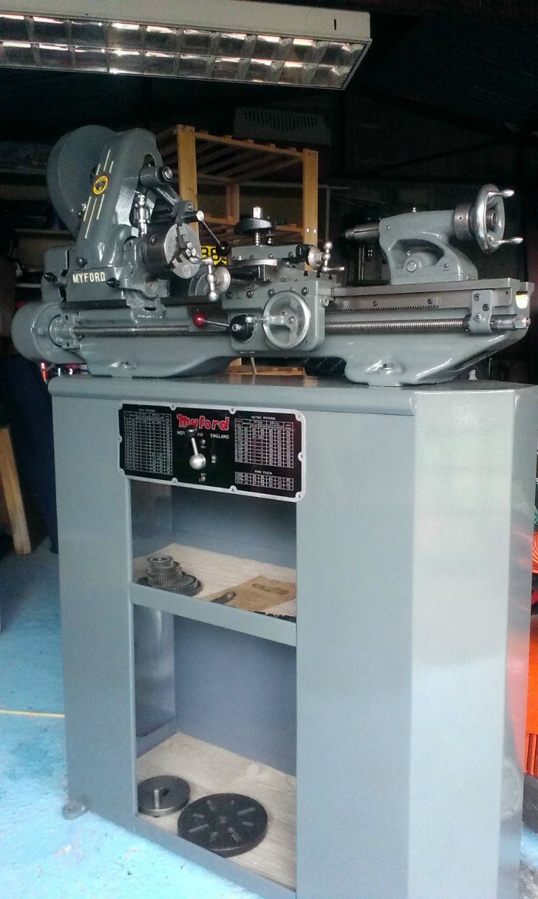

                                                  and this is my Myford when I got it I think maybe what I called the Dewhurst switch before, isn't one.
                                                  and this is my assembled kit to do the new motor pulley, consisting of the pulley to bore from 3/4" to 24mm , a scrap bit of 24mm round bar to try in, a 24mm drill and the tool I have made being some more scrap bar with a 22.5mm piece of HSS 8mm square held in a 11.5mm hole by an 8mm grubscrew. My biggest reamer is only 21mm so I may see if a friend has a 24mm as he does stuff of those really big steam traction engines so everything he has is big. That is a job for tomorrow.
                                                  and the tool

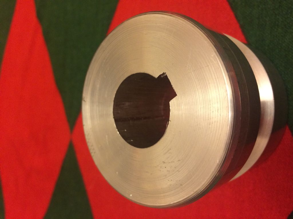

                                                      To update you guys, I bored the pulley I bought from RGD with the 3/4" bore out to 24mm bore but I felt it left insufficient metal so I decided to make a pulley from the aluminium that is shown in the chuck of the old lathe picture above.
                                                      I drilled it a little undersize and I borrowed an adjustable reamer from my friend Graham to make it an interference fit, and cut the keyway as shown in Pete's You Tube video link. This took about 40 passes! I then drilled and tapped an M8 grubscrew thread. I have left it chunky as I can't see any advantage in cutting it down or making it thinner. I did think some sexy grooves would look nice but serve no purpose. I may see what it looks like on the motor shaft when it is lined up with the layshaft pulley.
                                                      The Vee groove itself was made with a parting tool, first the deepest bit then the sides to 40 degrees. I got the dimensions from the web. I've tried an A size Vee belt in and it was a good snug fit the flat top of the belt level with the top of the pulley, and it runs true..
                                                      So I have listened to at least some of the advice here and the project is now underway….. thanks again! The money saved not buying a broaching bar I propose to squander at the Chrystal Palace show.
