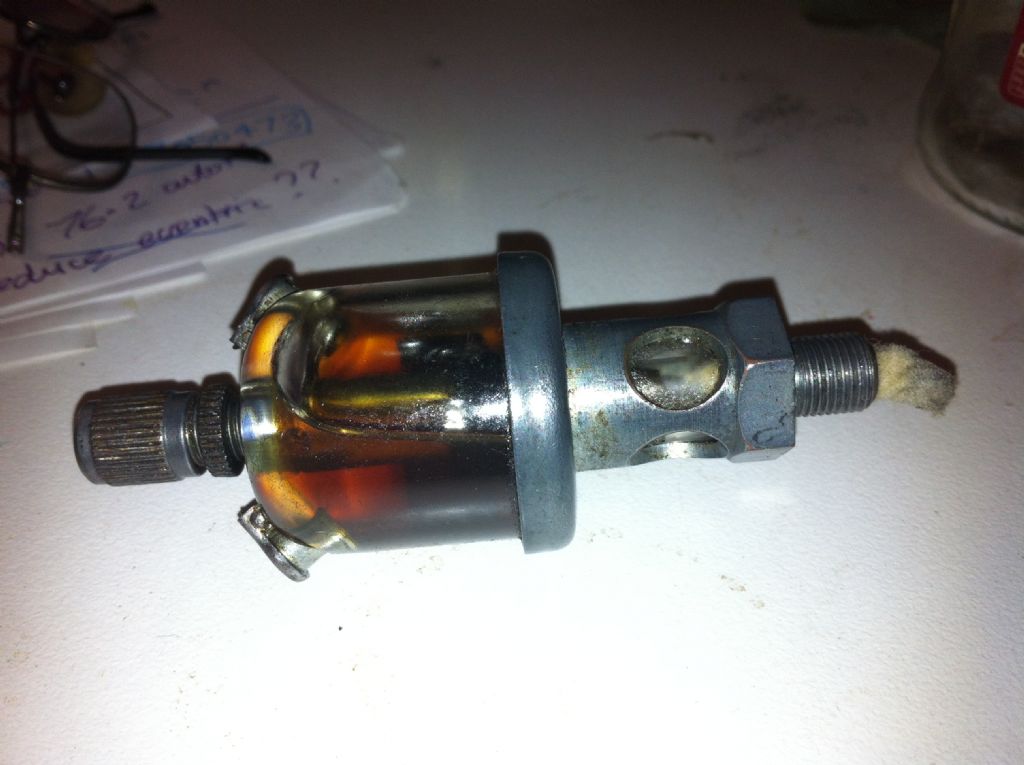

                      @simoncollier74340
                      This oiler and it's twin are not feeding. I have read the posts but it is not at all clear to me how to get it apart. The top knurled nut can be undone but then tightens again towards the top and won't move. The lock ring is loose. I have not used grips or anything on the top nut but await advice. The wick is dry. I have just got the ML7, more as an historical artifact, and because it was only $300, as I have a very capable lathe. I am not familiar with Myfords but have determined that it is a 1964 model, and it appears to be in excellent condition. No doubt I will have more questions.sight feed oiler.jpg

                          I cannot help you with your repair as I have only ever used drip feed oilers, but if you are unsuccessful and require replacements Adams of Coventry still make (yes make believe it or not) the exact oilers you would need.
                          Models USF and SWF in the PDF below.
                          http://www.adamslube.com/Oilers_Main/Oilers_Cat_PDF/Drip_Feed_Lub.pdf
