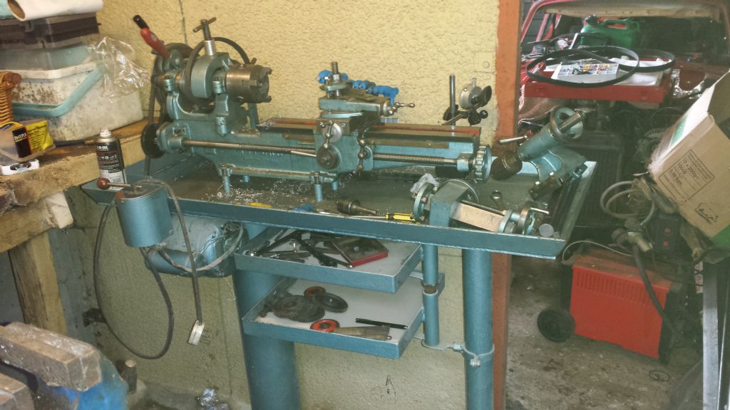

      Yes it looks like the old engineer fabricated that reversing tumbler and belt tensioner himself. Judging from the rest of his work, it is quite possibly a better set up than the original ML2 rig.
      It looks from a rough count of the gear teeth in your pics that he has a 30T on the mandrel and a 30T gear as the inboard gear on the tumbler output stud. So that gives you a 1:1 ratio. So, yes, you could set up your 20T gear as the outboard gear on the same stud and it would be the same in effect as having a 20T mandrel gear.
      Thus you could put your 20T on the reversing output stud, the 50 on the leadscrew with a couple of idlers of whatever sizes fit to connect the two together in a train. Dont use any compound gearing in the idler train. Just gear to gear to gear etc.
      I reckon if your old lathe could talk it could tell some stories. Quite the innovator that previous owner by the looks. It would be fascinating to know what models etc he made on the old machine over the years.

        Thanks Andy and Hopper. I was told the original owner used it to build model jet engines, The table he built for it weighs a bloody ton I can tell you that…I had to take the legs off it so I could move the table top. I think the compound on the tumbler is one piece so i may be buggered unless I can find more Mod1 gears but being new to lathes I have no idea what they would be fitted to as standard or where to look for them. According to the PDF version of the user manual, which assumes the reader has a good knowledge of lathes already, any of the change gears will fit on the mandrel but I'm sure the mandrel is a bigger diameter than my 20dp change gears but I'll check to be sure. If I can swap out the Mod1 gears and forget the tumbler reverse and go direct from mandrel to lead screw via idlers all using the 20dp change gears that'll allow me to cut threads. Then I'll put the Mod1 gears back on so I can use the tumbler reverse and also benefit from the very slow feed rate…does that sound feasible?
        In the mean time I'll try and find out where I can get hold of more Mod1 gears so I an build up a selection so I don't have the mammoth swap out each time I have a thread to cut.

            I dont see where it says what the mini lathe gears' module number is, but if you contact Ketan at ArcEurotrade i am sure he can quote you chapter and verse on that stuff.
            I would still try to figure out how to use the 20dp gears that you have. Is the gear on the main spindle 20dp? if so, and the last gear in the tumbler group is the same number of teeth, you have a 1:1 ratio, and may be able to mesh a 20dp gear with the inner gear of the compound pair and carry on in 20dp from there.
            Or, you may have to make up a compound gear to go on that tumbler output stud with a gear that matches the main mandrel gear compounded with a 20 tooth 20dp gear. Your list of extra gears, I understand, includes a 30T and a 20T so if you mount these on a stud, pinned together and use them to replace the current compound tumbler output pair, you should be able to cut your thread with the 50T on the leadscrew and couple of idlers in between.
            The more I look at that tumbler combined belt tensioner, the more intriguing it gets. It looks quite possible that the old engineer had the belt tension handle right there next to the reverse tumbler so the belt tensioner could be used as a clutch to disengage drive before shifting the tumbler from forward feed direction to reverse, then re-engage the belt. Much quicker than stopping the motor, changing tumbler and restarting etc.
            And if your 20t 20dp will not fit over the diameter of the main spindle, your lathe may have been fitted with a larger than standard spindle, with larger bearings and a larger hole down the middle. All very advantageous.
            Jet engines eh? A look into the making of jet engines may reveal more about what goes on that rather special vertical slide. Machining turbine blades is rather specialized and maybe this was the gizmo used.

              The tumbler compound gear won't be one piece as it would be difficult to make like that. The teeth on the smaller gear can't (easily) be cut right up next to the bigger gear. It is probable that the smaller gear has a section of plain shaft onto which the larger gear is pressed or glued or pinned. Heating up the pair will break the glue down and release a press fit if you can arrange to press it out with a vise. Don't worry about the heat harming the gear as they are low stress in this application and do not need to be super hard.
              The vertical slide thingy is not special for making jet engines, just an adaption of a random bit of bigger machine that the original maker happened across, like the gears, in some scrapyard or at work.

                "I think my quadrant may be different as well as in other photos of peoples ML lathes they have a quadrant with 2 slots arranged in a sort of V where as mine just has the single slot. I don't know if that will matter but there are plenty on ebay if I need the V type."
                Richard, it doesn't matter. Earlier ML1-2-3-4s had a single slot quadrant, later ones had the vee shaped two slot ones. As far as I know, the only practical difference is that the vee style is easier to set up.

                  I don't think it makes a difference but I noticed something else about that machine.
                  There is a square boss on the back of the headstock casting. On mine the boss has a spot face and a tapped hole. The hole takes a threaded pin and is the pivot for the tumbler assembly. Given that the hole is not there, then the machine must never have had a tumbler originally.
