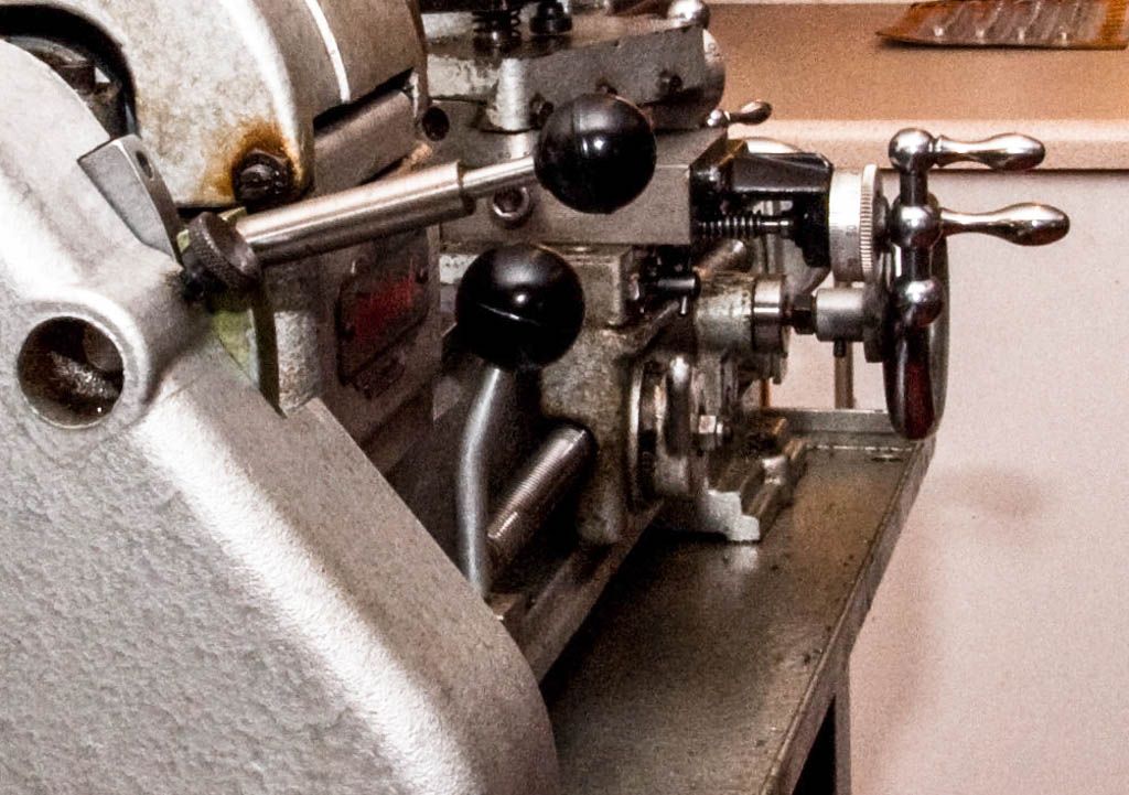

                        PS. You can  also see in the photo my "home made" version of the leadscrew clutch – another useful mod.
                        Edited By NJH on 21/08/2015 11:05:52

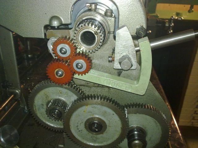

                              Didn't know about the Dave Goodwin one, but another was sold by mr. Dave Noble:
                              when I contacted him (2010), he hadn't any of them anymore and subsequent requests to buy some form of drawing got no replies.

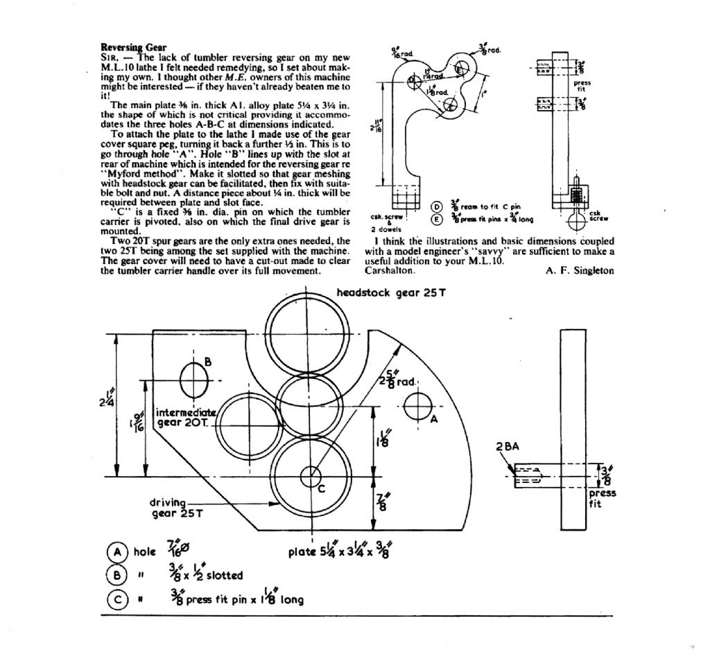

                              Another model of tumbler was described by mr R.G.Seiman on Model Engineer (19 october 1979) in the following interesting article::
                              I found these pics on the web some time ago, so I can't give credits to the people who uploaded them..
                              After seeing the model shown in Robbo's post, I think I have no more excuses and I have to decide which one I'll make.

                                Yes – quite right Dave NOBLE it was – my excuse is advanced years and knowing a Dave Goodwin in the dim and distant past !
                                It was a useful mod – especially as it was possible to select the mid position and remove the drive to the lead screw. That done it was much quieter and, by disconnecting the lead screw by means of the lead screw clutch, a fine hand feed to the carriage could be made by means of the leadscrew hand wheel.
