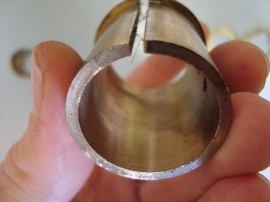

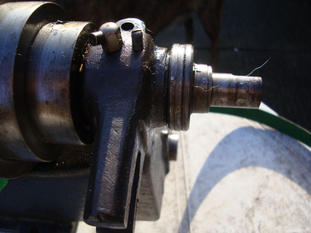

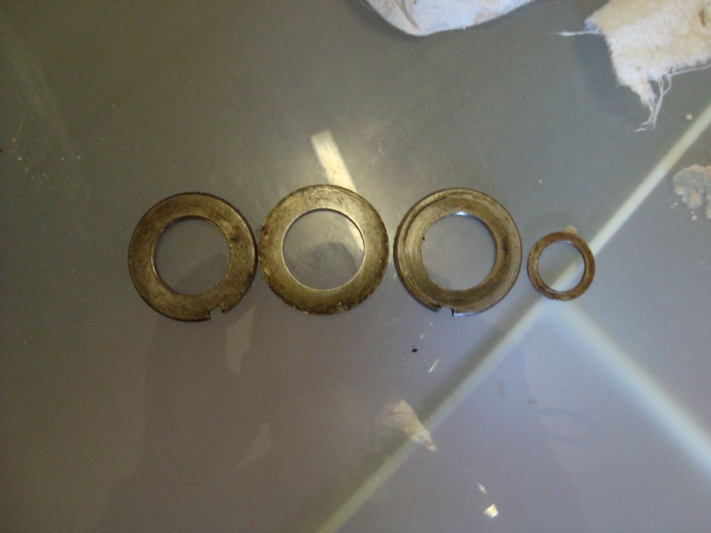

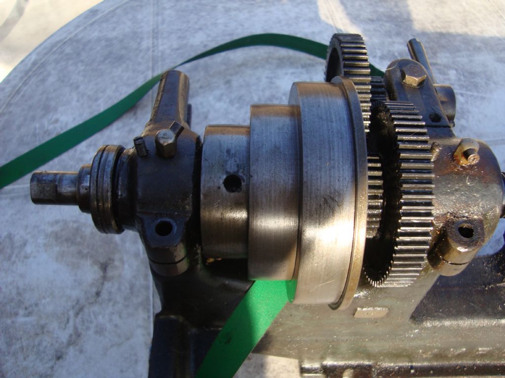

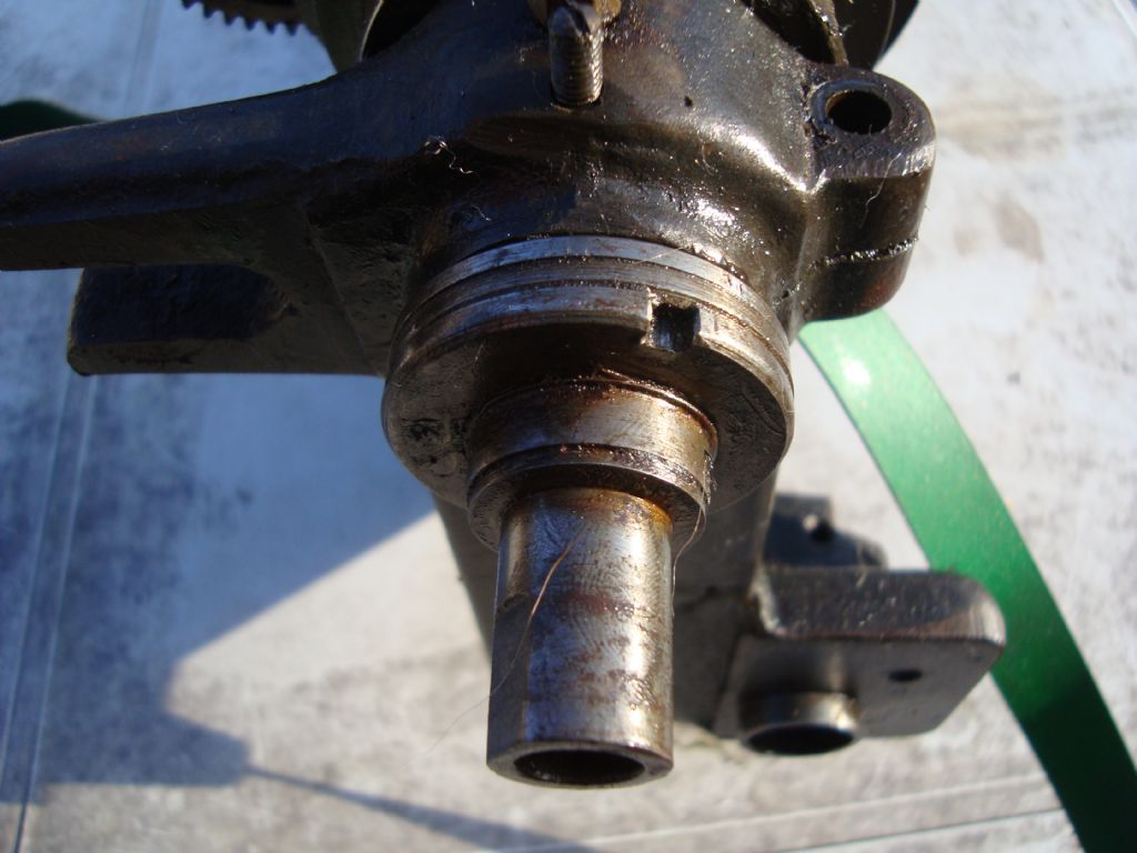

          Couple pictures guys, I have got as far as removing spindle collar and gear, bull wheel/pulley locking nut im stumped on the thrust collar though.

            Don’t know about rear collars on ML1s but it’s probably on a fine thread, around 18tpi, so it can be adjusted, and is locked in place with another collar nut or a grubscrew.
            On the Drummond M series you have to knock on the rear spindle bit to push the spindle out the front of the housing.
            The spindle taper increases from the back to the front
            The bull gear (big front cog) is locked to the spindle with a key, may take a few whacks to separate them.
            The pulley arrangement should spin freely and be completely separate from the spindle, if it doesn’t then something needs to be unscrewed.
            If they exist, watch for bits like rear thrust bearing stuff which is located on the inner side of the rear bearing housing and conveniently drops out sometimes shedding its ball bearings around your feet as you withdraw the spindle using both your hands to carefully hang on to all the bits.(sigh)

              It looks like a spring clip in front of the castelated adjuster nut, so remove that, undo the nut and, exactly as Ady says, watch for tiny ball bearings dropping out of the thrust washers if they have them. Put a towel down underneath the headstock, and if you are doing it all on a bench, lay newspaper down under it all so you can see any bits that drop out!
              Search for and undo grubscrew/s set into the pulley (you can see one in your photo) and undo the bullwheel to pulley locking arrangement (I don’t know how yours works but it is a bit unusual in that the drive gear is next to the bullwheel). Search for any other locking mechanisms; oilers are often used to lock bearings in place, so remove anything that mounts in the vicinity just to be sure.
              You will have to knock the mandrel out through the nose end but make sure you use a rubber or nylon hammer!!!! And set a piece of soft pine against the end of the mandrel and hit that so you don’t damage it in any way. Damage to the mandrel is terminal!
              M types are completely different as they were designed by Drummond, but the principle is the same for all lathes.

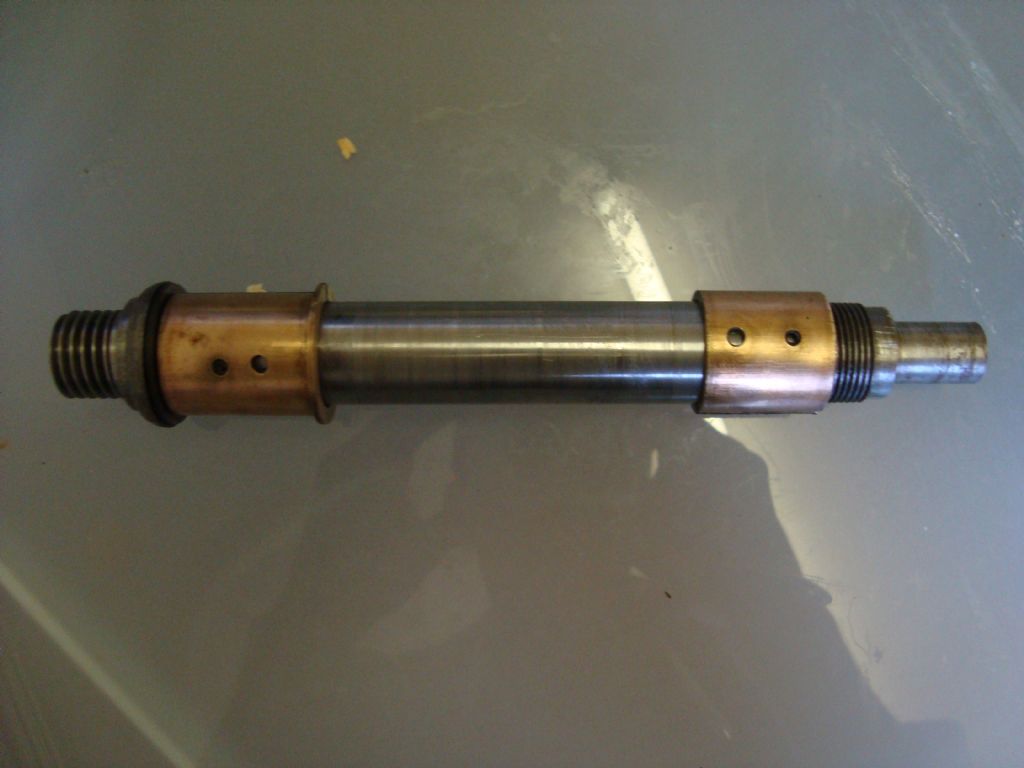

                    Cheers for the info guys, needed the confidence boost it came out like a dream, with lots of ball bearings . The bushes are a little worn but its something I will have to accept. It is the only machine I have I would just like to learn. My readings came directly off the spindle back and front. The work coming out is acceptable just looking for smoother running really. One thing I will add is the lack of any shims/spindle adjustment its is a most basic of machine. Anyways off to get some paint and primer.

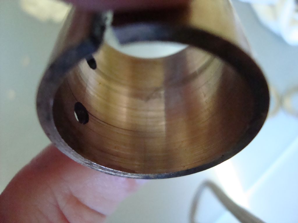

                        yeah just one, into the spindle like the pulley. the bushings pictured are the wrong way round its my fault. Would it be hard to find a new pair, I would like to get it up and running again it came with a pile of the original bits to.

                          Your bearings are the very simplest type, and if you get infected with the bug like many of us in here you’ll be perfectly capable of making your own after a few months.
                          Keep an eye on fleabay a couple of times a week to see what ML1 stuff comes up as you progress, don’t spend too much cash, lol
                          Be mega-careful with those bearing cap adjusters, many have been overtightened with disastrous consequences.

                            I’ll echo Ady’s warning, if you overtigthen the bearings trying to close them up you cold crack the casting. Some people put shims in the gap to stop overtightening.

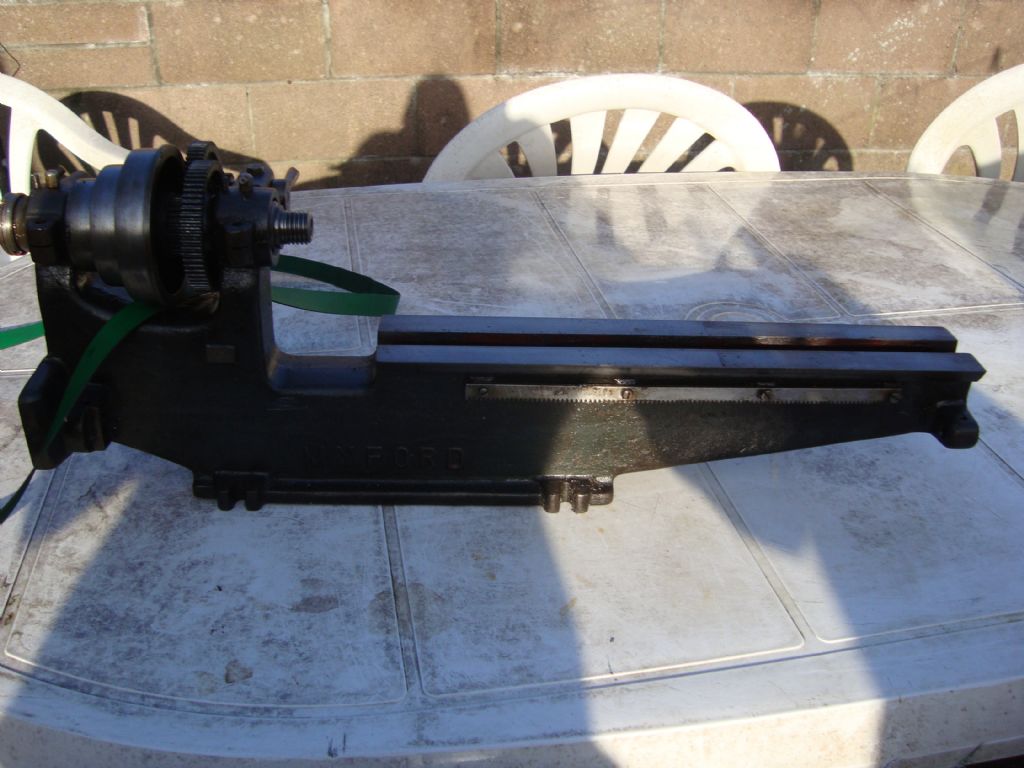

                              Appreciate the advice guys. managed to get all parts primed ready for painting just going to put it back together and make some swarf. Deffo going to buy a bigger machine I’v just moved into a new house from a flat Which is why a bought such a small machine. its going a little slow, I’m spending quite a bit of my time building a new workshop

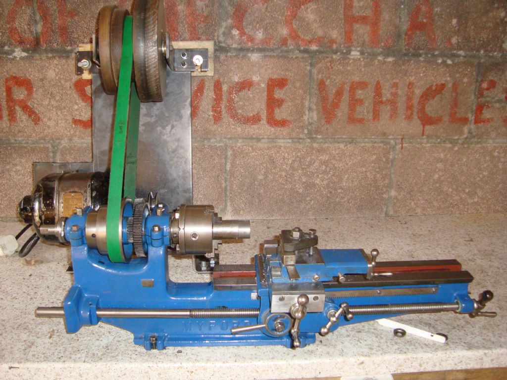

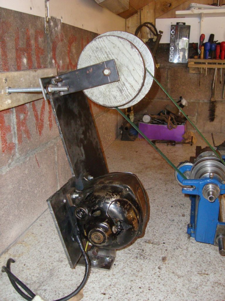

                                              Its been a while! manged to buld a workshop and counter shaft. I'm almost there with the myford, tailstock to re-assemble/paint, wait for my v belt and were making swarf. The re-furb has done wonders smoother movment and the DTI readings are promising I'll post a vid off my readings. Just wanted to say thanks for all the info. My first real lathe project and its gone smoothly so smiles all round really. One question I will add here though is with regard to gib strips and a plinth. What material is best? I know they are steel but what about brass or even some kind of plastic (delrin/PTFE?) for smoother operation? As can be seen from the pictures I have mounted straight onto my bench. I know the cavity will fill with chips and be a little fidly to clean but do I really need a plinth?
                                              Cheers.
                                              David.
                                              DavidMyford finishedMyford finished 2
                                              Edited By woody1 on 11/06/2012 18:04:49
