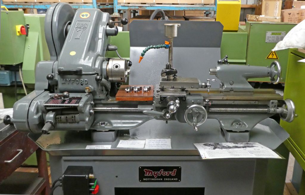

      I stumbled onto this picture of an S7 fitted with what appears to be a gravity-feed cutting fluid delivery system? That looks like a drip-oiler cup fixed to a partly-hollow post mounted on the cross-slide?
      Just wondering if any of you have experimented with similar? And might share pictures?
      Cheers, Colin

        John Haine
          @johnhaine32865
          Interesting idea, looks like it would soon run out.

          Brian Sweeting 2
            @briansweeting2
            Not a new idea but a good drip oiler.
            See Emmas' igram picture here ..
            **LINK**

            Robbo
              @robbo
              Colin
              Int 'tholden days it was common to have a shelf behind and above the lathe. Put a gallon (4.5 litre) can with a flexible tube and nozzle on the end from can to lathe. Simple tap on nozzle (eg motorbike fuel tap) and let it drip away.
              A bucket under the swarf tray outlet collected the run-off coolant which was returned to the can.

              the artfull-codger
                @theartfull-codger
                I've had a 1 gal plastic tank on a shelf above my lathe for years & the usual pipe down to the tool with a valve, it provides all the coolant you need, I collect the coolant in the tray outlet & filter it then back in the "header tank",I wouldn't bother with all the fancy (& sometimes expensive) ideas for a pumped system,I don't bother with the myford, just use a brush & oilcan but only on the student, which does 90% of my turning.
