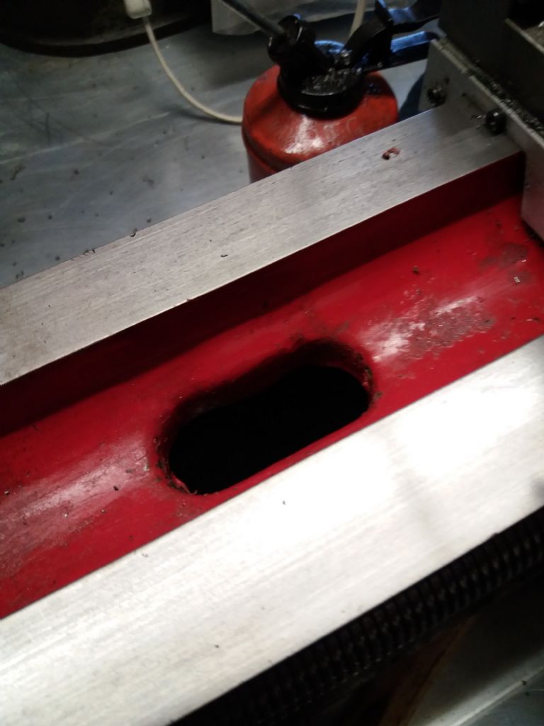

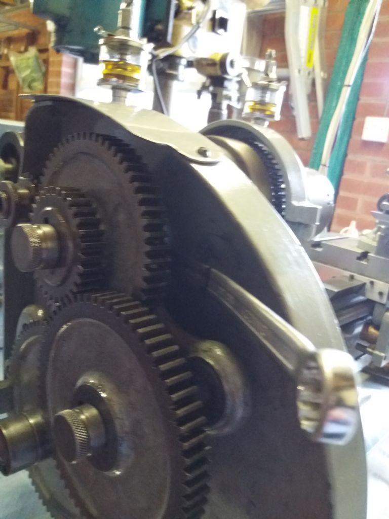

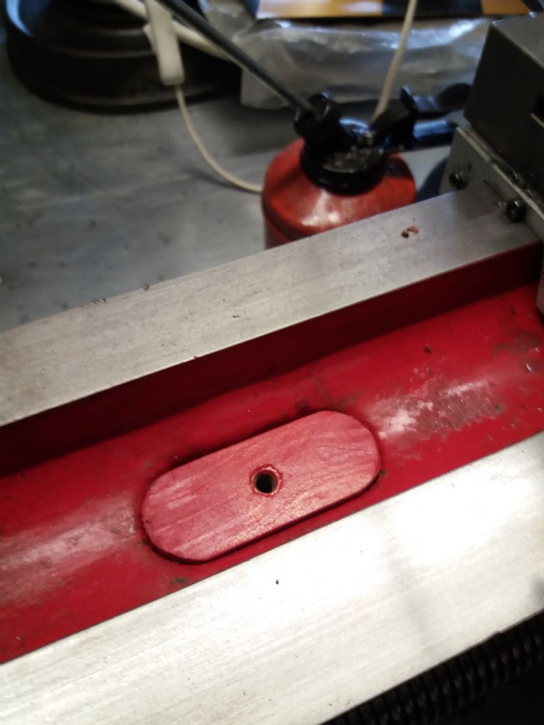

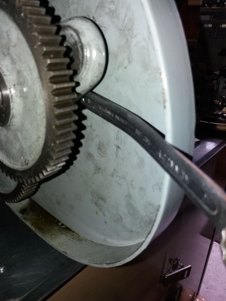

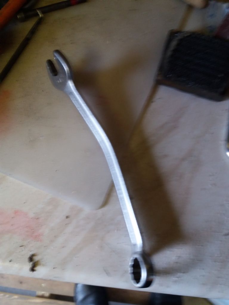

        I have been fiddling with my lathe to sort out a few niggles. The first was, if I drop anything down the first cast hole in the bed I have to go fishing with a torch, magnet on a stick or long tweezers as there is no bottom access so I made a cover plate from wood with a metal insert so it can be removed. The second was to make a bent spanner so I can change the gear ratio or screw cutting easier. the third was to actually measure the spindle speeds in all settings of pulley and back gear settings so I know all of them print a chart and laminate it. Here are a few pictures and the chart. Hope this is useful to someone.

          Thanks for posting the info. I was scratching my head about the bent spanner until I saw the picture — I've never had a guard on mine! I like the plug for than !@#$%^& hole in the bed that small jobs always disappear down after parting off. Must make one for my M type.

                Agree about the wretched holes in the bed ….. I must get some of those wee plugs made up.

                    Strip of gaffer tape is the quick and easy solution to the hole in the bed, unless you're throwing large bits of metal about.

                          Posted by Ian Roberts on 19/05/2017 09:43:41:
                          I melted holes in the vinyl aprons I put fore and aft of the carriage with hot swarf and had to go back to metal trarys, so reckon I will go with the metal/wood bung.

                            Yes I've been there as well, good ideas, got the bent spanner and also some years ago made a cover for the bottomless abyss.
                            Unfortunately as I was fitting it in place it fell down the hole, not seen it since!!! ……must make another.
