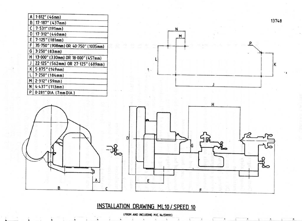

                              Not important I know but looks like we were both wrong. Myford information says 3 5/16" centre height.
                              Phil H
                              #294285
                              Robbo
                                @robbo
                                David, Phil H,
                                I don't want to start a pedantry competition, but the drawing in my ML10 manual shows 3.25" This is a 2010 issue.
                                See lathe number at bottom of page – maybe earlier ones were different. Excuse it being a bit askew.

                                  I wont bother to scan the information but mine was bought in about 1982ish. Perhaps they changed later on. My information definitely says 3 5/16".
                                  wink Perhaps the earlier ones were all rusty (like the ML7) and they all had to be remachined??
                                  #294293
                                  Clive Hartland
                                    @clivehartland94829
                                    3.25" in a 1978 ML10
