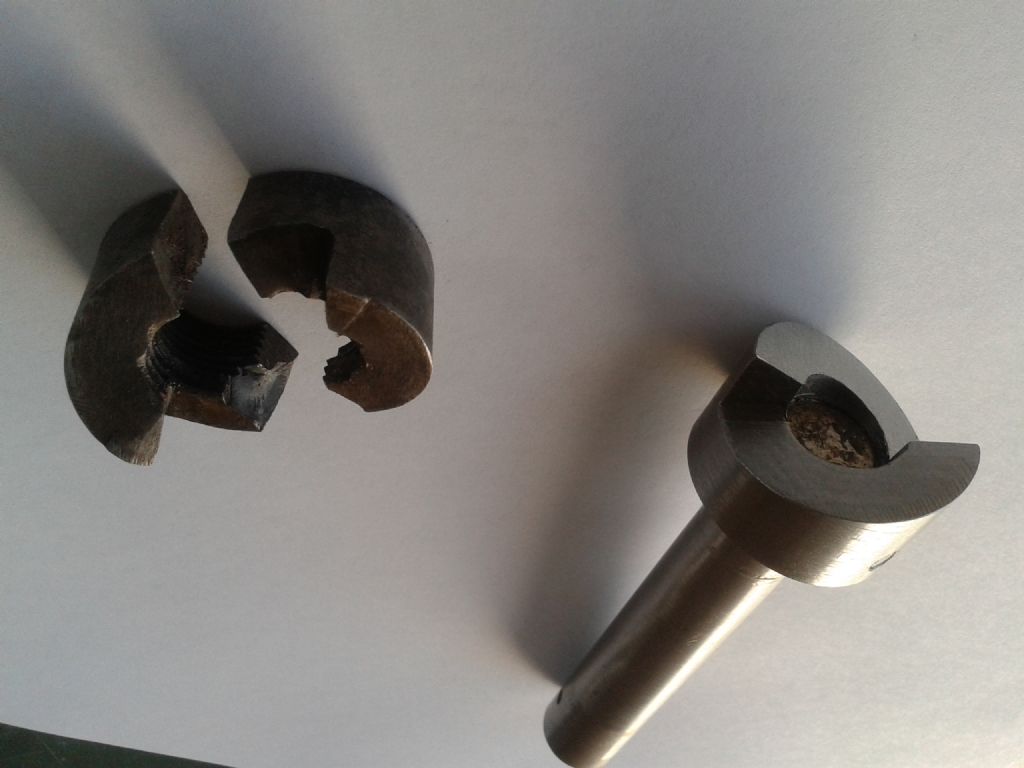

      First off, I shaped the two teeth by sawing out opposing segments at the prescribed angle across half the shaft diameter then finessing with a file. But I found the bite on the crankshaft was tenuous and intermittent and certainly not nearly sufficient to 'swing' the engine – or even pull it briskly over for starting.

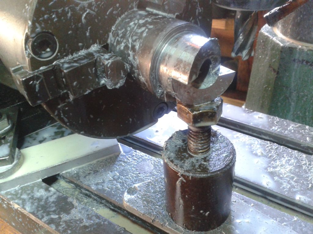

      Since then, I've set-up the shaft at 20° in a swivelling vice on a milling machine
      and cleaned up and sharpened both teeth with an end mill. It has definitely improved the situation and the handle will pull the engine over part way (possibly until it encounters a compression!). Yet, there's no way the starting handle would bite sufficiently to start the engine.

              One suspects the crank end may be damaged.
              If you get the ramp too shallow it wont engage far enough, if the ramp it too steep it wont matter.
              If the crank end is eaten away you get the same effect.

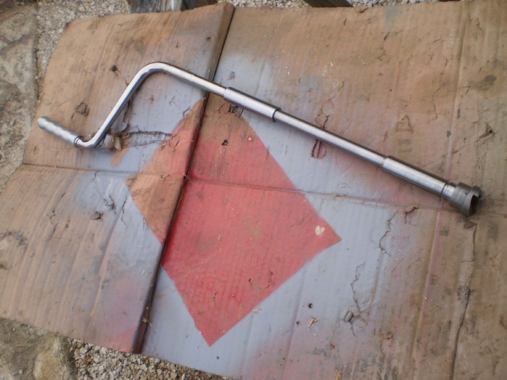

              #535087
              Speedy Builder5
                @speedybuilder5
                This worked for me.

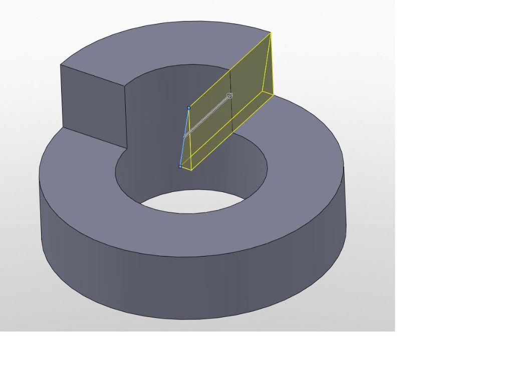

                      Cant see you'd need a spiral to make one like in Speedy Builder's picture. Appears a flat plane he has cut rather than a spiral. That should do the job. It is only clearance for when the motor starts, and does not affect the "grip" of the dog's driving face.
                      What is critical is the flat driving face of the dog. When making similar ratchet drive mechanisms for old motorbike kickstarter drives, we undercut that face on both halves by a few degrees, maybe two or three. This ensure positive engagement and is pretty standard on drive dogs in motorcycle gearboxes that use the same principle for main power transmission.
                      Two flat faces bearing squarely together can tend to half engage and then slip out of mesh, Two slightly undercut faces will tend to slide into full engagement under pressure and motion. Highly critical when your entire body weight is perched on the kickstarter lever and your knee will turn inside out if the drive ratchet lets go mid kick. Guys have ended up in hospital from it with what the doctors call hyper-extended knee. Usually on older model Harley Sportsters which are notorious for it.
                      If you have already machined your part, and have the matching part on the end of the crankshaft already, some careful work with a thin disc in a Dremel can put the slight undercut on each surface. A check with bearing blue to make sure both faces on both pieces are engaging evenly will make an even better job.
                      The pic shows the principle where the driving face is cut a few degrees past square so it kind of "hooks in" under drive load, yet lets go when the engine starts, or when you pull the clutch in to shift gear on a transmission gear.. Google "gear dog undercutting" for more info.
