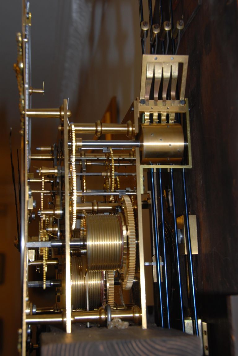

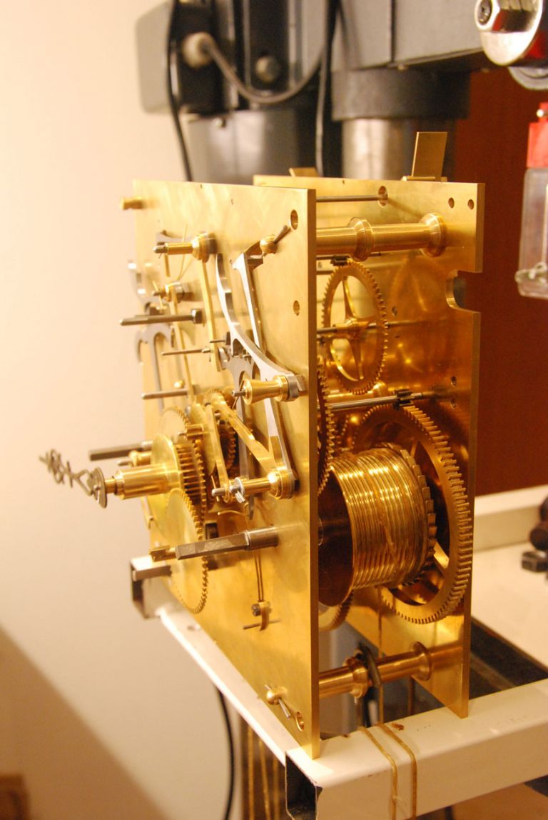

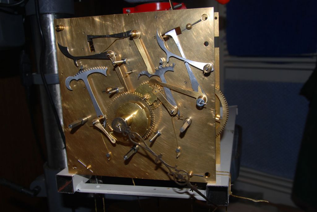

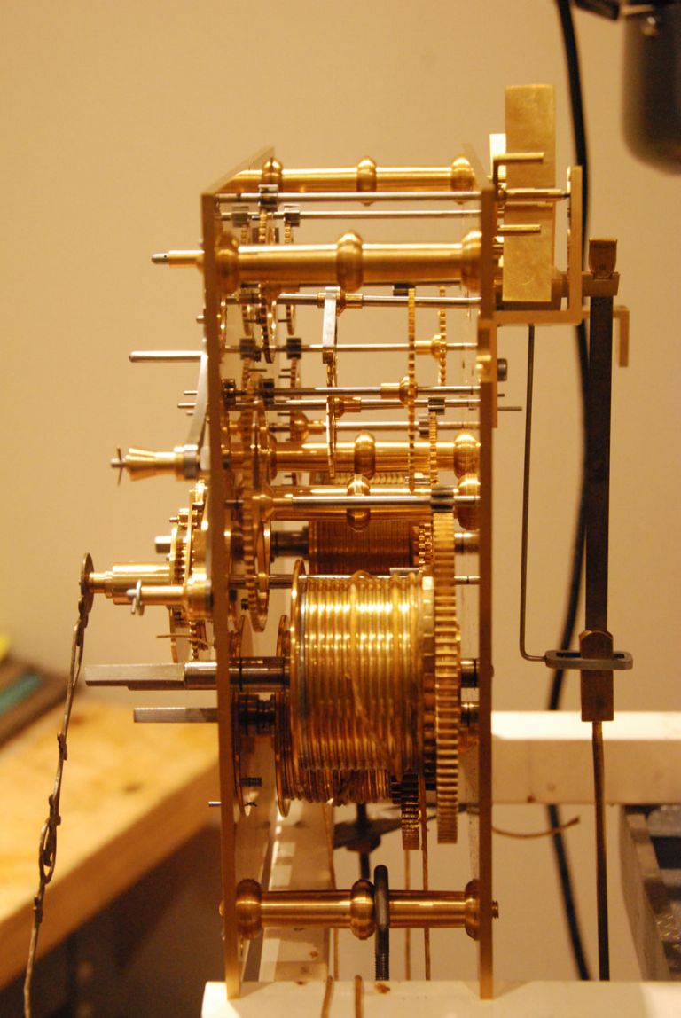

        Hi,
        Just over a year ago I asked on the forum about tuning bells for a musical longcase clock. Well I thought I would share my endeavours so far !
        The clock mechanism is based on a 18th / 19th century longcase design but with an added train on the right hand side to play Westminster chimes on the quarter. I decided on a spiral bar gong for the strike and bar gongs for quarter chimes as the cost of tuned bells was prohibitive.

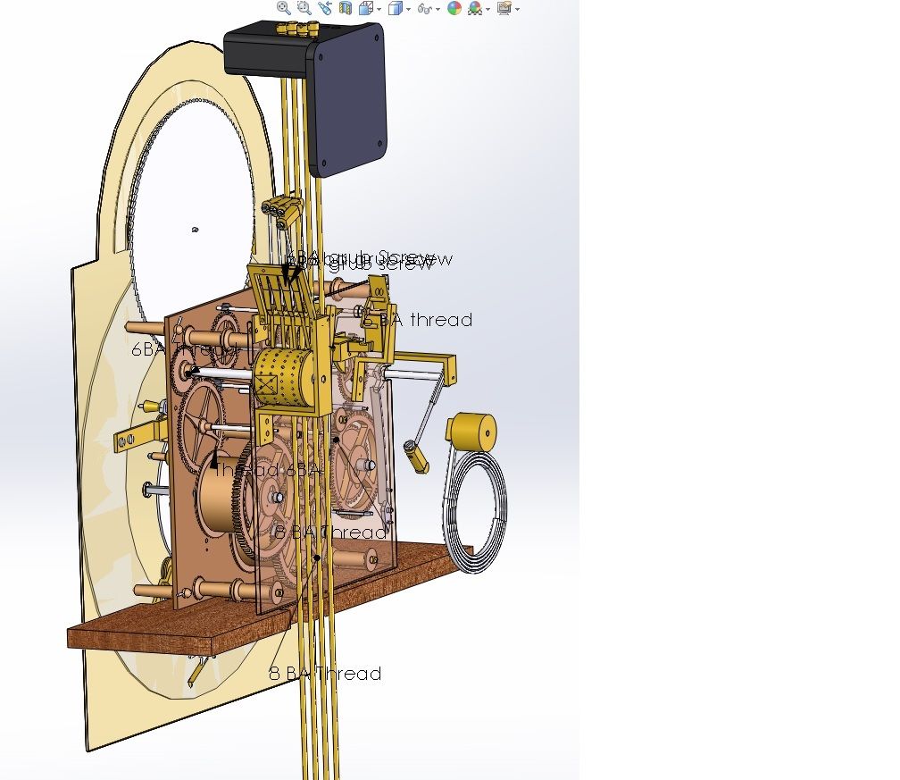

        I have also opted to use a deadbeat escapement. Ive used old clock books for my reference and modelled everything in solidworks prior to any machining taking place. The clock is now up and running on my impromptu test rig and I've just finished getting all the motion work set up. My next challenge is to make the strike musical mechanisms.
        More Photo`s in my album
        Edited By GLENN BUNT on 22/04/2013 19:13:34

                    The great wheel holes were marked out and drilled with the plates pinned together after that all the other pinion holes were marked out using a depthing tool.
                    I'll post some more photo's when I'm further along with the build.

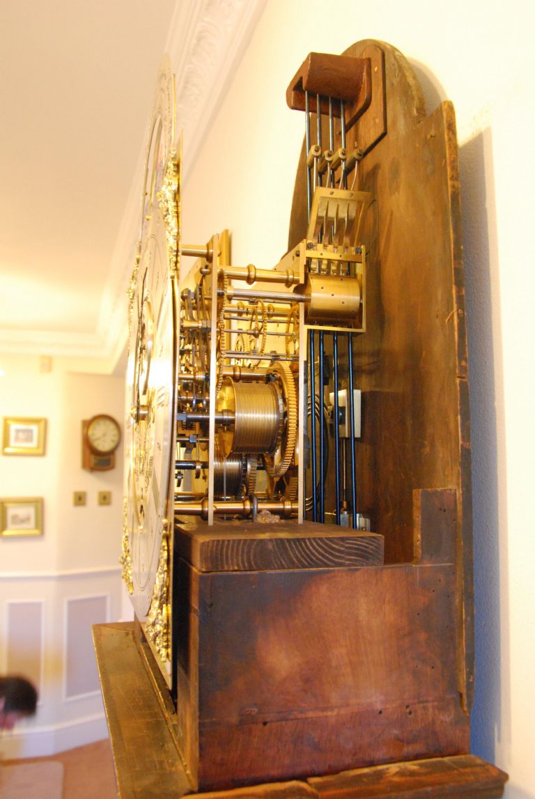

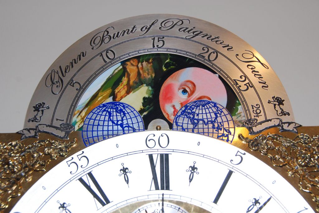

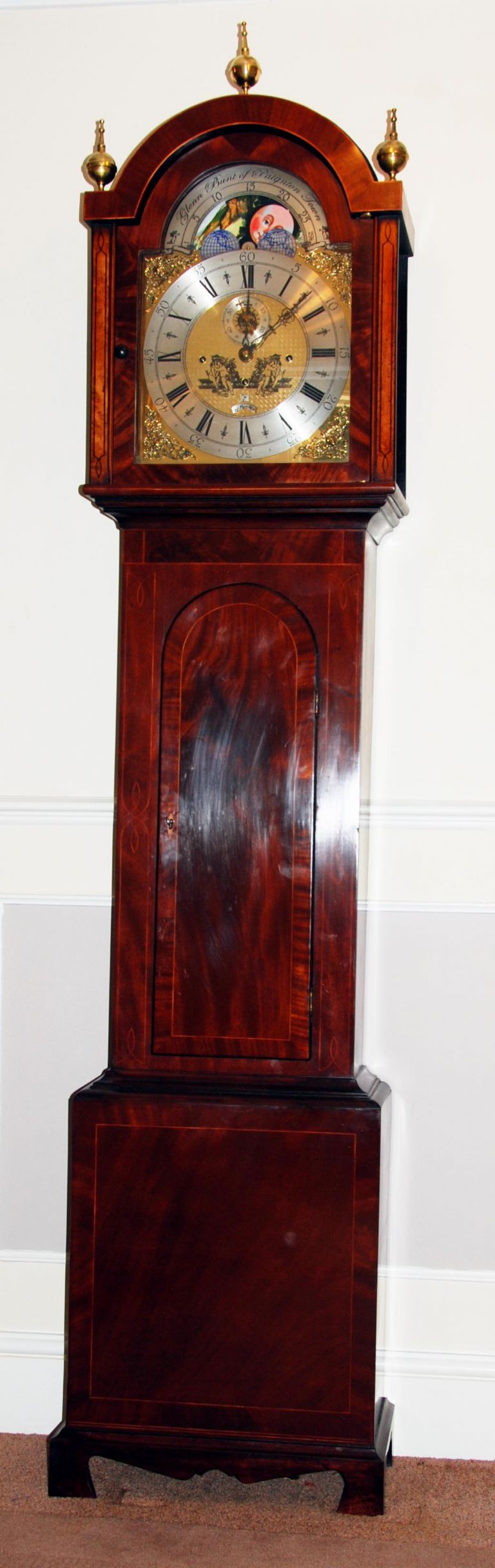

                      Well its been nearly two years since started designing and making a Musical Longcase Clock, I'm delighted to report back it's finally completed and keeping magnificent time. For those interested I've posted some photo's.
                      In my previous post I described how I had the clock running on a test stand and the next challenge was to be getting the strike, Westminster chime motion working and the pin barrel complete. This took longer than I anticipated (like most projects as we all know) and then there was the engraving ……..

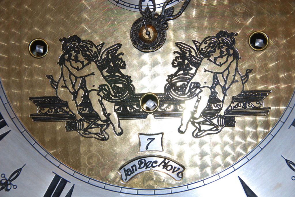

                      As you can see I've gone for all the Horology toys I.E. moonphase, date wheel, seconds ring and month wheel all engraved by my CNC router and grained / silvered by myself, the centre was also engine turned / spotted.
                      The case was restored from a wreck purchased from ebay – only later to be damaged by one of our cats – the hood has had more touch downs than a soccer ball!
                      I'm going to have a break over xmas and then put pen to paper and write an article about my endeavours.
                      More photo`s in my album
