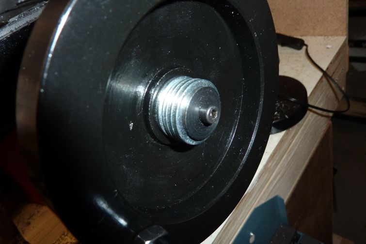

                                      #141317
                                      GaryM
                                        @garym
                                        Bill,
                                        As this is the only milling machine I've ever used, I'm not sure my observations count for much but here goes. I bought the long table version which Arc have since stopped supplying (not sure why) but the rest of the machine is the same as the SX3. I find the extra space on the table useful as I can leave the vice bolted to one half of the table and have the other half free for clamping work direct. So far, I can't find anything to complain about and I think this mill should be capable of doing any work I'm likely to ask of it. When I first got interested in model engineering I bought a mini-lathe and am now wishing I'd gone for something bigger (upgrade looms). The only minor thing I've done to the mill is to add four M12 washers to the X-axis feed handle to keep the dog clutch permanently engaged (see below). I think a DRO system might be on the horizon. A borrowed engine crane was handy for lifting it onto the bench.
                                        Gary

                                        #141381
                                        Bill Dawes
                                          @billdawes
                                          Thanks for that Gary, just out of interest do you know why the dog clutch? I assume it does not have a power feed to the table, or does it?
                                          Regards
                                          Bill
                                          #141392
                                          GaryM
                                            @garym
                                            Bill,
                                            One can be fitted to the other end of the table, but at £300 I don't think I'll be fitting one in a hurry. It kept disengaging while traversing quickly.
                                            Gary
