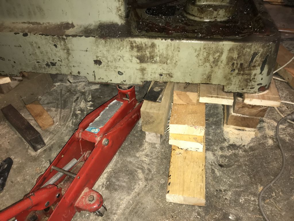

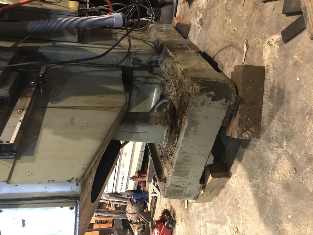

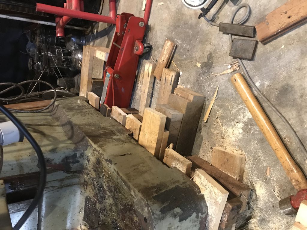

          Made some good progress.
          Decided to try and do it with what I had on hand first.
          Trimmed all the excess off the pallet, managed to get a small trolley jack under to lift and block mill so I could cut up the pallet and get it out.
          Ended up with pallet on blocks under each corner.
          I can’t lower it more with trolley jack, but someone is lending my an 8 ton toe jack which should get it to ground level.

              If you lift the machine off the blocks, and can lower it onto a couple of (you need three actually ) short lengths of scaffold pole, you can use the rollers to move the machine to where it needs to be..
              Once situated, lift, remove the first roller, lower and then lift the other end and remove that roller.

                It wasn’t actually as hard as I thought it would be. Using a long bar I managed to to pry the cross planks off the central beam enough to cut the nails with some side cutters, then slide cross planks out.
                I used a “multi tool” to cut up the beam – luckily it was made from some type of soft pine.
                I was a bit nervous at first sticking my hand/arm under the mill, but had plenty of hardwood blocks under it.
