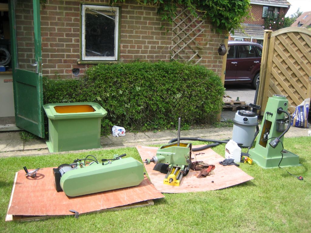

                    I concurr with Ian above. Stripping the machine allows it to be shifted on your own, a pair of you and you can leave some of the lumps togather. I've moved mine twice and am just about to do it again along with another identical machine.
                    Couple of points. The head will lift complete with motor as a two man job, I have done it on my own but I would not recommend it (you have to get it on your shoulder and I was 10 years younger then). Much easier to drop the motor off. As has been said table, sadde and knee disassemble.
                    There is a neat trick to get the column off the base without lifting it bodily. If you consider the column as an L, put a wooden pad on the floor in front of the base and rotate the column forwards around the front of the L. The top will end up resting on the pad. A quick rotate and you can lay it down again on the front foot and stand it upright again. Reverse the process to get it back on. For reassembly it is convenient to drop the column onto 4 wooden spacers first leaving a gap between it and the base. This makes it easier to jiggle things around to line up the fixing holes, drop the bolts in and rock the column to slip the packing out. I've never used cranes or hoists on a VMC but take advantage of what you have available.

                      3509743c-acc5-4e3d-9016-34f93e1e5c69.jpegMy Warco VMC broke down into these bite size pieces was assembled by myself and one of my sons, heavy enough to make sure you lift properly but not a problem for two reasonably strong adult males.
                      Mike

                                        If you go the dismantling route then it’s best to undo the screws holding the nut for the vertical feedscrew as winding the screw out of the nut could damage the thread, I removed the tapered gib for the knee to make it easier to lift off the dovetail, be careful not to strain or damage the dovetails. I removed the table handles to avoid damaging them. Removing the motor would be a worthwhile weight saving as the complete head assembly is quite heavy and a bit awkward to lift to chest or shoulder height. I have done this twice now and didn’t have any damage to machine or people. While it is in one piece it is rather top heavy so if it tips too far you will not save it. Planning should help to ensure things go smoothly but also consider what could happen if things go wrong, fingers and feet are very vulnerable but you don’t want to be pinned against a wall by a milling machine.
                                        Mike

                                                      Got it home late last night. Base: I stood inside it and held it by diagonal corners and walked it to my shed. heavy but managed not too bad. Head: motor already off, lifted it and just managed to carry it to my shed. Quite heavy!
                                                      Column with knee and table still attached. I didn't want to split the knee off but OMG this lot IS heavy. I had bolted it to a 120cm by 80cm pallet using lengths of M8 stainless studding and washers. The Vauxhall van I hired from Arnold had perfect tie down loops over the back axle so nothing moved even through the first 10 miles or winding farm roads.
                                                      8pm and dark. My mate from next door came over to help. The pallet slid with great difficulty to the back door of the van. I had 6 offcuts of decking that I had just used to refloor my new shed. Made a ramp with these lying on the van rear bumper. With much grunting and cursing we slid the pallet down the ramp then onto cardboard sheets. Then used brute force and planks as levers to slide the pallet into the front of the garage. Sprayed all metal bits with WD then locked up and crashed out.
