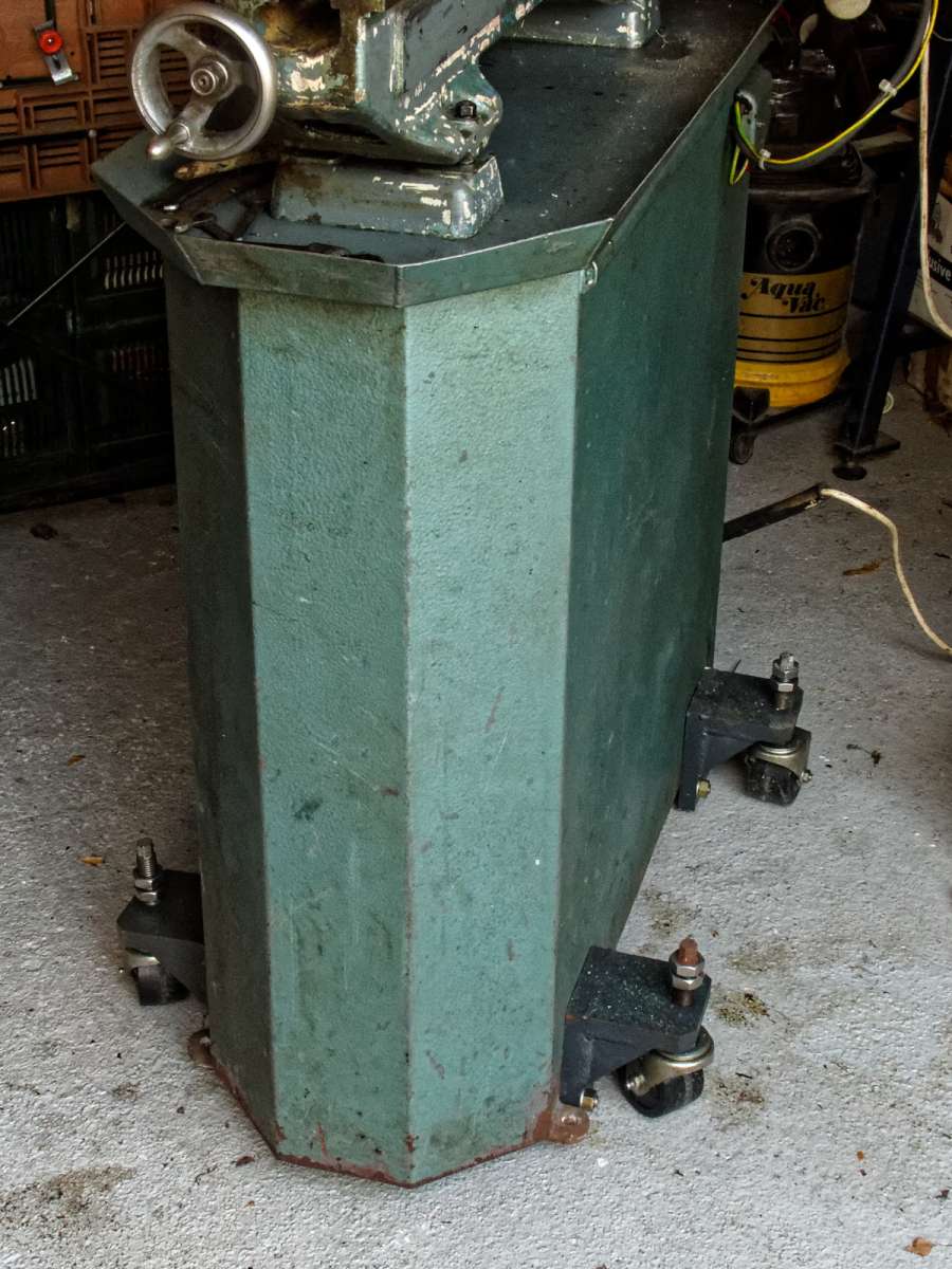

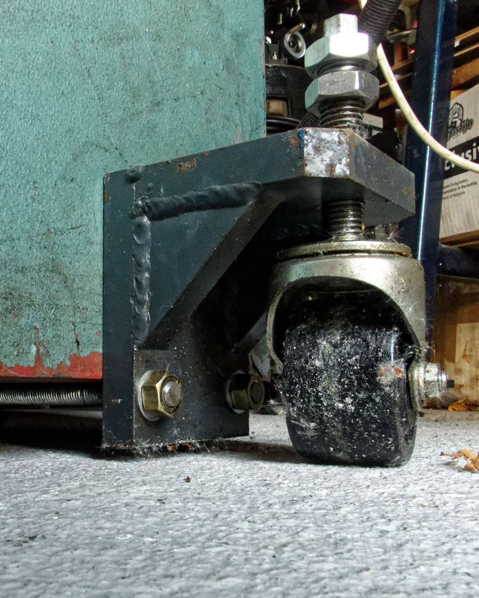

                          peak4
                            @peak4
                            The request is how to move machines around which weigh about 150Kg+
                            To put it in perspective, a Myford Super 7 on cabinet is about 165Kg
                            One of mine is still on wheels, as I’ve not got around to finalising the garage layout.
                            Note that the castors shown here are outside the footprint of the cabinet, whichever way they point.
                            The lathe setup is actually more stable than just sitting the cabinet on the floor, before bolting it down.
                            The angle plates are held together with long lengths of threaded rod, so can easily be moved between machines, though I do have another set on my Boxford shaper.
                            A little common sense is required when moving a longer distance, such as wheeling the lathe lengthwise, and push slowly don’t run etc.
                            No I didn’t paint it that colour myself.
                            PA280462_DxO-small
                            PA280465_DxO-small
                            The wheels & brackets originally came off comms cabinets, which were pretty heavy when loaded, probably north of 500Kg, a lot taller than me and narrow, as they were for 19″ practice, though quite deep.
                            Bill

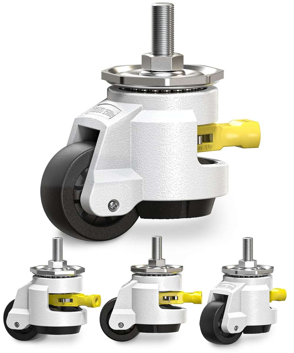

                            aytact
                              @aytact
                              Thank you so much for all responses, I think Bill’s approach is best.
                              For the other responses:
                              – Unfortunately, this place is not a shed. It is 180m2 warehouse, but we have lots of different equipment to operate in multiple different sectors. And unfortunately, we do not want to rent another warehouse in short period due to trying to keep costs at manageable level.
                              – We have 2 tonne engine crane and pallet truck, but sometimes space getting so full and there is not enough manoeuvre area. Generally happening when we purchase raw material on pallets.
                              – For now, I have purchased below item to try on 20T hydraulic press.
                              71aePGzFxEL._SL1500_

                                  Hi peak4, glad to see that you have the whole of the wheels outside the footprint, no matter which way they are pointing.
                                  Regards Nick.
