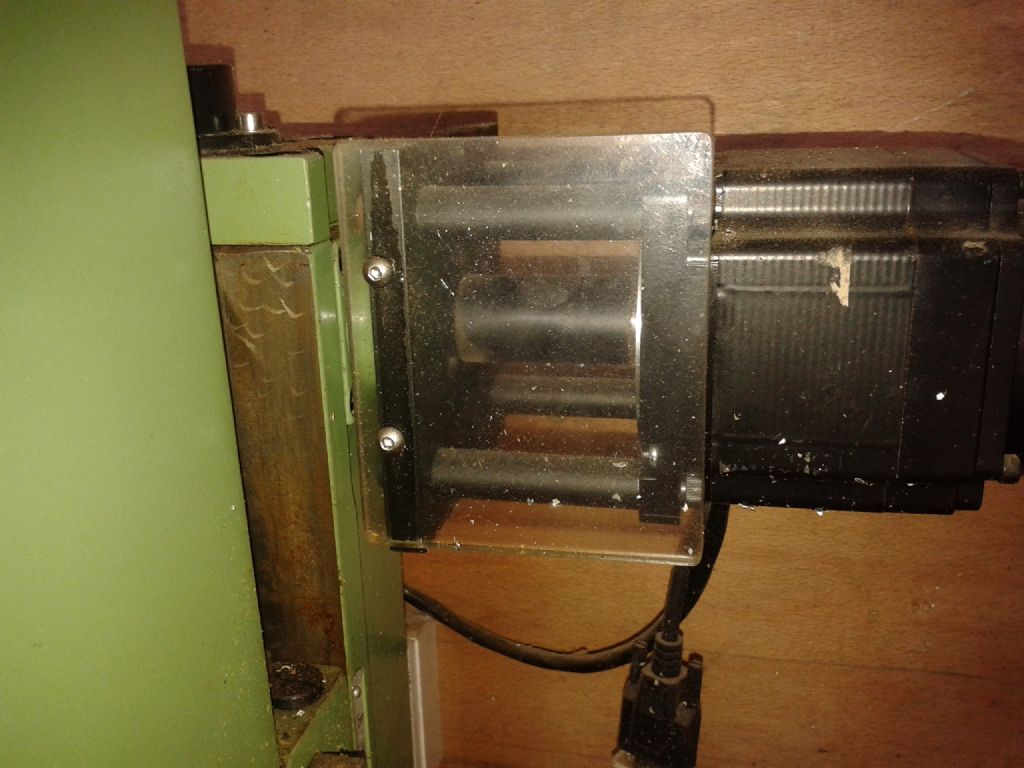

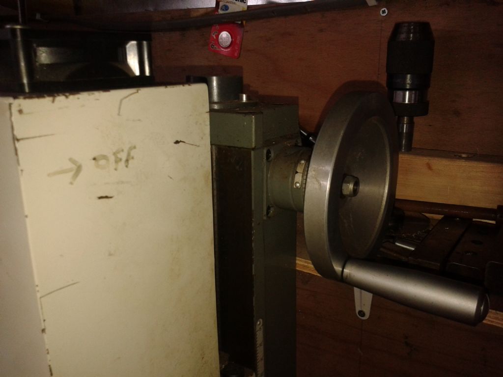

                    20170820_111955.jpgHi dave
                    I have a warco vm16 converted to cnc (not done by me) that is the same as the champion I have the vm20 manual mill if you look at the photos you can see they have a stepper motor fitted directly to the shaft were the handle was fitted
                    I am sure you could fit a motor of some sort to power the z up and down and use the fine feed by hand to give you the final adjustment
                    II no nothing about electronics but am sure someone on this forum will help with the control

                        Geoff, many thanks for the photo of your conversion, your mill does look identical to mine, the stepper motor looks very sturdily mounted and could be a way forward.
