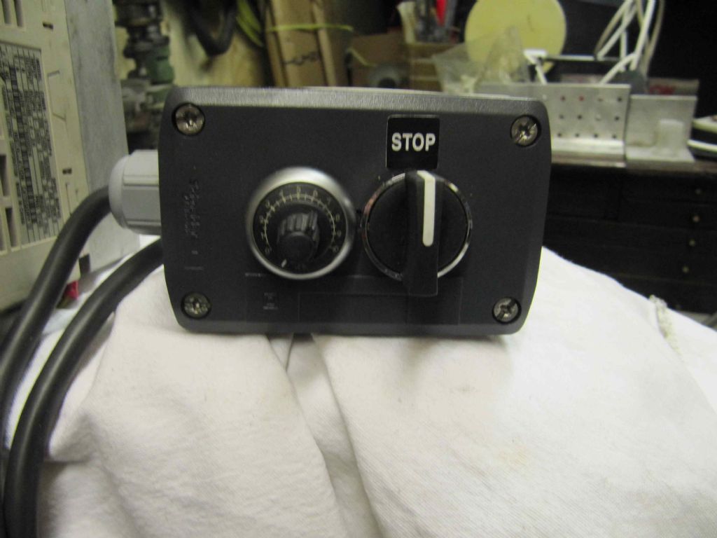

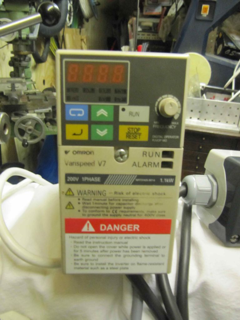

                        Returns quickly , highly embarrassed!!blush Should have checked that the Newman would fit … it doesn't! It would require a great deal of modification to do so. Soooooo .. Plan B. Also lurking in the shed is a brand new 3 phase 1/2 HP motor plus the bits and pieces in the photo's. Not having ventured into this sort of area before, is it a reasonably straightforward operation or should I get a wiggly amp guru to do it for me? It appears to be pretty obvious but are there hidden snags and what are the pros and cons?
                        Again any help much appreciated
                        Rgds
                        Bill

                          Apologies for returning to this, but with no responses to my last, I've put the 3 phase to one side and 'invested' in a new C-P motor. I would still like at some time to go 3 phase but without a simple guide to connections, I foresee an outpouring of 'magic smoke'.
                          MEW 180 contained an article by Alan Hearsum with good info on the code inputs and indicating that he would include the motor wiring details in a subsequent article. Haven't seen anything since. The reluctance to go ahead with the 3 phase is compounded by the need to modify the drive pulley – different shaft sizes, so a further pulley required.
                          Google search shows that this has been done by forum members but none of the threads I've found contain the basics of wie connections to the motor. Would greatly appreciate 'A goes to B' type guidance if antbody could oblige.

                              Yes, I have that already. The problem is, as can be seen in photo's 1 and 4 the output from the Omron consists of FOUR wires into a 'chocolate strip' connector. My motor, in common with all the others I've seen has only THREE input connectors. While tracing the individual wires will indicate which is which, there is nothing that I can find in some three days of searching which shows how 4 into 3 should be connected. The Omron manual is very clear about the way to wire it to the supply but absolutely nothing for the downstream connections – presumably thought to be too obvious!! Well it isn't to me!sad Thr motor manual is similarly unhelpful. Is 3 phase technology really so complex that it can't be offered as connect wire a to terminal b – at least in this instance? Aaaaaargh! wiggly amps – I hate 'emangry

                                  Not quite sure how, but have found a source of appropriate info which covers what is needed – at least it does for me! The source is "Use of induction motors in the home workshop" by RC Minchin. (Free download from the Web) It presents the details in an understandable form and has provided all the answers I was after. I can recommend it to anyone in a similar situation (and similarly flummoxed!)

                                    Looking at your photos again one of the four wires is the earth wire,yellow and green,this is conected to the motor frame, the other 3 wires will be conected to the 3 motor terminals. I fitted a Imo inverter and 3 phase motor to my WMT300 lathe last year and I am very pleased with the results.There are some photos in my album. I must admit I thought it would be more difficult to do than it was. No magic smoke. Would not go back to single phase motor.Good Luck.
