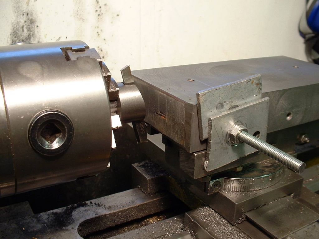

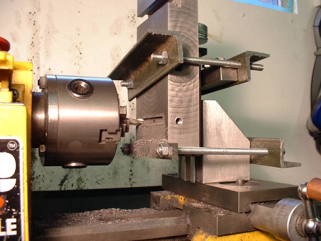

                            Posted by SillyOldDuffer on 08/10/2018 14:12:57:
                            Firstly, although milling on a mini-lathe is certainly possible, it's far from ideal. My experience was quite frustrating – the tool-post has to be unbolted and replaced by a milling vice. Then work has to be clamped on a smallish milling vice after which the length of cut is restricted by the distance the lathes saddle can move front to back. Also the rate at which metal can be removed is constrained by the lathes lack of rigidity.
                            I'll be interested in what others say. I'm no expert because I took the cowards way out!
                            The only limit on what you can mill on a mini-lathe is what you can fit on it:
                            Fly cutting…
                            fly cutting one end of the block, note the deep surface imperfection on the surface of the block.jpg
                            Roughing out T-slot:
                            Roughing out dovetail:
                            Setup for t-slots:
                            And the end result:
                            Any questions, Dave?

                                    Posted by Neil Wyatt on 08/10/2018 19:03:02:
                                    Fly cutting…
                                    Setup for t-slots:
                                    Yes, in this picture the dovetail block is clamped directly across the tool-post.
                                    My question is: why don't I think of tricks like that?
                                    The late great John Stevenson often suggested underperforming machinists should take up knitting. Now where did I leave my needles…
                                    sad
