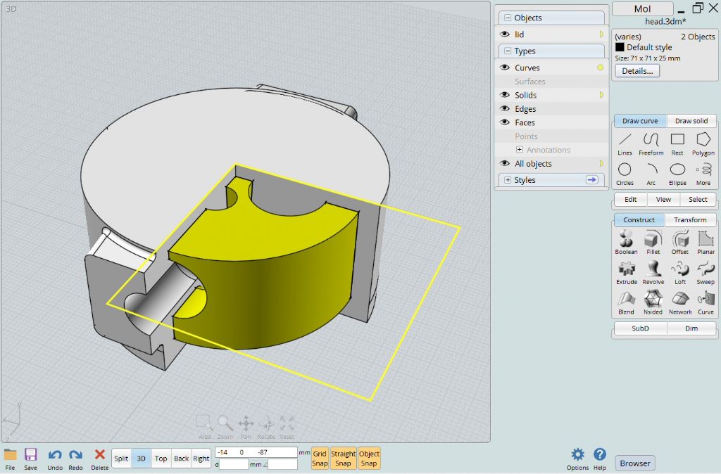

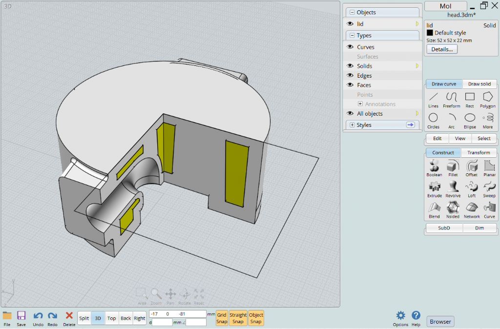

            lee webster
              @leewebster72680

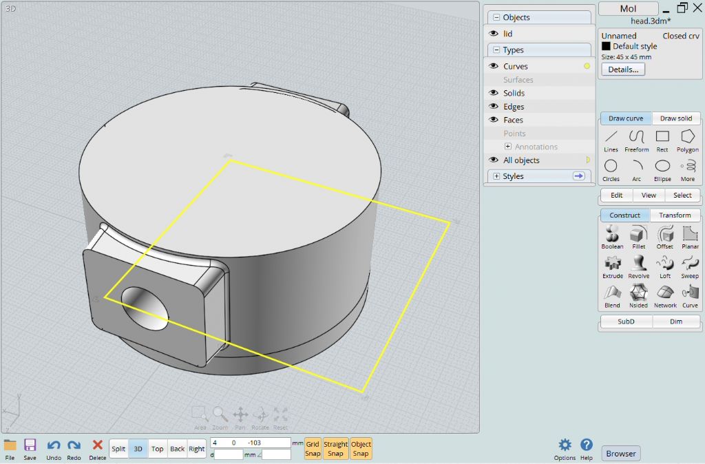

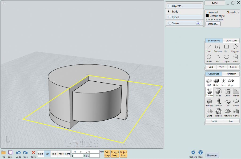

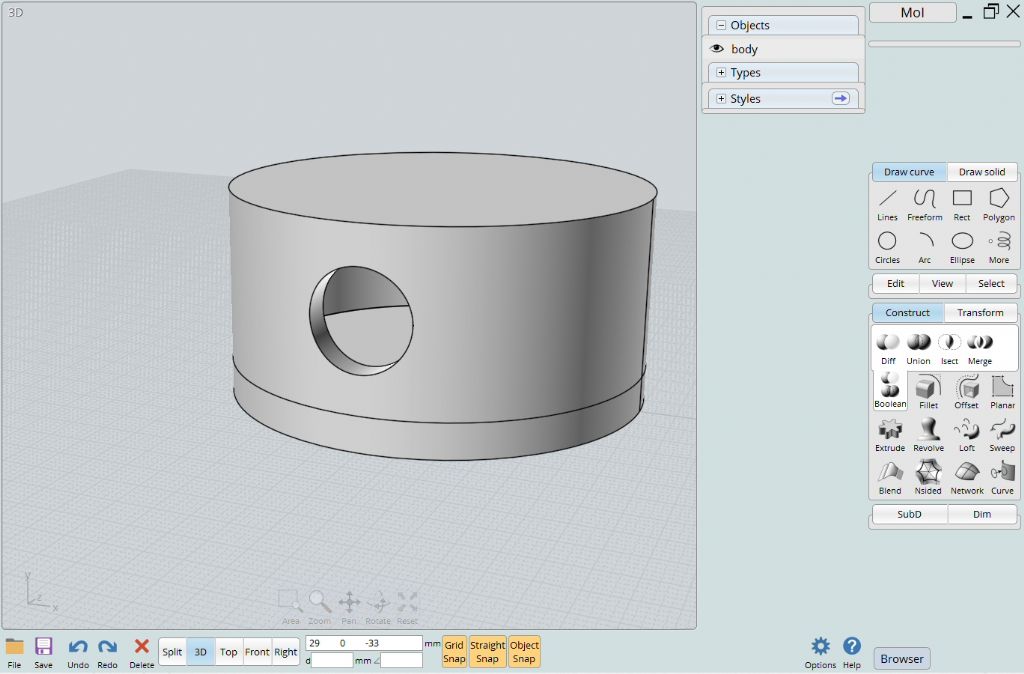

              I had another go at the head. This pic shows the head ready for capping off. The yellow parts are the tops of the spark plug and valve guides which are 3mm down from the top surface of the head. The head has a water jacket.
              This pic is the top filled and and joined to the head with a rectangle ready to boolean cut through the head.
              The water jacket has been filled in. I selected it and pressed delete.
              This pic shows that the rest of the water jacket is left in place. It too could be deleted to leave the head with a water jacket.4.jpg
              I then tried an experiment to see if it was the boolean cut creating the filled water jacket. I created a head that had no plug or inlet/exhaust tracts, cut a hole in the side, and filled in the top.
              It looks as though there is no bottom to the head, there is, it's just the angle. But the point is, it proves that the water jacket isn't filled in by sealing the top. I pressed ctrl z until the hole was gone, filled in the top and cut through.
              The water jacket has been filled in again. The water jacket solid could be cut from the head to leave a void. I am not sure if this will cause problems later on, so I will carry on with creating a head and making core moulds and patterns from it.

                I wa sinterested when you posted on MEM and still am.
                This is how I went about it in Alibre. I drew the overall head, then the cores for the inlet & exhaust and finally the water space core including passages that will link to the cylinder water jacket, changing how opaque the part is allows me to see inside.
                I then boolene subtract the water space and passage cores to leave me with the as cast part. I can also subtract these from blocks to mould the cores in.
                Finally I add the machined features like valve seats, valve guides, plug hole etc And use the section option to see what is going on.

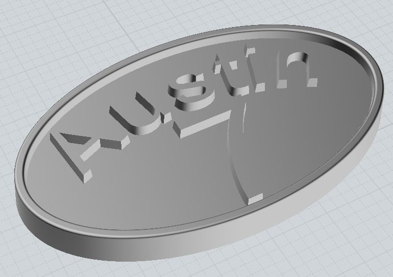

                    Did you use the Flow tool to position the text?

                        Hi Martin, Yes, I used the flow tool. The help file explained it enough for me to have a go, but the curve I flowed the text on was too big and I had to backtrack and shorten it. Then I found the stretch option. That helped, but the curve still had to be close to finished size. I couldn't see a way to center the text, yet. I also chose flat text so I could extrude it with draft.

                          The length and position of the base curve in relation to the items to be flowed is significant, as is its length in relation to the target curve. I've tried to give a few hints in the attached video.

                            Using Flow to apply text to a 3d surface to make an Austin 7 nameplate.
                            There's a bit of waiting for my old laptop on this video as MoI crunches the numbers.

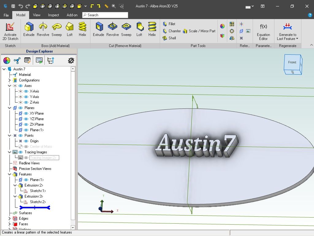

                                        It's like a toy that never stops being interesting in my case
                                        I'm not sure about lettering on curved surfaces with Alibre, the last I heard it was in a future update
                                        will have a go at it…
                                        Edited By Ady1 on 28/05/2023 17:48:10
                                        #646775
                                        Ady1
                                          @ady1
                                          Took me 20 minutes with the Tracing tool to get the basics, then extrude onto the plate
                                          I stole the lettering from your video
                                          You'd need to faff with the Loft tool to get the curvy bit of the plate, so say 40 minutes for a first ever try
                                          You would loft a solid curve under the bottom section of the lettering, then loft a curve cut over the top section of the lettering(in theory)
                                          You can almost always get there eventually with Alibre Atom, about an hour?
                                          Alibre Pro would probbly take 10 minutes

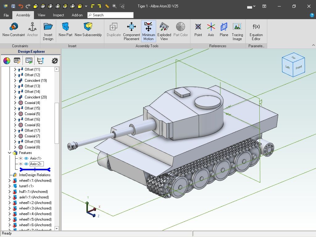

                                              Ady.
                                              The tank is coming along nicely – the tracks already look quite impressive. yes
                                              I'm sure the Austin 7 badge, made in Alibre Pro, would be quicker and easier to do than in Atom, but it's a fair bit more dosh, so we're back to finding something we can use and understand, that has the right tools for the job in hand, and can be had for a price we can afford/willing to pay.

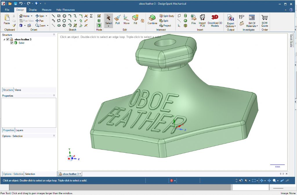

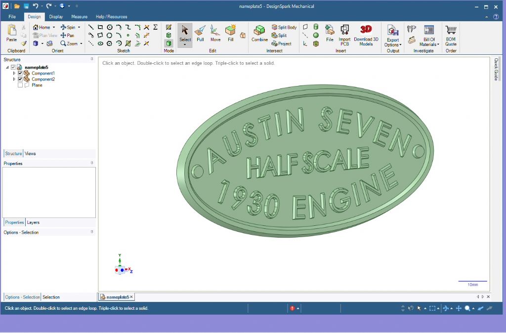

                                                      This image was created in Designspark. The text was created in Inkscape, exported to FreeCAD, exported from FreeCAD into DS, extruded with draft, then the backplate added. A lot of work involving three programmes. Luckily, all three are free!
                                                      This image was created wholly in DS. The body is a trimmed revolve, the text was created by measuring something (anything) with the annotation plane. The measurement is then changed to the text required and projected onto the surface. The text is extruded and another revolve is created to trim the text down to the same shape as the body. I think it may have been two annotation planes. Once a solid is created, anything that had been used to create the solid can be deleted. There is no history as such, just a list of the bodies created. MOI is similar, so I was used to the way it worked.
