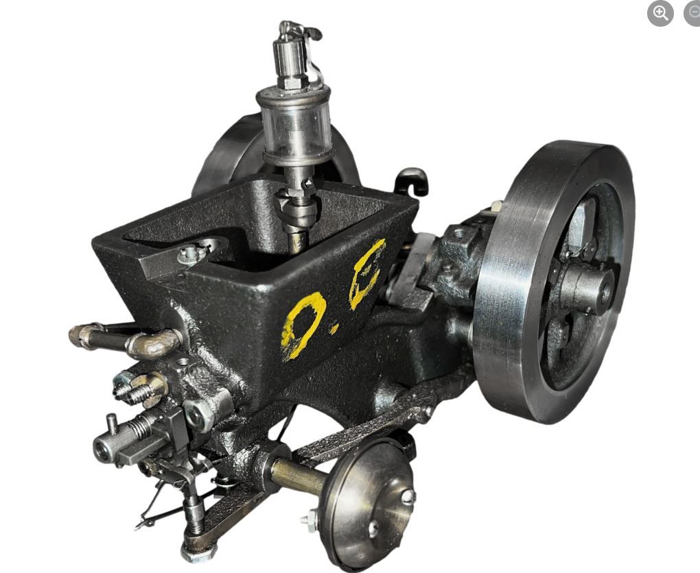

      I really just depends on what you want to design, some may be happy with a barstock engine that looks just like it was made from barstock, others may want it to look like it was made from castings others designs may be very organic I'd call myself a model engineer not a model artist and would find the options in MOI quite useful when trying to replicate old or new cast parts
      If you pay for the render option with alibre that record player is no problem to get the same look, I'm tight and would use F360 to do the renderings
      I've only set the glass jam jar fuel tank as transparent but all the workings are inside the shiny outer layer
      Also worth looking at the MOI model of that turntable, when you break it down it is far more of an "engineering" job made up of basic geometric shapes that could just as easily be done in Alibre, Fusion, etc The rendering of the turntable was not actually done in MOI

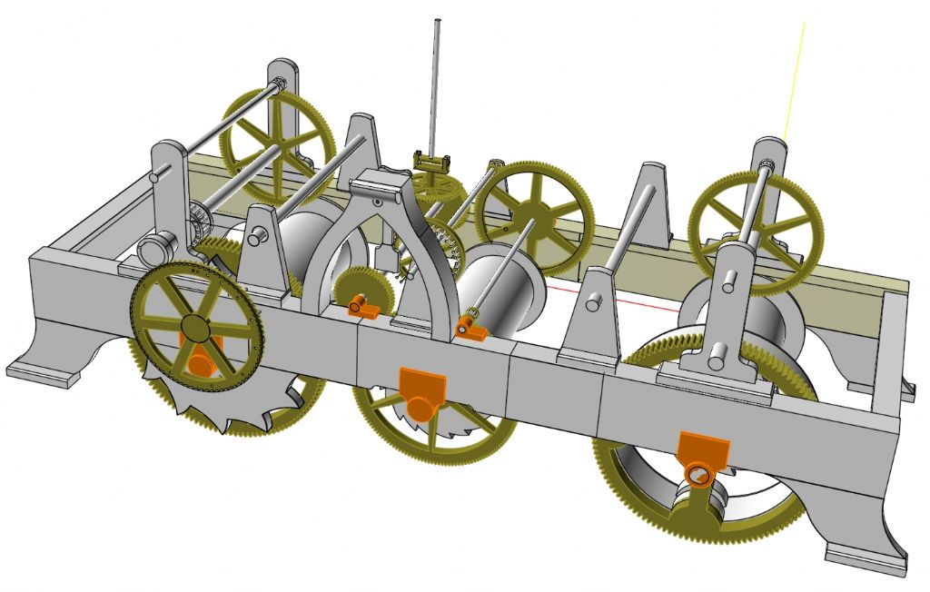

        As Jason says there is no problem modelling parts and assembling them in MOI, but which tool you choose depends both on what you want to do, AND which ones you find easiest.
        I use MOI simply because I "get on" with its underlying design paradigm. Never having ben trained in engineering design or technical drawing I struggle to get my head around the paradigm that underlies the majority of the 3D CAD programs.
        This is an MOI model of a clock I plan to make. All the parts can be separated from the whole, and drawings or diagrams created to take across t the workshop. Drawing each part in MOI makes me think about the design choices, while putting them together in MOI makes sure that they fit together.
        One approach is not better than the other – they are just different, and at the limits are capable of different things. I will never reach the limits, so I stay in the middle with the tools that I find easiest to use.

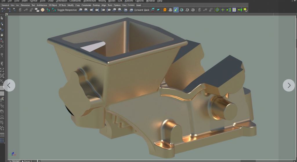

              As we are talking about renderings here are a couple of images, one of a model New Holland hit & Miss engine, the rights of which were bought by Littlelocos but the patterns were missing so he had to recreate them from the existing inventory that he bought as well as bringing them upto a standard that buyers expect these days not what they were like 30 odd years ago.
              If Nigel is following the work to reproduce the main casting was done in Turbocad and allowance has been added for double shrinkage so metal masters can be made, machining allowances etc. It will be cast in a gun metal type metal. This is a good example where compound curves, blending of parts etc is all part of the engieering process
              Bit more on their FB page

                As I don't use the other CAD systems, for the reasons explained above, I am not 100% sure what you mean by "doing assemblies". That model is put together part by part – in almost exactly the way I would do it in the workshop.
                Each part is created individually (in my case mostly by hiding the rest of the model while I do so), then connecting or associated parts are unhidden using the browser and the bits put together, then the rest of the model is unhidden. That model was actually created by designing the three trains as separate MOI models, then combining them into a single one.
                It doesn't do animations, although I often use stepwise rotation of parts to ensure things don't interfere with each other.

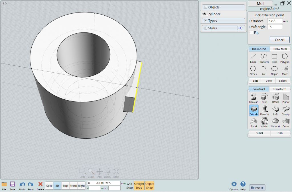

                  I am still plodding on with MOI, I won't give up just yet!

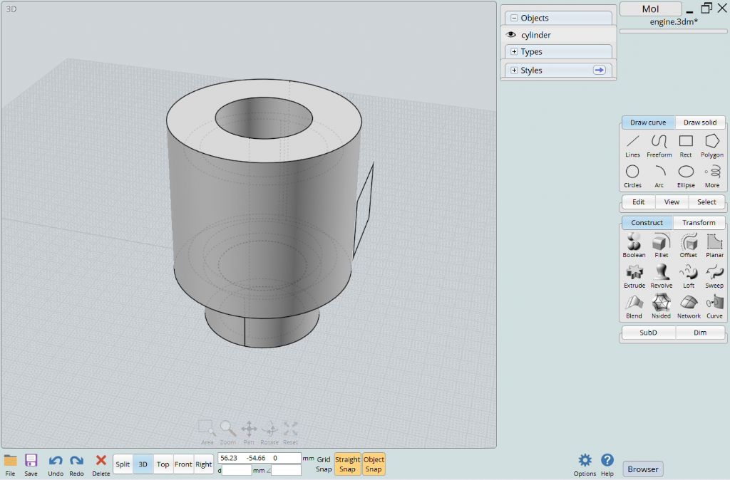

                  I drew an engine cylinder with water jacket. Now I want to create a water inlet on the side of the jacket. I drew a rectangle 3mm away from the surface.
                  And then tried to extrude it up to the surface with 5 degrees of draft.
                  I couldn't find a way of doing that except to run the extrusion past the cylinder face and boolean union the two parts. On virtually all other cad programmes I've used, a simple extrude would have done the job. Am I missing something? Or does MOI use boolean for all add/subtract operations?
                  Also, I couldn't find a "project to surface" function, it would have made drawing the initial outline of the water inlet a bit easier.
                  Still early days.

                    I think the function you want is in Construct/Curve which has four choices Project – Isect- Silhou – ISO
                    Although have never used them, they seem to do what you want.
                    I do use Boolean for most add/subtract operations – but then I am still learning.

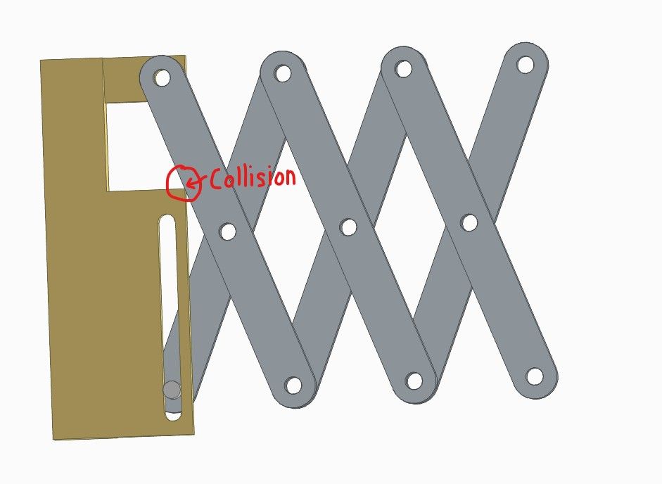

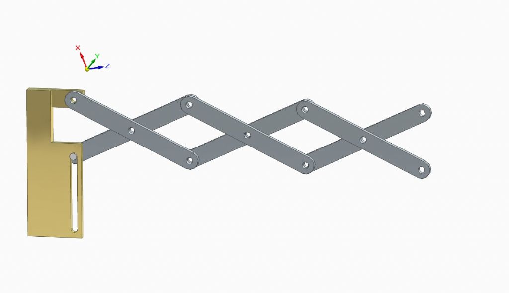

                      My retreat may have been premature, because that's not what I mean by an Assembly. I'd call it a group, that is a selection of bodies, each drawn individually, positioned adjacent to each other. In FreeCad the parts are identified in a tree from which they can be hidden or reworked. They are only related by their position in space.
                      Here's an example of what SE means by an Assembly, Fusion is similar. It's a rough start at a Lazy Tong Riveter:
                      It's an assembly of 4 parts: a Brass "handle", an Aluminium pin, which runs in the slot, and an arm, 6-off. The arms are connected by 7 rotating joints, plus 1 rotating joint at a hole in the handle, and a non-rotating joint to the Aluminium pin, which has a tangent joint with the slot.
                      As shown in the next mage, I've extended the arms by sliding the pin up the slot. Moving the pin operates moves all the other joints.  This is the same model, except the joints have operated,
                      Pulling the pin down moves all the joints and retracts the tong:
                      Note the pin hasn't travelked the full length of the slot because an arm has collided with a corner on the handle.
                      Joints are modelled too, allowing the Assembly to move realistically, and can detect when distant parts hit each other, as a result of the movement of 'n' joints away.
                      All the parts can be used by other assemblies, and this assembly (with joints), could be assembled within another assembly, also with joints. If I change the original arm part, all the arms used in the assembly change. If the change breaks a joint, the assembly won't animate until the joint or other relationship is fixed.
                      The model supports step-wise refinement, divide and conquer, and part re-use. As parts and sub-assemblies are independent, projects can be developed by teams, not just singleton developers.
                      Next step in this riveter is to connect the far arms to a hinged cam that pulls a shaft and clutch that grips the pop rivet, all inside some sort of head. Then I'd add fasteners to join the tong arms together, and either drill and thread the cam to the pull shaft (two parts), or tap the shaft for a bolt (three parts). Both methods can be tried, because many cam and shaft variations can be modelled independently, and – provided they fit – can be swapped around. This is important in production : might be cheaper to bolt, because that removes one threading operation, or could be more convenient to thread the shaft. Or maybe the whole thing should be cast, drop-forged, or force fitted.
                      Having looked again at the MOI website, I don't believe it does this type of Assembly. But I accept what MOI does is effective too.

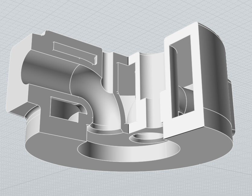

                            lee webster
                              @leewebster72680

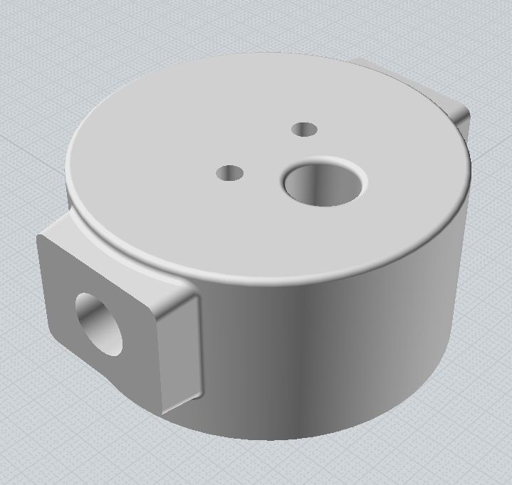

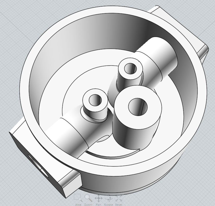

                              I have drawn a simple water cooled OHV cylinder head in MOI. I can't say it was easy, MOI has it's own way of doing things that I'm not used to. The only thing I didn't do is the water inlet. It would have been easy to add it, but all this is only practise.
                              This pic is a general view of the head. All lines are hidden and the head is coloured grey-ish.
                              This is a cut-away view showing inlet tract, water passage and spark plug hole.
                              Next I have removed the top of the head to show the water passage and other internals.
                              It's early days yet, 87 days of a 90 day trial to go. I will still look at other packages, including, and I never thought I would say this, monthly or yearly subscription. I could get the latest copy of Designspark Mechanical for a tenner a month that would have all the tools I need, for the price of a mobile phone contract. I will also check out Solidworks student or hobbiest cad package. I think that's about £100 per year.

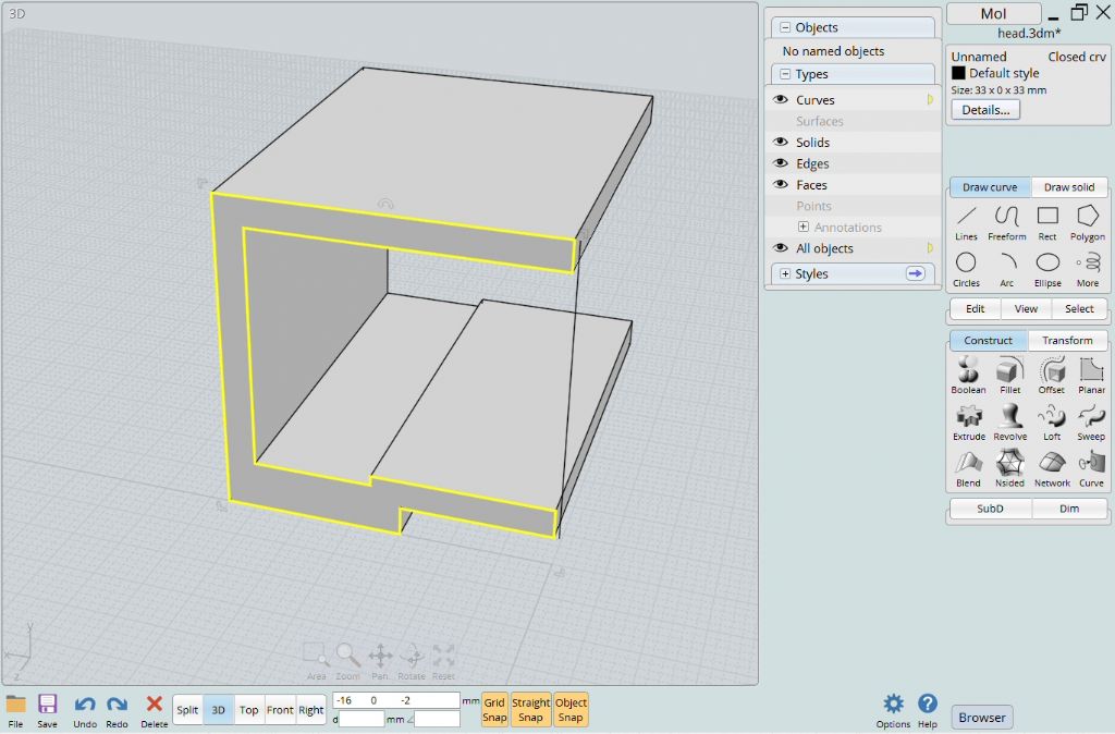

                                      lee webster
                                        @leewebster72680
                                        If I do a rotated sketch to create a hollow head, I can't see inside it to create the other features. Unless I'm missing something. Things get so tight in a head that's only 54mm dia internally, that adding 5 deg draft to say the plug boss could have it interfering with other parts. Thats why I always leave the top till last. But, I will give it a go! I can turn the faces off to create a wireframe environment, but new parts are created as solids, so a mixture of the two.
                                        I also saved a file as an STL and imported it into my slicer. It looks perfect. I didn't print it as it would take hours and serve little point.
                                        Edited By lee webster on 22/05/2023 21:11:38

                                            lee webster
                                              @leewebster72680

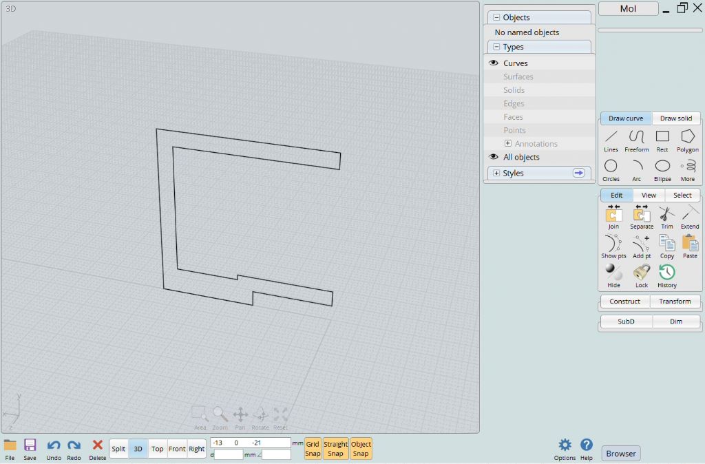

                                              Very interesting videos Martin, thanks for taking the time. I tried a rotated sketch this evening as suggested by Jason. It did not go well. I drew a closed curve.
                                              And then revolved it around the right hand side.
                                              The head was solid, no internal void. I undid that.

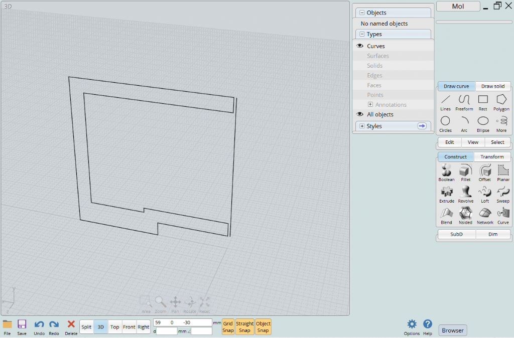

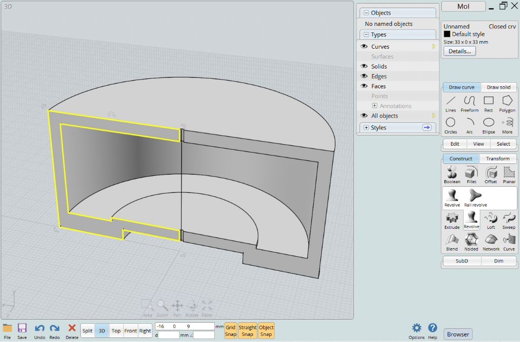

                                              I then drew a vertical line 1/2mm to the right of the sketch and revolved around that.
                                              I got a hollow head, no jokes please!, but of course it's wider and has holes in. I then extruded the sketch to make sure it was valid.
                                              I am missing something, but I can't figure it out. I did try different variations of the revolve, and managed to get two solids. The head, and the void, by deleting the two small uprights on the right hand side of the sketch. I boolean cut the void from the head to get a hollow head. Before posting this I tried the same sketch in FreeCAD and it worked perfectly. In your first video you revolved the base of the head and that worked OK. I tried full 360 deg revolves and it made no difference. The 180 deg revolve is to make the inside visible.
                                              Thanks for making it clear that I have spent so long without a mirror function in Designspark, that I have been drawing things like the inlet/exhaust tracts twice. Mirror will take some getting used to!
                                              #646234
                                              blowlamp
                                                @blowlamp
                                                Lee.
                                                I think you've found a bug! I've never seen this myself, but I can repeat it. I'll post a notice on the MoI forum and see if Michael will take a look.
                                                Well done! wink
                                                Martin.

                                                  blowlamp
                                                    @blowlamp
                                                    Posted by lee webster on 23/05/2023 00:05:00:
                                                    Thanks Martin. If he wants may original file I can post it to him. Maybe version 5 has a fix?
                                                    I'm using v5 and can easily repeat it, so it's one of those 'obvious' bugs that only new users seem to find. smiley
                                                    I've done a video of the problem for Michael so I'm sure he'll look into it. I know he's busy integrating the ACIS kernel into MoI at the moment, so we'll see what he says.
                                                    Martin.
