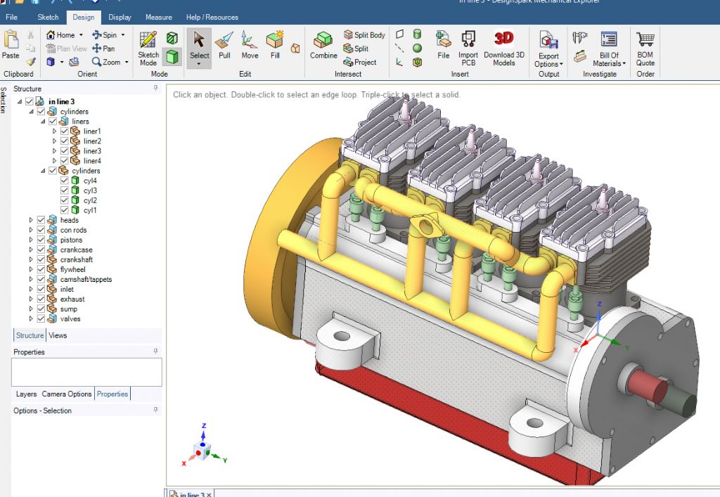

                    I have used Designspark Mechanical to do nearly all my work. This is a screenshot of a 4 cylinder engine. On the left is the tree with all the different parts or bodies. Only one body can be active for editing, and new bodies can either added as a separate addition to an existing body , or as a completely new body . Does MOI use someting like this tree layout? I have expanded the cylinders body to show that it contains separate bodies for the liners and the cylinders. Having the same name doesn't create a conflict. Yhe tick mark next to each body is to hide or show it.
                    Thanks for the help. Poor old Design Spark is getting fewer features as it progresses, unless you want to pay a monthly rental.

                      I think the Scene Browser would be the equivalent in MoI. This Video should give you an idea of how objects can be filtered & organised for further work.
                      Martin.

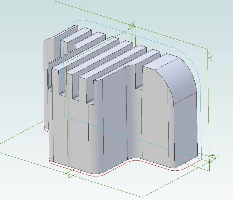

                                    Sorry Martin, but it's a thumbs down from me. Just a few minutes into MOI I discovered that it doesn't have an extruded cut, an essential part of my designing. Also, to create something like a OHV head for a single cylinder engine would have taken a minimum of 12 bodies that would have to be either boolean'd together, or removed, unless there is another way. I was however, very impressed with the size of the download file. They packed a lot of programme into a small space.
                                    I think I have been spoiled by DesignSpark which is so easy to use, and with a lot of features (except mirror).
                                    I am still looking for a replacement for DS, and the only option I have found is SolidEdge.
                                    Thanks for your help.
                                    Lee

                                      Posted by lee webster on 18/05/2023 21:30:17:
                                      Sorry Martin, but it's a thumbs down from me. Just a few minutes into MOI I discovered that it doesn't have an extruded cut, an essential part of my designing. Also, to create something like a OHV head for a single cylinder engine would have taken a minimum of 12 bodies that would have to be either boolean'd together, or removed…
                                      Lee
                                      Lee.
                                      You can easily do an extruded through cut with curves, just by selecting the solid and a suitably placed curve and then doing a Boolean Difference.
                                      The cylinder heads in your picture look simple enough, so I did a quick video of one way this could be done in MoI. A few more booleans and you could relieve the fins for the plug hole & stud holes. Dead easy.
                                      Martin.
