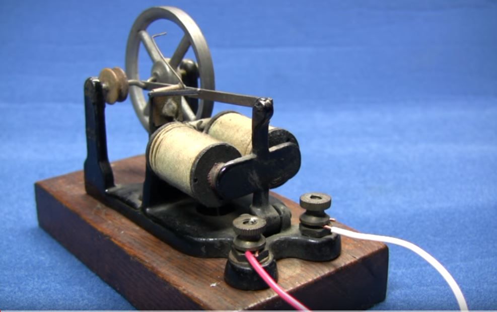

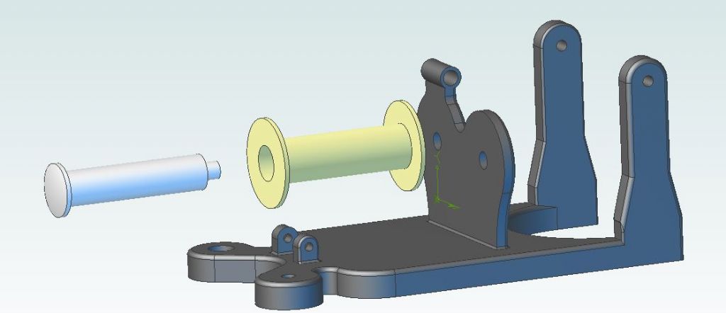

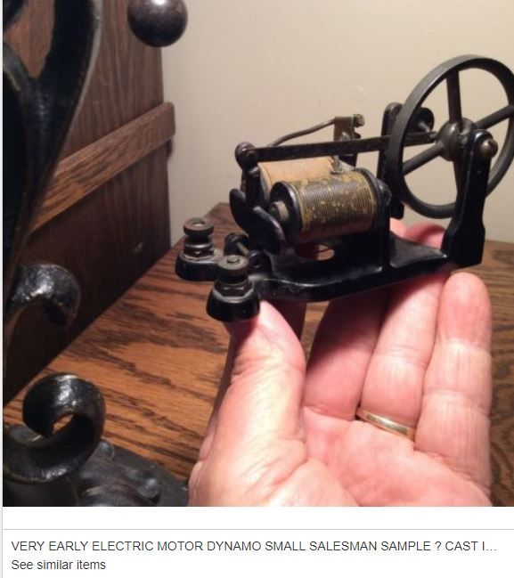

                                                    As I said while looking around the net for these early electric motors I came across an image of a toy electric engine from 1908 and then found a video which says it dates from 1908 and would have cost $1.25 from the likes of Sears or Roebuck. It is not the same principal but looks like it will make a fun project.
                                                    After a bit of sketching last night with Alibre it seems to work, well at least on the screen it does! By moving the reversing lever one of the two spring wire contacts will touch the conrod and complete the circuit which draws the rocker towards the magnets. Time to start winding some wiresmiley
                                                    Edited By JasonB on 09/11/2018 07:56:19
                                                    #379890
                                                      A quick question for the more electronically minded members.
                                                      I plan to use a bobbin to wind the wire around and use the core to retain that to the vertical plate that sticks up from the base. Question is can I screw the core straight into the plate or should I insulate the hole and retain with an insulated washer and nut on the far side? The base does become part of the circuit.
                                                      Thanks, Jason
