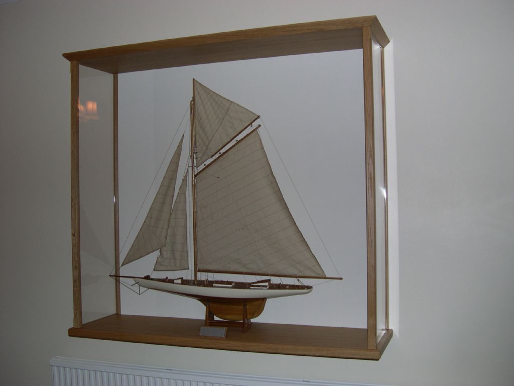

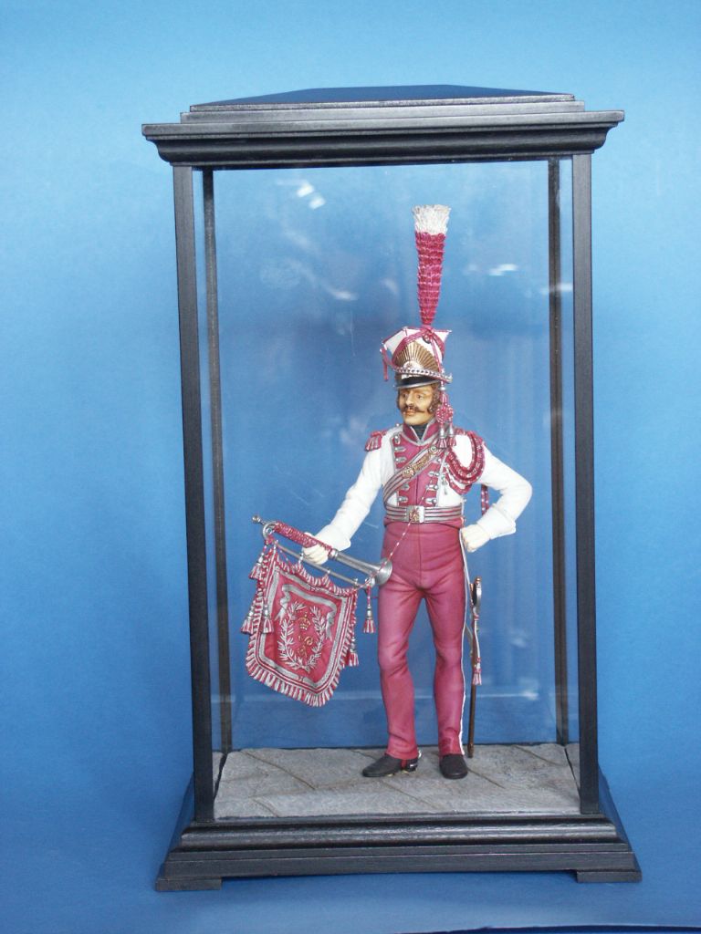

            Toughened is sometimes costly in thin sheets and the weight will soon go up if you use say 6mm, 3mm or picture glass will likely be OK for big cases I have used sheet polycarbonate.
            This one is 12" high and uses 2mm picture glass
            And this about 5ft square and polycarb
