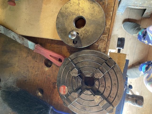

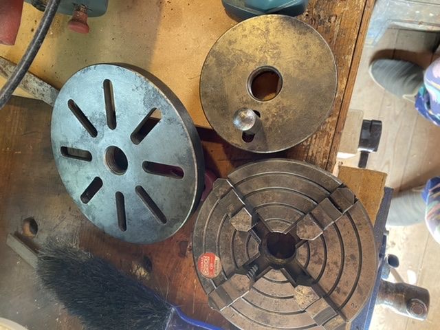

        some bit and pieces I got with the lathe, a cushman chuck, but I don’t have a key for this, any idea where I would get one, no key for the larger one also, don’t know what make it is.

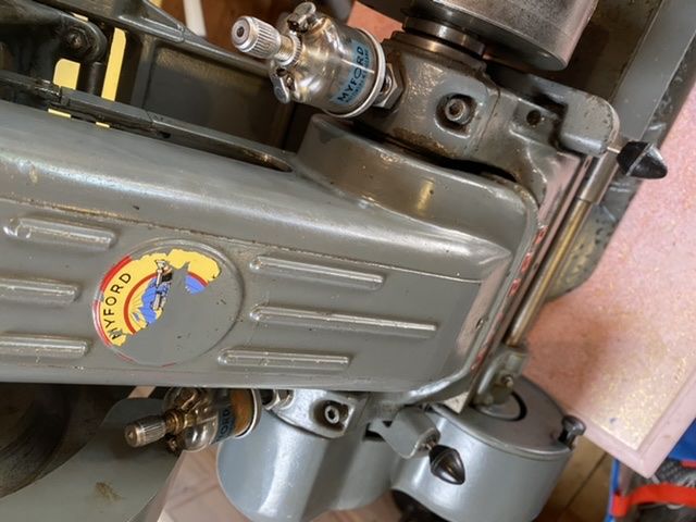

        what oil would you put in the oil feeders.

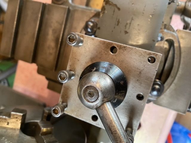

        the disc with the bobble on it, what exactly is this for and as you can see the quick change post is missing about 4 screws, where could I get them.

            The oil can be SAE 10 or ISO 32 a hydraulic oil. chuck key you may get from ARC. Noel.

                    The quick change post is missing about 4 screws, where could I get them.
                    These are ordinary screws you probably can get in the hardware store. You can use one of them as an example. I only use 2 srews to lock the tool.
                    There is a shop in the Netherlands that sells Myfort parts

                      You should ask the seller if he forgot to give you the relevant chuck keys, but equally you should be able to make your own at far less cost than buying new. Otherwise dial up "lathe chuck key" on ebay and find one with a square end at least as big as you require and file down two sides of it to a fit.
                      The disc with the bobble on (as you refer to it) is a catch plate for turning work between centers. Dial up "catch plate" on google and it shows you what else you need for that like suitable drive dogs and a couple of centers for each end of your work.
                      Dennis

                        No rogue grooves or holes in the chuck and faceplate – that and the generally tidy appearance is a good sign the lathe's been used and looked after well. The darker grey patches on the faceplate might be shallow corrosion stains, perhaps from damp storage at some point, but not enough to worry about.

                        The thing with the "dimple" is a catch-plate used when turning between centres. The plate is screwed onto the spindle in place of the chuck. The work, located by a centre in the spindle and tailstock, is gripped by a "dog", a steel forging with a tear-drop shaped hole and a set-screw, and the dog's tail is either straight and engaged by the pin (the "dimple" ) or is bent at 90º to locate in the catch-plate slot. At least one of those types of dog should have come with the lathe, hopefully; along with the centres.
                        Tool-post screws: probably BSF but you'd need measure their diameters and pitches to find out; or use a known screw or nut as a comparator. I'd ask of the various suppliers who advertise on here and in the magazines, in the first instance. If you use standard screws I would recommend turning a little chamfer or spigot on their lower ends so their thread starts don't become crushed. It's also a good idea to put a strip of brass or aluminium betwixt screw and tool shank to take the wear, especially if you use tools with soft shanks / holders. I have found…

                          The toolpost screws are 1/4 BSW from any bolt supplier. If the dont have BSW, then UNC will work. Thats what I use.

                          Your lathe looks like a good 'un. The clutch is a nice accessory to have. Paint would be good enough for me but Myford.co.uk sell the paint and stickers and many other parts.

                              I don’t think anyone mentioned oil. Use Nuto 32. Very thin and available on EBay. For slideways I used two stroke motor oil made for motor cycles.

                                do you need a special gun to get oil in the oil nipples on the lathe or is there something else you can use.

                                  Posted by Chris Murphy 6 on 30/05/2022 08:58:09:
                                  do you need a special gun to get oil in the oil nipples on the lathe…
                                  An ordinary pump oil can with a spout that fits reasonably well should do.
                                  But welcome to the world of leaky oil cans! Probably everyone who ever bought a lathe is unhappy with his oil-can. They almost all leak! The one provided by Myford with new machines is often criticised, as are those that come with new Far Eastern lathes.
                                  My least leaky oil can is a cheap plastic one, I think it came from Halfords.
                                  Reilang Oil Cans have a good reputation, but they don't please everyone all the time. Extra annoying when an expensive tool is no better than a cheap one!
                                  The main thing is to get a squirt of oil into the lathe, ideally before each session.
                                  #599913
                                  Hopper
                                    @hopper
                                    You can also get a good quality oil gun from Press Parts web site. pressparts.co.uk
                                    The cheaper Sealey one I bought leaks from every seam. Don't bother.
                                    Neither will get into the nipple on the backgear in the headstock. For that I use an oil can with the brass nozzle turned down to a fine enough point to go inside the hole the tiny spring loaded ball sits in. Which works for all the others too if you want to go that way.
                                    As to what type of oil, any unused engine oil is my usual preference. Seems to work OK and has done so for over 50 years on my older Drummond lathe. Actually, more like 70 since my dad first got it. But if buying oil, ISO32 hydraulic oil is the recommended for headstock and general lube and ISO64 hydraulic for the slideways. Or you can get special slideway oil but that might be overkill on a vintage machine.
