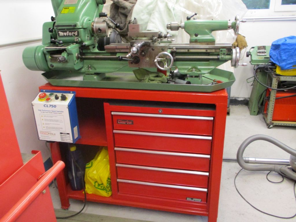

                                        I​ have just been through the same process for my S7 and after several failed attempts at buying an original stand I choose to make my own. The main reason was that when I tried a friends machine on a stand it was too low for comfortable use and the amount of storage space available was more limited than I expected.
                                        I built mine to the same footprint as the Myford stand but with square ends and a couple of inches higher, for the type of storage I needed I incorporated a Clarke Roll Cabinet with suitable drawers. The stand is made from 50x25x3mm box section with 2mm sheet sides and shelves with 50x50x5mm for the top frame and lathe mounting positions. While it was straight forward to make I can't recommend it as an economy move as the steel cost £120+ and of course the cabinet if I hadn't had it spare.
                                        Not sure if the photo will display as I haven't posted here for a few years
                                        Keith
