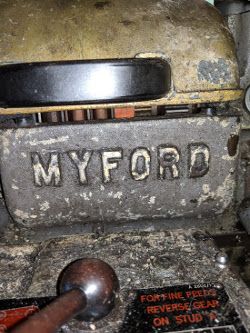

      Hi – Hope someone can help out here.
      I am restoring / rebuilding a Super 7 recent ebay purchase. It's a MK1 with the oil dripper and sight glass, 1958 model or thereabouts going from the serial number.
      I'm getting to the stage of repainting – Obviously the main colour is Myford Grey but when I purchased it a previous owner had painted the gap between the bed rails a horrendous shade of pale yellow, and had picked out the raised "Myford" and "Super 7" in the same disgusting yellow.
      Is this correct or should it be red or should it all be grey ?
      Also, the brackets that mount the cross slide and top slide handles, should they be grey or black ?
      Cheers – Dave.

          Don't know about your specific model, but the yellow you describe was standard trim on some models. But it's your lathe so paint it red if that's what you like. I agree with you: it looks better.
          Top and cross slide brackets were usually black. Satin black looks best. Covers up casting roughness. Thread chaser dial body was also black.

                The creamy yellow colour was standard for the inside of the bed and lettering, and the early Super 7s had the crossslide and topside brackets painted in the same grey as the rest of the machine. Lots of useful info and pictures at http://www.lathes.co.uk

                  When I restored my ML7 I went for deep red down the centre, which I thought looked the business. Also went for the same red on my late model green Super7 when I restored that. I'm not a fan of the yellow personally and if you plan to keep it, go for whatever you like I say.

                    I have a 1958 Super 7, sight glass headstock, cone clutch. The inside of the bed and lettering is a cream colour.

                      Yes, red it's going to be – I just thought that grey and custard yellow was such an odd combination surely the factory wouldn't have turned them out like that originally ? Maybe the paint guy was colourblind. wink
                      Lotus green & yellow, now that's a good combination, but dark grey and yellow – Nah.
                      Satin black for the slide brackets – that's good – thanks.

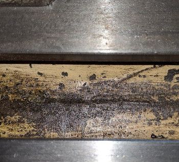

                                                    I removed the saddle assembly and tailstock to lighten the machine for transport home. On inspection the original saddle was obviously massively worn, on closer inspection the oilers were full of hardened grease so no idea when it last had a proper oiling.
                                                    I was OK with scraping the bed, but the saddle would need more serious work so I bought a used (late model, wide guide) saddle with virtually zero wear – factory machine marks still very obvious – hardly any visible wear. Should save me a lot of time in the long run.
                                                    So I didn't try the saddle to bed fit before the bed scrape, but after many, many hours of tedious scraping I got the bed flat – Well as flat as I can and a whole lot better than it was previously. The main wear on the bed was on the front edge of the front rail, starting around 1 1/2" from the headstock end.
                                                    I made myself a carbide scraper, used a thick sheet of float glass as a surface plate and it took around 3 weeks scraping for 2 or 3 hours most evenings until I got even blue spotting all over the top of the bed. Obviously most of the hard scraping work was at the unworn tailstock end, and more on the rear rail than the front.
                                                    I decided not to scrape under the headstock, so as to leave the original reference there, thinking that I can shim up the tailstock later if required so the centres match. I realise this isn't 100% perfection but I think I can live with it. I can always revisit this in the future if It throws up noticable errors.
                                                    I miked up the verticals measuring from the untouched rear one, not too much wear there but to correct it I welded up a square steel frame, bolted 2 sealed bearing races on the back and a piece of square section aluminium tube on the front. I then stuck some sandpaper (the Klingspor self adhesive backed stuff that bodyshops use, not regular stuff), to the ali extrusion, put plastic pads underneath so not to mark the freshly scraped bed – then slid it backwards and forwards along the bed using the bearings as rollers against the rear vertical, and the sandpaper to clean up the other verticals till they all came in parallel to the rear.
                                                    As for the undersides of the rails, after a good clean up I went round with a micrometer and got good readings all the way along. As I was going from narrow to a wide guide I didn't need to check the inner ones.
                                                    I had problems when fitting up the apron to the new wide guide saddle, the handwheel wouldn't turn and the split nut wasn't centred on the leadscrew. Turns out the bolt holes in the later saddles are approx 2mm further inboard than the early one, so I have had to slot out the holes and make up some custom washers. That's all working nicely now, no tight spots taking the saddle end to end. I just used the shim stacks that came with the later saddle I bought, they seemed loose before I oiled it up so I tried peeling off one shim, refitted them and it clamped up solid, so I have put the shims back and all free again, now I have oiled it I cannot detect any play by hand.
                                                    A question though – If I was to check with feeler gauges, what sort of clearance should I expect between saddle & bed in a perfect world ?
