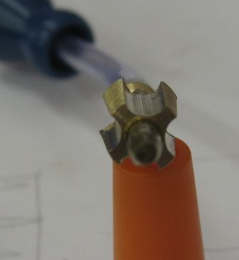

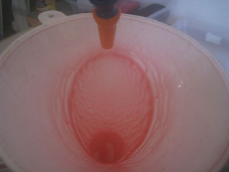

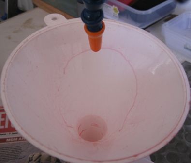

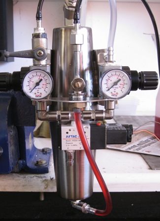

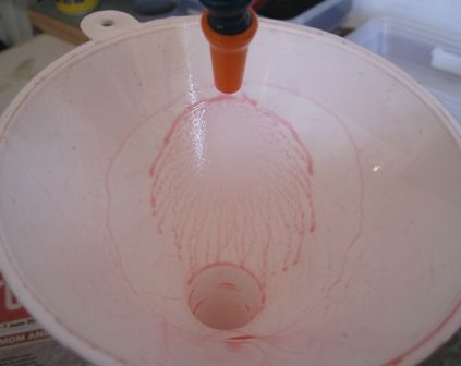

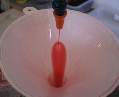

                                #525325
                                Joseph Noci 1
                                  @josephnoci1

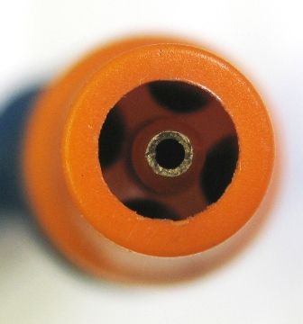

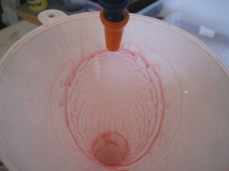

                                  These type of systems should not be referred to as 'Mist cooling systems' – The ones that have earned similar system the bad reputation do just that – generate mist – and that is NOT what you want. If a mist results, very little of it ends up at the cutting tool tip, a lot ends up all over the work area and in your lungs, etc. If mist is being created it is a sure sign of excessive air velocity at the mixing nozzle. The aim is to have micro-droplets of the fluid trapped in the airstream, certainly no mist. If you see fog at all, and it floats about, the fluid has been atomized and that is not desired and hazardous to your eyes and lungs.
                                  I built such a system and posted here about the build – A pressurised fluid chamber with the fluid entering the mixing nozzle where it met with and was entrapped withing the low velocity airstream. It works very well, but only did so once I fitted pressure regulators in both air feeds. A single air line feeds both regulators, with a air solenoid in line, activated by spindle on. When turned off, the solenoid vented fluid tank pressure to air so the fluid flow stops right away. The fluid tank outlet to the flow line is via a needle valve to be able to set fluid flow volume to suit fluid viscosity, etc. – I use only neat cutting oil, no water soluble types, so viscosity plays a bigger role.
                                  The nozzle design was a bit of effort too..
                                  All in all, a bit of a pain to set up, but once running, a pleasure to use.
                                  Don't know how to post a referral to my specific posts on this, and don't want to repeat the whole thing here, but here are some photos..
                                  1 'drop' per sec with air
                                  1 'drop' every 2 sec, with air
                                  1 'drop' every 5 sec
                                  3 drops per sec with air.
                                  Flow stream , no air.
                                  Nozzle. Air flows around it, inside the blue tube in the background. Fluid flows from a small hole in the nozzle tip.
                                  Hol is 0.7mm OD
                                  Joe…

                                      Lovely job.
                                      I think I'm going to steal your design and retro-fit my Bjur systems. The standard set up is just too hard to get reliably set at the right flow level. Probably crud build up in old age.
                                      Bjur use a slightly smaller nozzle, about no 75 drill I think, and slightly different mixing arrangements. Only one regulator so air and tank run at same pressure but I don't thik thats a great issue as there is a needle valve to regulate the oil flow. Supposed to run at around 22-26 psi but open the valve wide and up the pressure and the results are lethal!
                                      Clive
                                      #525337
                                      Joseph Noci 1
                                        @josephnoci1
                                        A large part of success lies in the nozzle. I can turn up the air volume high enough to blow chips out of a groove being milled, without mist developing. The trick is to have a large area of air exit at the nozzle, and to have the fluid exit hole well past the airflow nozzle tip, ie, the fluid outlet tip in my nozzle is about 6 to 7 mm outside the air nozzle outlet tip. That way the venturi effect is almost negated and the fluid is transported down the center of the airstream . The fluid outlet must not be at an air expansion point within the airstream, as it is at that point that a drop in air pressure occurs, and the possibility of atomization arises.
                                        Joe

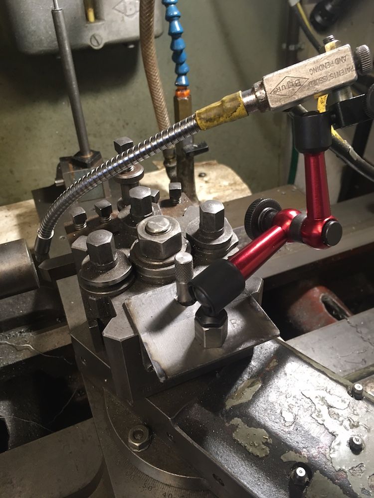

                                                  #526010
                                                  Clive Foster
                                                    @clivefoster55965

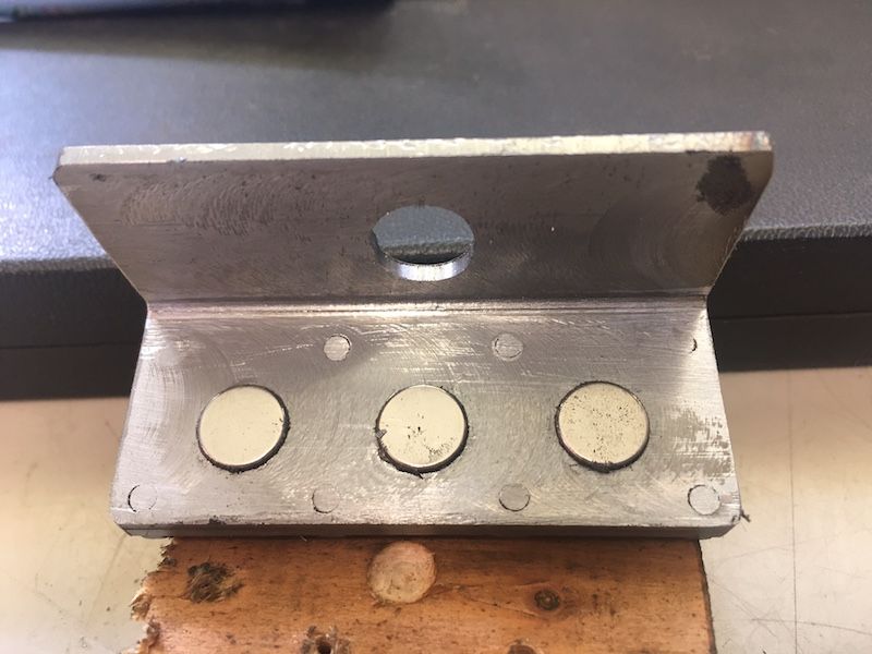

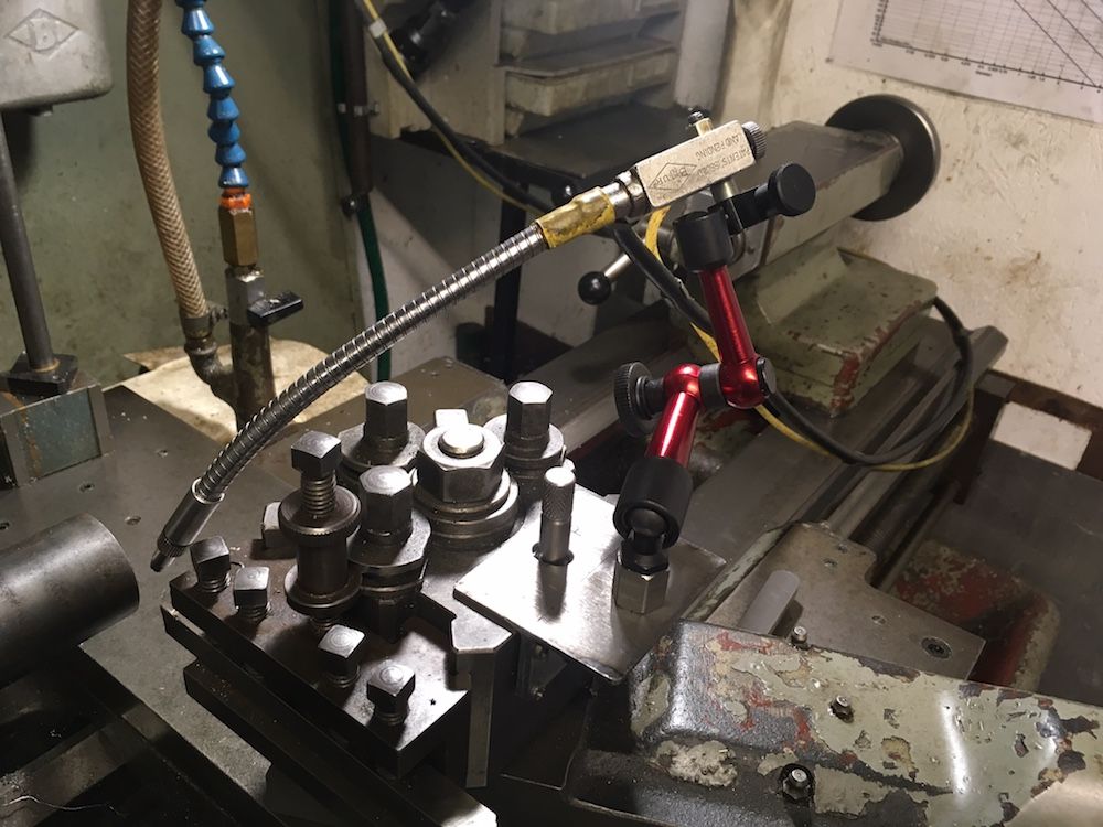

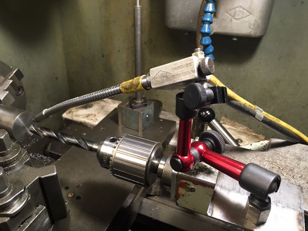

                                                    Fog Busters and other low quantity coolant/lubricant devices need a flexible mounting system allowing the nozzle to be gotten very close to the cut so the coolant/lubricant goes where its needed with minimal waste. As the output consists of fine droplets in an airstream its clearly much better if the nozzle and airstream point away from the operator so all the drops splat onto the job or machine without bouncing back into your face.
                                                    Conventionally coolant systems are mounted on the rear of the machine so splash or overspray tends to go towards the user. Very unpleasant unless you have effective guarding to intercept the stuff.
                                                    I've been working on a magnet retained system to carry my Bijur Spraymists on the quick change Dickson toolposts of my lathes. Magnetic retention to make it easy to slide on and off as required.
                                                    Basically a Tee section built up from sharp corner angle iron has magnets on the vertical face to keep it all stable. One arm of the Tee hooks over the anti-rotation pin and the other mounts a small, cheap, imported articulating arm (of the type officially sold to mount dial indicators) carrying the mister head and feed tube mount.
                                                    I imagine a simple post with multi-position clamp on arm could serve just as well to carry the mister head but might need some low cunning to get the right angles of dangle. The articulated arm seemed more likely to just work.
                                                    It all quite effective at getting the nozzle where it needs to be:-
                                                    1) Longitudinal Feed
                                                    2) Cross feed / Facing
                                                    3) The top of the tailstock on the Smart & Brown 1024 VSL is basically rectangular so it sits quite well on that to enabling it to be used with drills.
                                                    4) Three small 10 mm diameter x 3 mm thick magnets keep it in place
                                                    In the background of the photographs you can see the small magnetic base and post I've previously used to carry the Bijur head. The big, flat top of the S&B cross slide made that just about useable because the magnetic base could be slid around to find a position where most of the lubricant went on the work and none came back in my face. But it was never very satisfactory. The vertical lock-line is fitted to the original full flood factory system. Effective but messy. Very messy.
                                                    Two set-up for my two lathes have cost me £20 (ish) for two arms and 10 small magnets and some work to make sharp steel angle from the very rusty stash inherited when helping to take down and old domestic garage.
                                                    Not too shabby.
                                                    Clive
                                                    Edited By Clive Foster on 09/02/2021 19:40:27

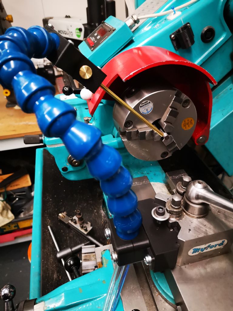

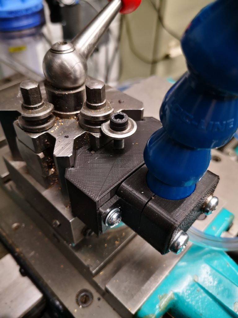

                                                    #526167
                                                    Alan Wood 4
                                                      @alanwood4
                                                      As a variation of Clive's mounting technique, I modelled in Fusion 360 a 3D printed version of a standard Myford QCTP tool holder to mount the Fogbuster nozzle. The nozzle itself has been modified per Clough42's idea to feed the air and lubricant via 1/2" LocLine. The front position on the QCTP works well in driving the air jet to the back of the lathe. The QCTP fixture also means the nozzle can be quickly removed when working non lubricant materials. If undertaking a boring operation the head is rotated to its normal position and the Fogbuster mount is fitted to the side slot.
