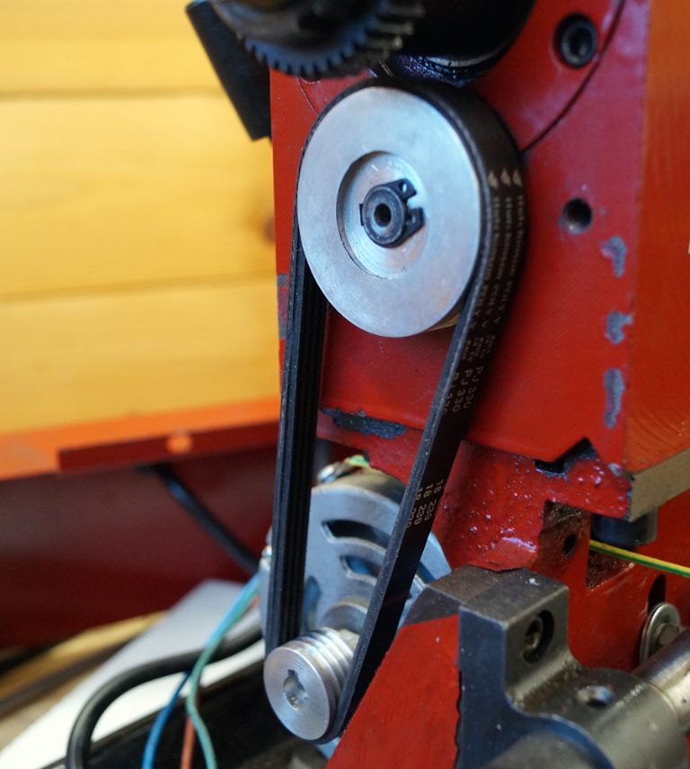

                      New Poly V drive belt and pulleys fitted at long last.
                      It will be a bit of trial and error re the belt tension, it obviously needs enough for decent cuts but at the same time able to slip in a stall or a crash (not that I plan on doing that of course).
                      At the moment I have set it up so that I can twist the belt through 90 degrees quite easily so its not too tight, whether that is somewhere near or not I will see.
                      Thanks once again to Jason for the idea in the first place.

                        Back home after a week away so this morning I tried out the new drive, the pulleys run nice and true and are a good fit. I gave the belt a touch more slack but I,m guessing really at the balance between having enough grip for drive and the safety of belt slippage in the event of a crash or stall.
                        I took a number of 1.0 mm cuts on alu and a 0.5 mm cuts with steel and it was fine, I know some take heavier cuts on mini-lathes though I think that is heavy enough but thats just my thinking. I did consider taking increasingly heavier cuts until I stalled the lathe to see at what point the belt slipped but decided against it. I dont think it a good idea to stall a machine so I will hope and trust that the slack I have in the belt adjustment does its job should I have ever have a lock up.
