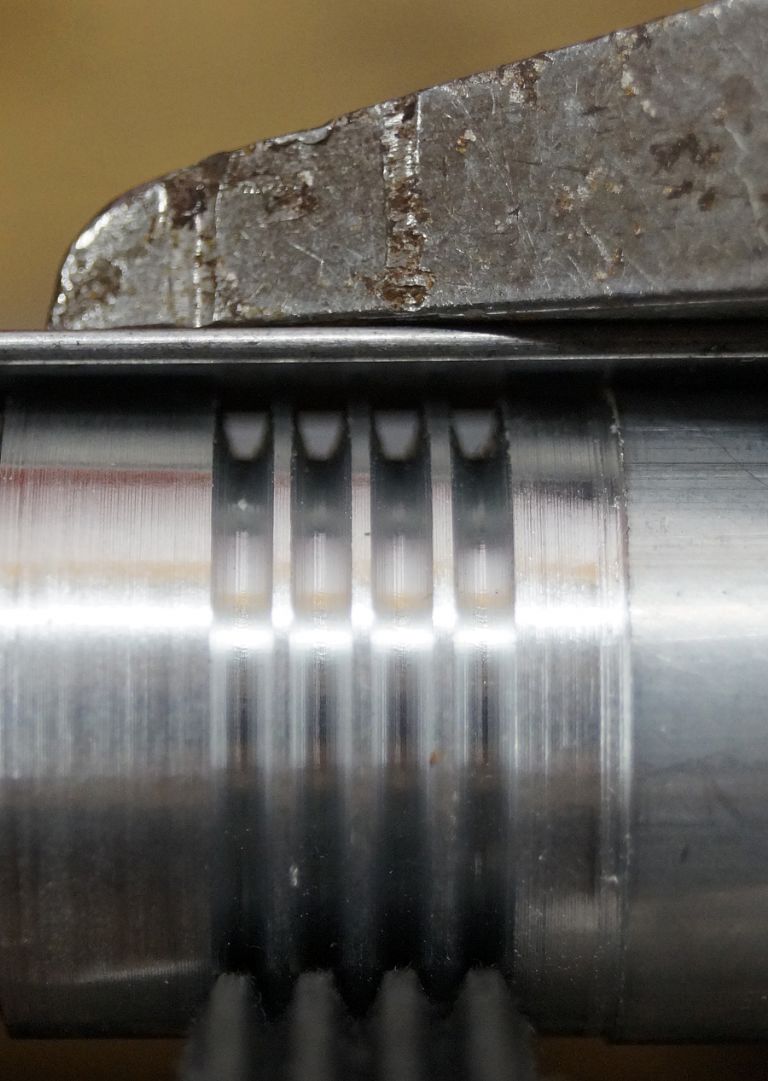

                Had a practice at cutting the vee,s for the pulleys.
                40 degree tool, 0.092" vee centres, 0.082" deep, skimmed the o/d to put a small flat on the crests. With a magnifier and back light the belt ribs looks to have good contact with the flanks, though you cant see that in the pic as the belt is inside out so curving away from the bar. I used a blunt knife blade wrapped with a used piece of 1200 paper to polish the flanks. However if you look at the vee,s at the top of the pic you can see that the tool needs adjusting, the 40 degrees angle on the tool is good but its off centre.
                Could be a better picture.
                #386214
                  Ron, the idea of those little angle gauges and the reason I said to cut a rectangle with your notch in is that you hold one side of the gauge against the work and then adjust the tool in it's holder so it fits the vee, see bottom left

                    Posted by JasonB on 18/12/2018 09:41:37:
                    Oops, I forgot that bit Jason, I will have another go and get it right.

                          Well 2nd attempt but with the tool set to the gauge I had made, the flanks of the vee are now centered or as near as damn it.

                            Pulley looks good Ron, well done!

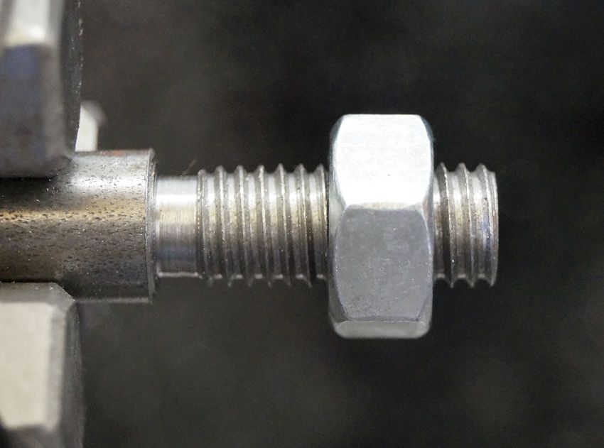

                                              I cut my first thread, quite pleased with myself but it was more a test of the lathe at low rpm. Its M8 on free cutting steel, low range 80 rpm which was not too fast so quite easy to manage. No issues with the lathe it seemed to have plenty of torque but of course 8mm is not very big.

                                                Beware of overheating if you run too long at very low speed – this applies to all direct drive lathes, but especially older brushed motor mini lathes.
                                                Well done with the thread!

                                                  Good effort, well done. Might be wrong but from the picture the root of the thread looks quite wide compared to the crest, may be the radius on the tip of the tool was a bit wide? You are getting the hang of this machining lark though! Merry Christmas.
                                                  Paul.

                                                    Paul, You are probably right but I will put it down to my first attempt..smiley I realise there is quite a lot to good thread cutting but to be honest I was just pleased to get the nut to fit and it feels quite a good fit, probably for the wrong reasons.
                                                    Neil, I will have another go and check the motor thanks for letting me know.
