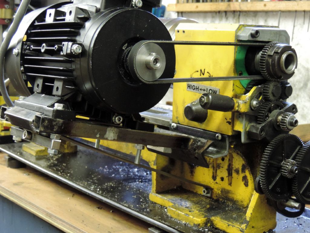

                Ron, the other option is to bypass the layshaft entirely and pop a big 3-phase motor on it that drive sthe spindle directly like this bodger haswink 2

                    Posted by JasonB on 07/12/2018 13:35:50:
                    Wow, that is some motor, its a bit too scary for me though, plus 3 phase and associated electrickery that scares me even more.

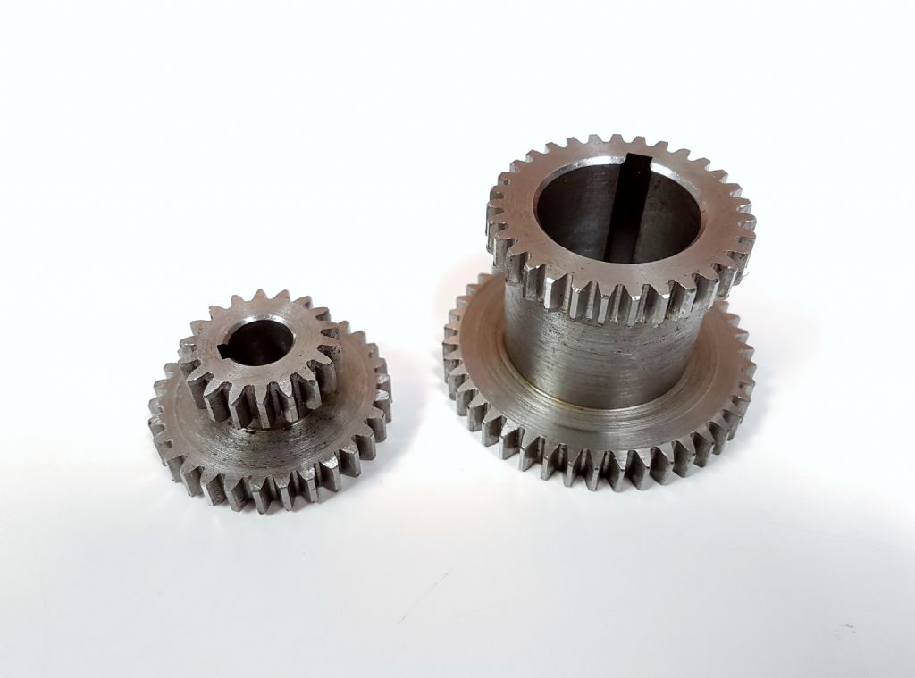

                      The plot thickens !
                      I was about to order a replacement set of the plastic gears, I was on the Amadeal site (they supplied my lathe) when I noticed that their metal gear set looked different. Looking at the spec they had quite a lot more teeth than the plastic ones, 50% more in fact, so I gave them a call. They said that their metal gear sets have had the number of teeth increased to reduce the noise associated with the old set which were just a copy of the plastic ones. They claim that the new metal set is still not as quiet as the plastic ones but not far behind and a vast improvement over the old metal set.
                      The plastic layshaft gears are 12T/20T and the spindle gears 21T/29T which in the Amadeal new metal set have become 18T/30T and 31T/43T. So thats put the cat amongst the pigeons as I am thinking of giving them a try, though I wouldnt do it without the mod to the belt drive.

                        Posted by Ron Laden on 07/12/2018 14:16:40:
                        And look at the state of that welding!

                                I have ordered the new type metal gear set and a poly vee drive belt to replace the timing belt. I will need to make a motor drive pully and the layshaft pully. The motor pully is fitted with a grub screw and the layshaft pully has a keyway and secured with a circlip, I plan on copying that on the two new ones which will save any mods to the layshaft.
                                Having no experience of multi vee belts or cutting keyways, this is what I am thinking but please shout if I have it wrong. I am guessing that the depth of the rib grooves in the pully will need to be cut just shy of the depth of the belt rib, too deep and the belt at the base of the ribs will contact and the ribs wont..?
                                The keyway on the existing pully is 3.9mm wide and 1.9mm deep, I was thinking of drilling a 3.9mm hole before I put the hole in for the shaft and positioned to give a depth of 1.9mm from the edge of the shaft hole if that makes sense..? After the shaft hole is in I would then use a square needle file and square out the keyway, it will be around 13mm long and the material is 6082.

                                                A picture of the metal gear set I have ordered, not as coarse as the original metal gears there is 50% more teeth. So fingers crossed that these will run well and not be too noisy, they are said to be much quieter than the old set.
