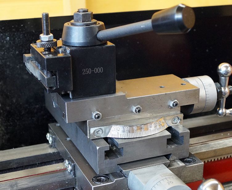

            Cut my first dovetails and they seem to have gone well, its always a relief when you try something for the first time and it works out with no problems (thanks for the advice guys). The mating dovetails on the saddle have broken edges so no need to add any to the cross slide. I used a couple of dowels and checked the cuts for parallel and they are good to 0.001" so more than happy with that.
            Picture below shows the original cross slide against the new one, the new one is 9mm thicker 20mm wider and 25mm longer, it looks quite a beast in comparison just hope its worthwhile.

                      The new cross slide is finished, well apart from a good clean up, debur the corners and edges and I am going to polish the dovetails and underside running faces with some 1200 paper.
                      I ran the top of the Tee slots full length but the lower section of the slots stop short front and rear of the turntable. Just the top slide to modify and it can all go back together.

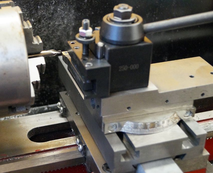

                              I have reduced the height of the top slide by taking off 5mm from the tool post seat and loosely placed all together just to check dimensions. Although the heavier cross slide has lifted things the top slide reduction plus changing to an ARC 000 qctp puts the tool 12mm lower/closer to the base of the top slide assy. I,m hoping that this will help towards improving rigidity.

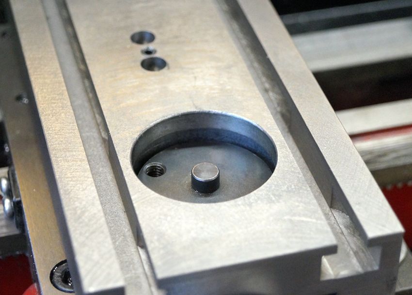

                                With the extra thickness of the cross slide the turntable mount drops down and sits on the saddle face whilst conveniently retained by the mount hole so it slides back and forth with the slide. Using the cross slide with the top slide removed I can see a problem with swarf dropping in and getting through to the underside of the slide so I thought of turning up a nylon plug which drops in and prevents any ingress, should work.

                                  Well its all back together the heavier cross slide fitted adjusted and set-up. Will it make any difference though..? well its early days but it does feel different, this could be my imagination of course but hopefully not. I did a number of parting offs with alu and steel and that certainly has changed for the better. I inverted the tool and ran in reverse, the first time I have tried that and had no issues at all, in fact it was a pleasure to do. Whether the improvement came from the inverted tool or the heavier slide I dont know but I suspect a combination of the two.
                                  I am impressed with the ARC tool post, looks to be well made and good quality, works well too. Out of interest I clocked the tool holder after removing and refitting half a dozen times and it was spot on, so I guess a good sign. Despite getting an improvement with the parting I,m still going with a rear tool post which was the main reason for the new cross slide. So thats enough for now in the way of mods to the lathe (and the mill) there is a 0-4-0 waiting for a few finishing jobs and an engine I started and need to get back with.

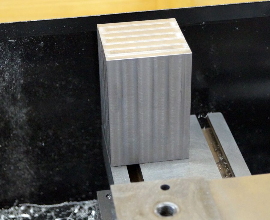

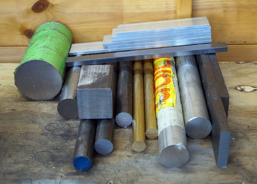

                                      Every now and then my old employer drags me out of retirement and this week I have been working at a large engineering company.
                                      Before I left and thinking of the rear tool post I asked if they had a short piece of 50 x 50 steel I could buy plus would they allow me to have a look in the scrap bins for any ends or small offcuts. The production manager said the bins had been emptied the day before but they would see what they had around the shop.
                                      Just before I left they gave me a box containing a selection including a 75x50x50 piece of steel. Despite my trying the manager flatly refused to take any payment. I will be going back and I think a very good bottle of something nice will be the least I can do.

                                        I have machined and squared up the basic block for the rear tool post but I,m a bit undecided which way to go forward.
                                        The main use of the post will be parting using a 2mm tool which I need to make a holder for, I did think of machining a tenon on the bottom of the post which would locate in the T slot and fixing the post to the slide. Would it be more versatile to go with a mount each side of the post, one for the parting and one for other tooling and have the post swivel, havnt quite figured out how to do that though.
                                        The post is 50 x 50 and it does look a bit large on a mini-lathe, wondering if 50 x 40 or 40 x 40 would be better.
