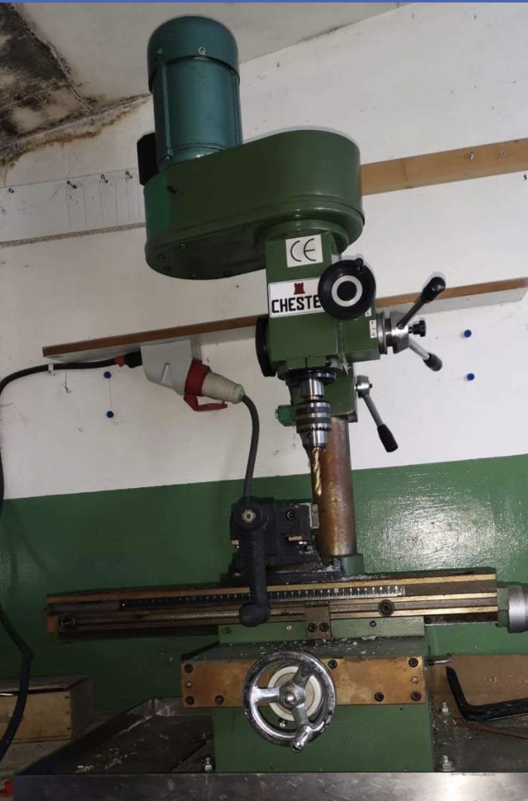

        As the title suggests, I’m looking at buying this machine as a first mill but the guy is selling it for someone & cannot offer any information other than it’s working.
        i think I have it down to a Chester Champion but was wondering if any of you good folks can shed light on it for me pleasec7cac91b-3fcb-428e-8ec9-c44baaf0683d.jpeg

          I think Warco were selling something similar around 30 years ago which they then replaced with a copy of the Emco FB2 which didn't have the motor off to one side.

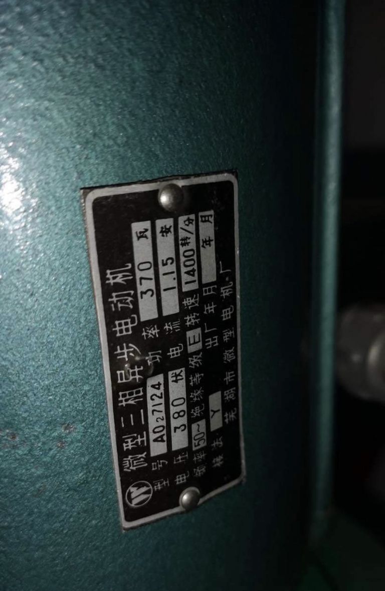

            Thanks Bazyle, I’m unsure if it’s single or 3 phase, there’s a pic of an ID plate on the motor but it’s all in Chinese apart from a couple of numbers – 370 & 380 so I’m unsure, don’t know if this has any relevance or not

              It's a Chester Champion milling machine, one of Chester Machine Tools early products that they sold for years. It had a four speed belt driven tilting head powered by a single phase motor.The identical Warco version was called the ZX15.
              The six speed geared head Warco XZ15 mill was Warco's replacement for their VHM mill which was the copy of the Emco FB2 machine, the geared head XZ15 was not as good as the Emco copy VHM and was only offered briefly.
              It's easy to mix up the Warco belt drive ZX15 with their geared head XZ15 mill.

                Lathejack that’s brilliant thank you, so I take it that it’s ok for a first mill? It’s either this or a new X2 or WM12 as there are no others coming up for sale lately – bit of an off the wall question but does anyone have any idea of a rough weight? I have a mate with a van who will help me fetch it but there are only 2 of us, I’m a big lad but he is quite vertically challenged & by his own admission ’cor lift much’, am I due a hernia or not?

                  If the Chester Champion is as heavy as the Warco ZX15 it weighs around 135kg. I don't know this particular model but I assume it should be easy to dismantle the head. I did that when I moved my milling machine (of similar weight) into my workshop. I did have the help of a younger (and stronger) friend, but it was not difficult to move. To get the mill into a van you could slide it up a couple of 2×4 wooden beams. Take care so you don't need a visit to your GP afterwards.

                      I would suggest that that machine could be 3 phase assuming it is being powered by the 3 phase red socket and plug on the wall behind. Also the 370 380 numbers you mention could be voltage ratings but they could equally be wattages. Hard to say for certain without further examination but dont assume its single phase

                        Thanks Craig, yes that’s what made me think 3 phase, here’s the plate with the numbers but it makes no sense to me – hopefully I have some more information coming later today so hopefully will be able to shed some light on itdafece2a-19a7-4e20-ad64-e8d5e9cd3beb.jpeg

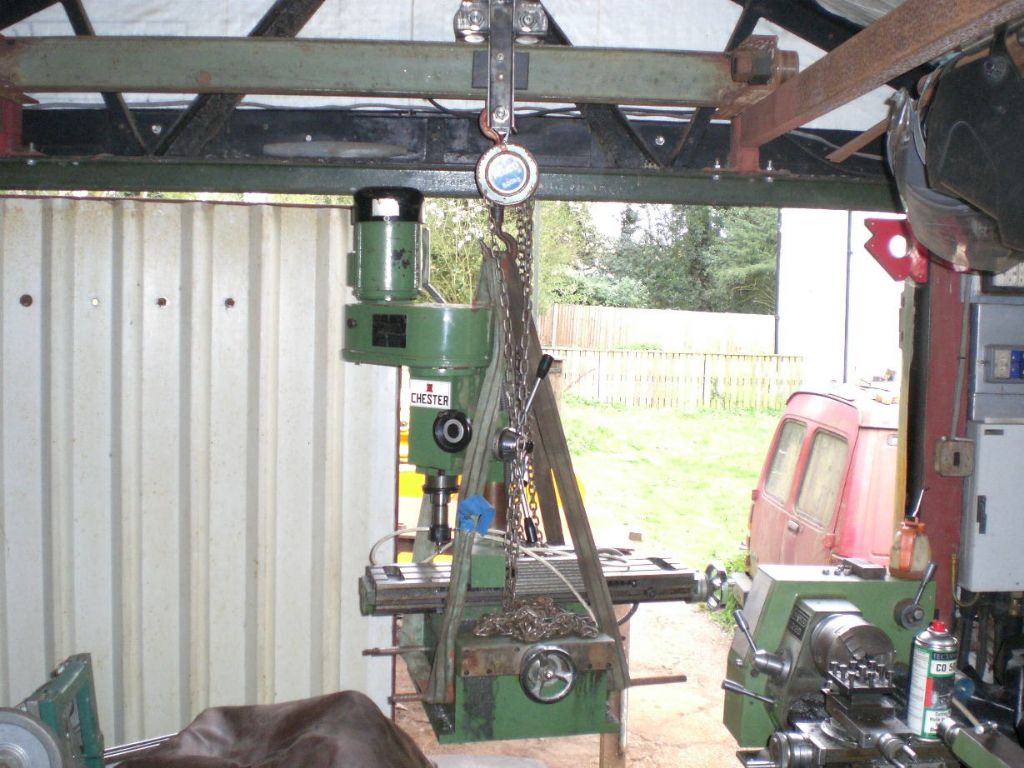

                          FWIW, my advice on moving the machine would be, if possible lift it complete with a crane, with a sling around the Head.
                          If, to reduce weight, it has to be dismantled, it would be better to remove the Head from the Column, and leave the column attached to the Base. Otherwise, the shimming between Column and Base could be lost / misplaced and then you will have the problem of trying to re tram it, to return it to accurate condition.
                          If you are a newbie, this may be a problematic situation for you without more experienced and better equipped help.

                              I think this is 3 phase By the look of the size of the cable and the type of plug as has been mentioned earlier.
                              The motor plate probably shows it is Wired in a Y formation, at 370/80 volts or current I doubt that there will be connections to set it to 240 volts running from an inverter that’s an odd voltage, and not a lot of current 1/2 hip.

                                My Chinese language does not work very well but the rating plate indicates
                                3 Phase motor, star connected, 380v, 1.15A full load current, 1400 rpm.

                                  Thanks for that Zan, so it wouldn’t just be a case of buying an inverter & plugging it in then? I try not to mess with electrical stuff if I can help it so my knowledge is limited…
                                  Hi Michael, thank you, I’m glad it make sense to someone & I’m glad your able to interpret it – I do have a single phase motor that’s 3/4HP that runs at 1425 rpm – think that might be any good if I can shoe horn it in?

                                              Paul,
                                              I’ve just tried OCR and translation on your photo:
                                              This is obviously not complete or accurate, but it’s a pretty good start !
                                              _______________________________________________
                                              のminiature three-phase asynchronous motor
                                              Model A027124 Power 370 pages
                                              15ま
                                              Lead rate 0 insulation grade mesh speed 1400 rpm/s
                                              years
                                              Voltage 380V current
                                              | Factory year and month
                                              Wuhu City Micro Motor-Factory
                                              Connection
                                              Happy to have another try, if you can provide a better photo of the plate.

                                                    Hi Paul, yes it is a Champion mill and it is similar to the Warco ZX15 and the overall given weight is 135Kg. I bought mine for £809.00 which included a collet chuck and set of 8 collets and delivery, in 1997. Didn't find mine to be particularly rough although it did need a little fettling to the column base to make it true to the table. A photo below to show the correct way to lift it, as shown in the user manual that came with my machine. Of course the two bars don't have to be as long as the ones I've used.
                                                    If however, you can use longer slings, you won't need to have the head swung round as I have above.
                                                    Regards Nick.
