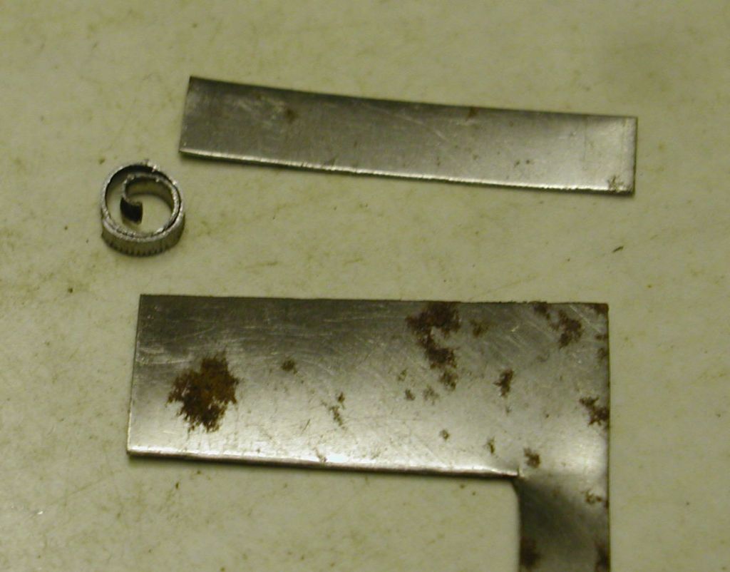

                    I remember using a nibbler tool called a “MONODEX” back in the 80’s, which looked as if it worked on the same principle as the GOSCUT. Just Googled it and you can still get them.

                        The problem I find with the Goscut, is that it gives a slightly crinkly and bent edge to the metal which thus requires filing down. Otherwise, as others have said, it can be tiring to use.
                        Useful in the main for shim material only.

                          The Monodex nibbler has an easier action than the Gosscut and will nibble thin steel very well. The big disadvantage with nibblers is that they tend to mark both sides of the cut.
                          Electric and air nibblers can be very useful in roughing out however the little crescent nibblings are very sharp and nasty!

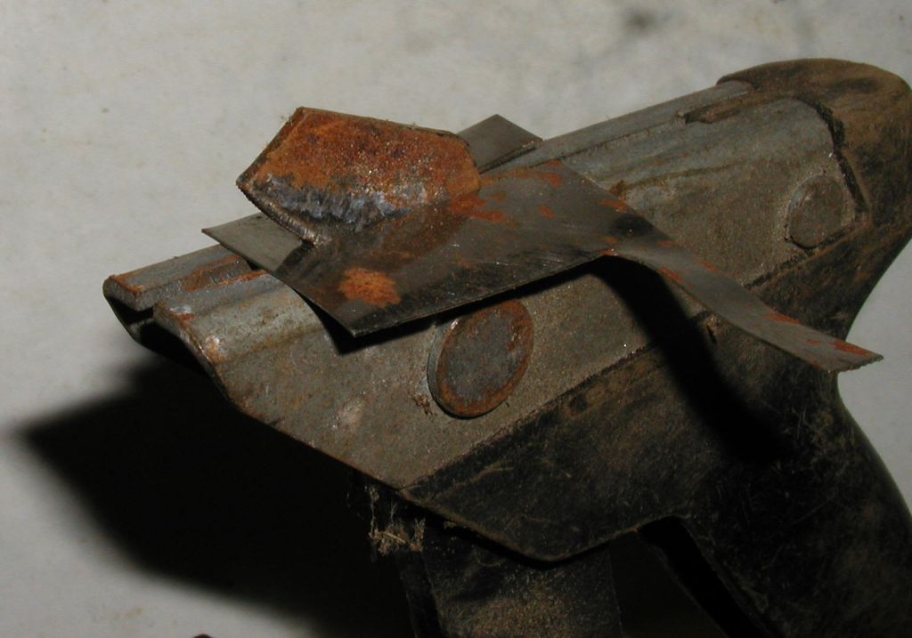

                                            #77686
                                            V8Eng
                                              @v8eng
                                              I was reading Alan’s post yesterday looking for a set of rolls for building his 1:1 scale Titanic.
                                              Large sheets can be tricky without a generous supply of tea and biscuits, guess that’s where you’ve gone during the first photo.
                                              Edited By V8Eng on 11/11/2011 19:46:46

                                                #77691
                                                  Its not me doing the sawing. No not a shetack but an  Eclipse No 55. I’ve got a good one of him using a ratchet drill somewhere, see If I can track it down.
                                                  See if this brings back any memories, I’ve posted it before but quite relevant for a titanic builder
                                                  J
                                                  Edited By JasonB on 11/11/2011 20:06:50
