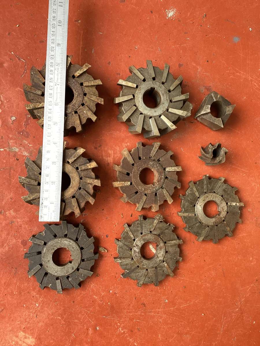

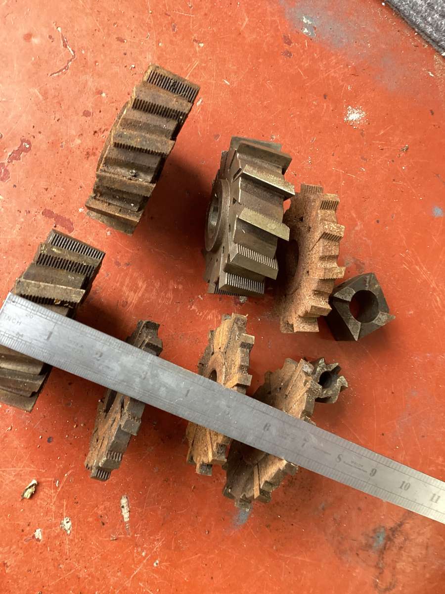

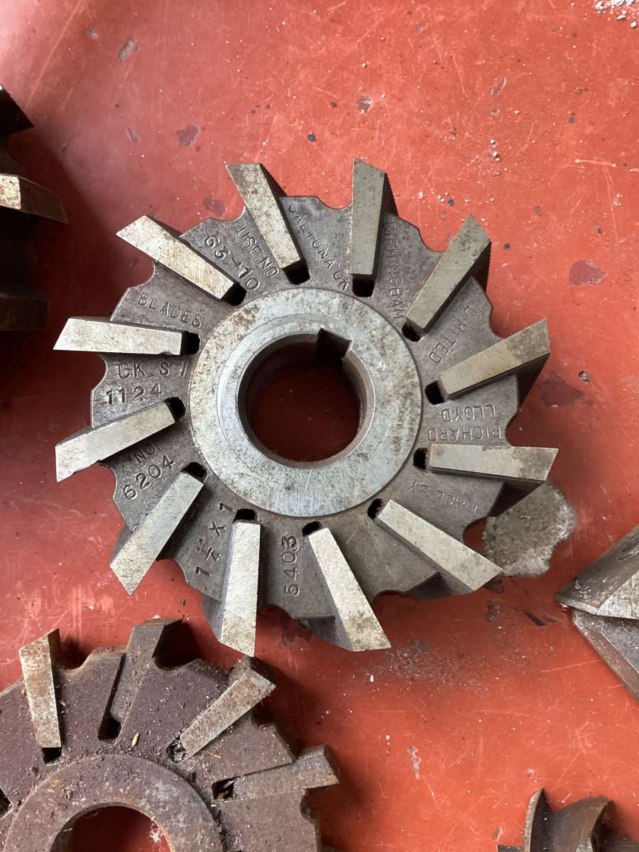

      Hi all. I was hoping someone could please tell me what make of milling machine these rather large tools fit?as per pictures.
      Hoping to list these on eBay for prospective buyers.But unsure how to describe. I am open to offers.
      I have also listed Stuart Turner 10v. Castings if anyone is interested?
      Item number…236016503139
      Thanks.IMG_8012IMG_8013IMG_8014

        Looks like most of them are intended to be mounted on an arbor in a horizontal milling machine, some explanation here. May be some could be mounted on arbors like these:
        ShellMillArbors
        (from ArcEurotrade), What diameter are the holes in the cutters?

            They are inserted tooth side and face cutters for use on a horizontal milling machine.
            Once quite common in industry as they were cheaper to manufacture as only the teeth were made from HSS.
            The other advantage was that the teeth could be replaced, a forerunner of the modern carbide tipped tooling.
            Andy.

              Not a ‘make’ thing.  They’ll fit any horizontal milling machine with an arbour matching the centre hole diameter and keyway.  So put those measurements in the advert.  Value unpredictable.   Not many home workshops have horizontal mills, but someone might be hungry for them.

                Side and face milling cutters with insert teeth,. The central hole will be either 1in or 1 1/4. the latter is rarely used by amateurs. It is important to mention central hole dia, overall dia, width in inches not mm.
                They are not shell mills as used on the arbors mentioned by Thor above as those have notches for the two projections on the arbor.
                Once the width exceeds the diameter with no end teeth they are generally known as slab mills.
                Since so few people use them the value is about half the cost of shipping. I only buy them at shows to avoid the shipping cost. Also as they are intended mostly for removing metal in bulk I can’t afford to be turning that much metal into swarf.
