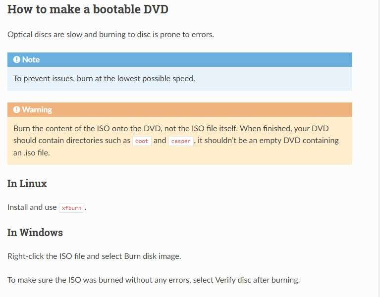

                                        It ‘might’ help when I get to the stage of knowing that I have managed to actually burn the ISO file on a bootable USB stick. Etcher either abandons the writing part way through or it says the file might be corrupt (I’ve not succeeded in verifying it yet).
                                        Not directly relevant because I’m trying to burn to USB device but the first sentence of this (CD) warning is rather confusing to a Linux newbie. How would one separate the file contents from the file itself?
                                        Clipboard 19-1-2025_01
                                        I might change tack and skip the USB method of trying Mint, I might just wipe the PC and do a full install.
                                            Ian P
                                            What they mean is, don’t copy and paste or drag the ISO file onto the DVD – that will just make a copy and your computer won’t recognise it as something it can boot. You want a disc image which will contain the stuff to make it bootable – if you use ‘Burn Disc image’, it will set all this up for you.
