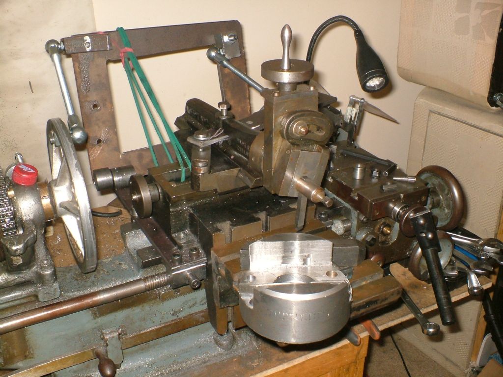

                                  A shaping device on a lathe?
                                  Sounds pretty crazy to me….
                                  #73164
                                  ady
                                    @ady
                                    #73165
                                    ady
                                      @ady
                                      Probbly the most sensible normal person approach would be a variation on a filing attachment which could be used for slotting small square holes.
                                      #73166
                                      ady
                                        @ady
                                        The project is currently ongoing and has been for months, I’m a busy teddy bear most of the time, and only got to this stage 3 days ago so there are various geometric, loading point and  other issues to sort.
                                        Prototype “Teething issues” lol.
                                        The biggest unforseen issue is the backstroke.
                                        The geometrics are like a proper shaper, going anticlockwise 2O’clock to 7O’clock are the power stroke while 6 o’clock to 3O’clock does the backstroke.
                                        However.
                                        The 3O’clock to 2O’clock backstroke point where the stroke changes direction is vicious and you can see the temporary green lathe belting rubber band which damps this event.
                                        Any play in the keyway between the bullwheel and the spindle, (backgear engaged, 50 rpm) results in an unhealthy banging noise at this point.
                                        It’s not an issue for lathe work, since the load is only applied at the fixed cutting tool point (at 9 O’clock) but a power tool which changes direction has a loading event (the faceplate balljoint) which constantly travels around the faceplate in an anticlockwise direction.
                                        The solution I presume would be to dismantle my headstock and refit the bullwheel to the spindle with a proper tight fitting keyway.
                                        Edited By ady on 11/08/2011 06:56:30

                                          What I can say so far is….it’s nice to let the machine do all the hard work while I stand there with a big grin on my clock.
                                          Workshop space is very tight for me, the reason behind the original idea, and I can’t go putting a proper 200kg powered shaper into an upstairs bedroom even if I did have the space.
                                          No more milling cutter hassles ever again.(well almost none) I really really hate milling and just want to “get it over and done with”. Milling for me is no fun at all.
                                          The price of a lump of simple HSS versus a milling cutter is…huge, and nothing annoys me more than a chipped cutter because something unforeseen happened even though I checked that everything was hunky dory.
                                          Good squareness with a nice finish can now be achieved with relative ease.
                                          #73170

                                                      The ram will always return at twice the speed of the forward stroke. I can tell you from personnel experience that the Shaper was still a popular workshop machine well into the eighties, but mainly by those who knew how to use it to it’s full potetional. I had one in my own comercial workshop into the late nineties. There is no better machine to achieve a totaly flat surface and can easilly be set up to cut key ways, only wish I had room in my workshop (shed) to fit one like yours in, thats of course if I could locate one, enjoy it, I’ve always maitained that god didn’t rest on the 7th day, he invented the shaping machine!!!!
