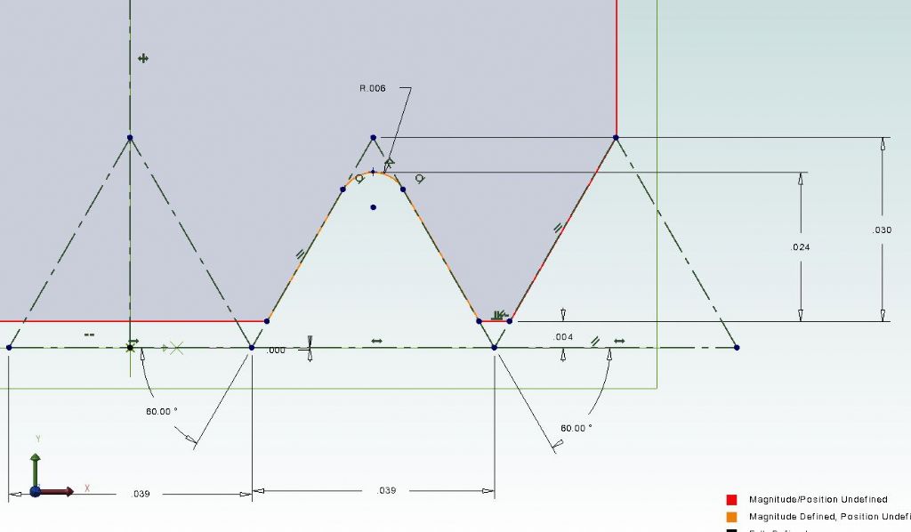

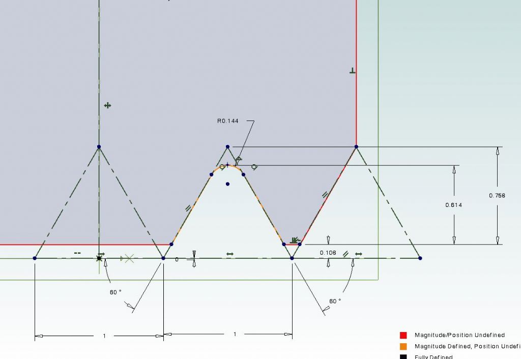

                    #556534
                      Although the OD less pitch is a good way to work out a tapping drill size I don't think it gives a fell depth of thread, more like about 80% which is why the 0.45 to 0.5mm figures in the last two posts don't match the thread data that I posted a link to which can also be found in Zeuz book and all over the net..
                      The OP asked how it can be calculated well one way is to draw it out in CAD. Here I have shown a series of three 1mm edge length triangles at a 1mm pitch which gives the correct flank positions that would be what a thread wire would measure against. I have then drawn in the root radius and also the flat to the crest.
                      It is then just a case to measure how deep the root is from the OD and I get 0.614mm which is probably rounding up a bit somewhere from the published 0.613mm. I have also shown the dimension you would need to go in if the tool were pointed this being 0.758mm. So depending on your tool geometry you will need to feed in somewhere between 0.613 to 0.758mm from nominal 6mm dia.
                      Figure scan easily be checked for correct depth as Major dia less Minor Diameter is 4.773mm and half that is 0.6135. Click image to enlarge.

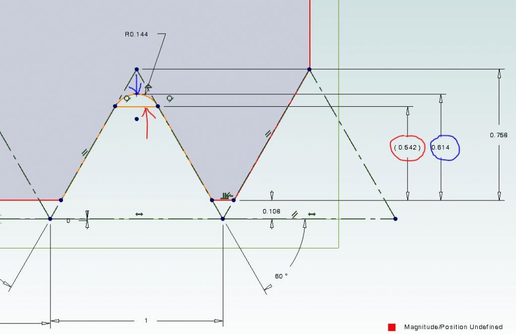

                        #556538
                          Andrew what would be the reason that Machinery's has it as 0.541 and Zeuz etc have it at 0.613mm?
                          Or are you quoting for a female thread and Op is cutting an external one? Zeuz does give 0.541mm as depth of Female thread.

                            #556546
                              Adding a line across the tangent points of the tangent points of teh root radius you can measure the siz eyou give that matches the "flat" profile that Machinery's shows and the deeper cut needed for a fully radiused tool, which brings us back to mine and Pete's original comment that it depends on your tool.
                              You might want to ask Ketan to sell you a "Metric Revision" Zeuz book as it has a similar diagram to my earlier link which shows all the details that the older books lack including depth of external thread as 17/32H which happens to equal 0.613mm That's for a tool with a rounded nose much like a full form insert and insert makers charts also show depth of 0.613mm for 1mm pitch.

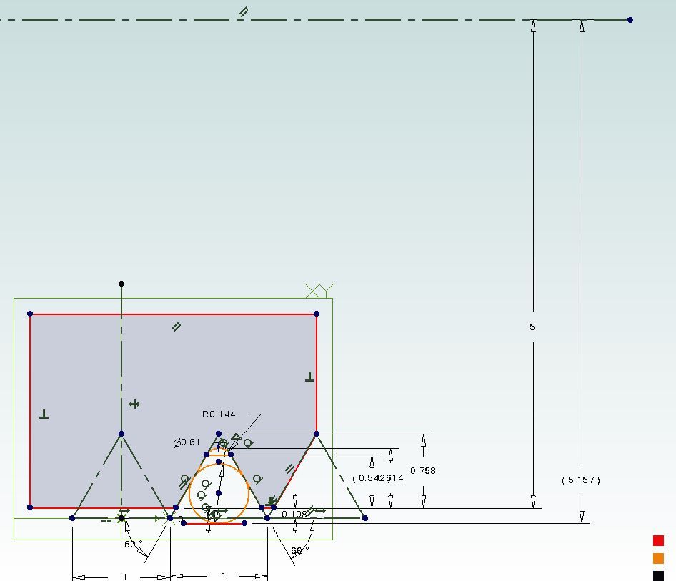

                              #556547
                                As A final check of my drawing I added a circle to represent a thread wire, only measured to ctr line of a nominal 10mm dia bolt and got half what the thread wire distance is eg 0.313mm over nominal.
                                So looks like if using a full form external insert for 1mm pitch metric thread and nominal major diameter ( I don't reduce the stock dia) then you need to feed in 0.613mm, partial form or hand ground will differ.

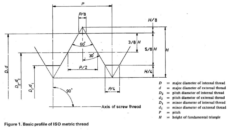

                                    #556618
                                    Martin Connelly
                                      @martinconnelly55370
                                      From the ISO Standard
                                      Here are the tables needed for doing this. They show that for a pointed tool you need a depth of H x 7/8 and for a truncated tool with a point width of P/4 the depth of cut is H x 5/8. This latter one would probably bind and is the absolute minimum. Note on the diagram where the "Axis of the screw thread" label is. It shows which is internal thread form and which is external thread form. The profile of a home ground tool would be an unknown factor and is more likely to be a rounded form than a really sharp point since a sharp point will soon wear away. It is this unknown that results in the need to cut and test as you progress.
