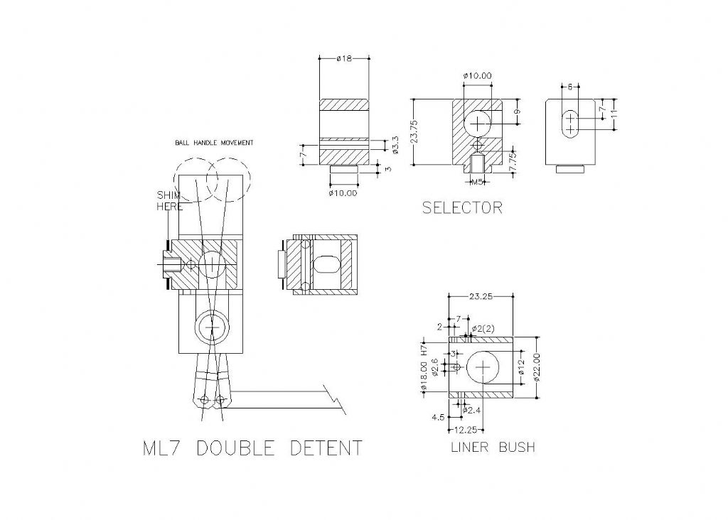

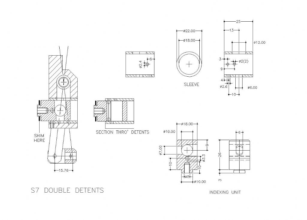

            After having a look at applying the Double Detent to the ML7 this morning. It was not as easy as it might seem at first glance and has required that the detents be placed a 90 degrees to their original position. This will stop them getting in the works once and for all. While I was modifying the ML7 parts I did the S7 as well.
            If I get chance over the next couple of days I will take a look at the Big Bore version, from memory, which is not good these days, it should follow the S7, but it always pays to check.

            #442200
            David Haythornthwaite
              @davidhaythornthwaite90386
              Thanks Gray,
              Stored away until I get to that part (could be some time).Thanks for your hard work.
              Not being good at reading drawings, I imagine that the disengaged detents are horizontal across the sleeve and the forward / reverse are vertical across the sleeve.
              Regards
              David
              #442205
              Graham Meek
                @grahammeek88282
                Hello David,
                Fortunately the work did not take that long, once I had gathered my thoughts from 30 years ago.
                Just to make things a little clearer. The Detent balls, and the Indexing holes in the sleeve, are both in the horizontal plane, ie parallel to the top surface of the Bedways.
                If you compare the cross sectional view of the assembly above with the original drawing in the book. The original long hole for the spring loaded ball is no longer there, so you can leave this out.

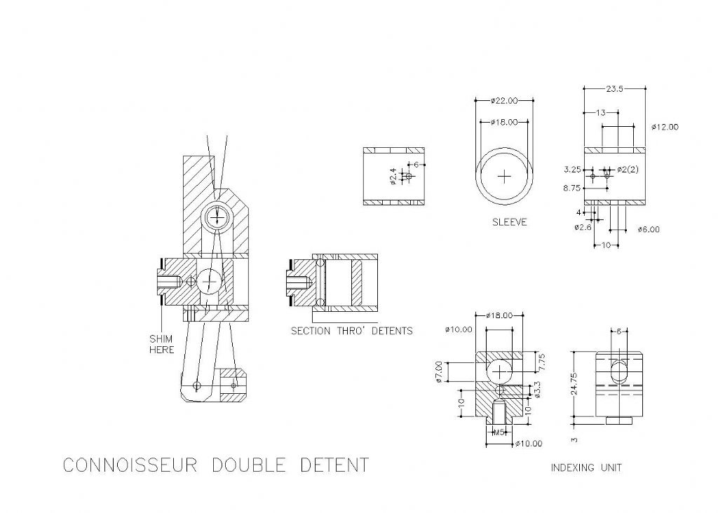

                #442248
                Graham Meek
                  @grahammeek88282
                  As promised here are the details for the Connoisseur, or Big Bore Double Detent
                  Regards
                  Gray,
