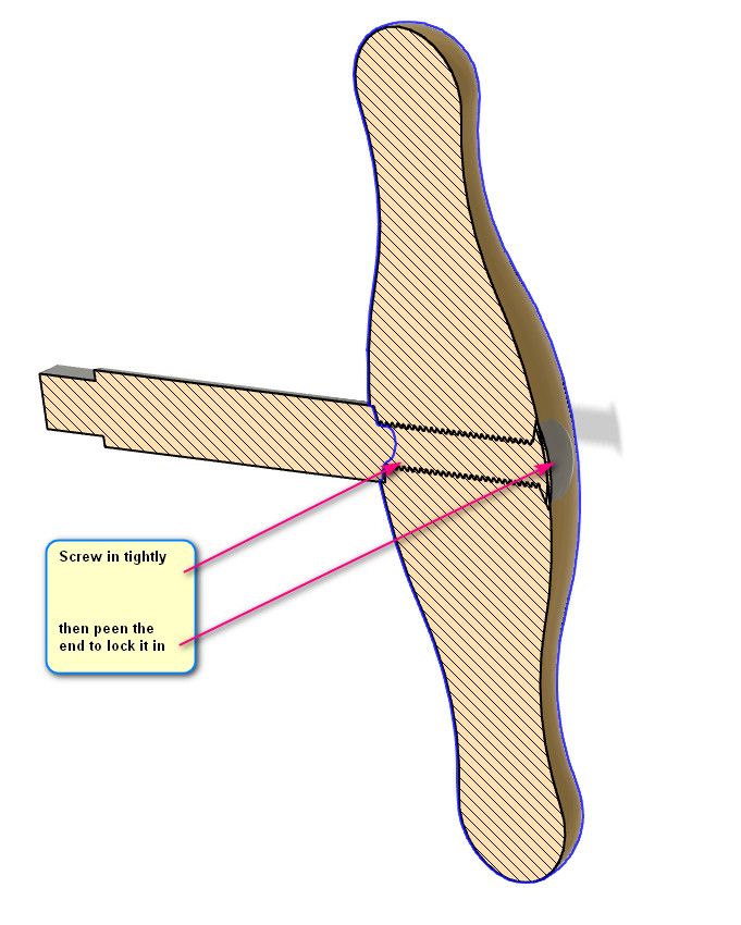

                This is the way I'd do it.

                  Yes Garry I like it, so for me its a toss up between cross pin or thread & rivet the end.
                  Do you think it likely the peened end would show when finished an irregular circle due to the thread?
                  Cheers
                  Chris.

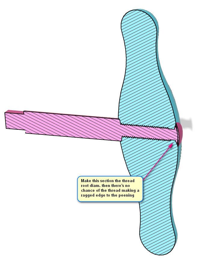

                      This method will prevent an irregular shaped circle.
                      #476046
                      Chris V
                        @chrisv
                        Thanks Garry, yes that covers all bases for me. When you drew that did you made a side on drawing first?

                          Hi Chris,
                          Yes, I did a side-on drawing first.
                          I've made an extra key for my individual 4-jaw chuck (2 keys make it so much easier to centre work) and didn't bother to harden it. I've never seen anything to suggest that I made a mistake, though I'm sure many will say I'm wrong.

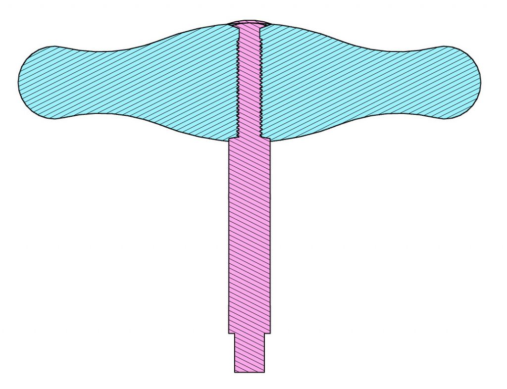

                              Is this what you wanted?
                              #476130
                              Chris V
                                @chrisv
                                (-: Yes! thanks so much!
                                Chris.

                                  I think cross-pinning is better than threading and much better than shrink fitting.
                                  There could be considerable torque on the joint, tightening and releasing the chuck. With shrink fitting you're dependent on interference friction, and with threading a tight releasing could throw much of the stress onto the peened countersink.
                                  Still, if you get a problem it should be easy enough to cross pin it afterwards.
