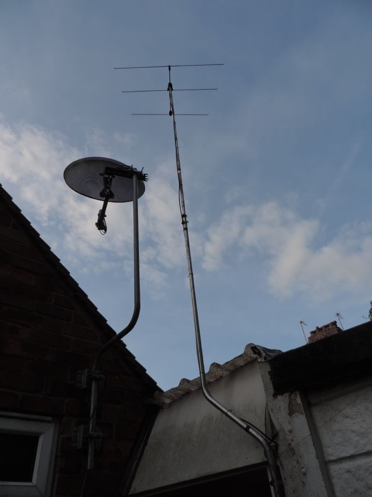

      Has anyone here tried using a software defined radio to detect meteors?
      I've got a £16 module, made a yagi antenna and after much sweat and toil got them to work with HDSDR.
      With much advice from the astronomy forum, I've managed to detect a few meteors. Now I have to battle with a program called 'Spectrum :Lab' to achieve automatic recording.

          With that Sky dish pointing earthward you are unlikely to receive anything other than Mrs Dales Diary or Gardeners Question Time laugh
          Rik
          #358237
            Posted by Rik Shaw on 17/06/2018 20:44:51:
            Rik
            Sadly the Sky dish is accurately aligned…

                          Sorry to be a pedant but the Sky dish is an Offset Cassegrain, and as Neil says is accurately aligned when the boom with the LNB is pointing earthwards.

                                I think you'll find that the SKY dish in Neil's picture is mounted as per normal and that it looks to be pointing down is an optical illusion which is partially due the fact that one can see the LNB support through the perforations in the dish, again standard for dishes in order to reduce weight and wind resistance. I agree that it is an offset axis dish, in the vertical axis, which means that the dish itself can be mounted more or less vertically and not at some angle approaching 30 deg, a space saving arrangement that makes installation easier and more compact.

                                            Neil's photo of a heavy yagi balanced on top of a tall, slim, cranked, unstayed aluminium pole reminds me of an important guideline in Amateur Radio. If you're not laying awake worried on mildly windy nights, your antenna isn't high enough!
                                            Please don't spoil the illusion by explaining it's just the camera angle. I want to believe that thing's 60 feet up and Neil regularly shins up the pole to make adjustments.

                                              Quite light that 3 ele beam but will move a bit on the thin poles interlocked together. Might go around 50mph at 32ft.
                                              If able to get it aluminium scaffold pole takes and absorbs the sway, have had stuff up to 63ft up using those poles attached to it (38 ft) above it for several years and relatively high up.

                                                    Hmm… that mast is only 4m high, not 32 feet. It's stood upright for about 15 years with a weather station on top with similar windage…
