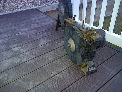

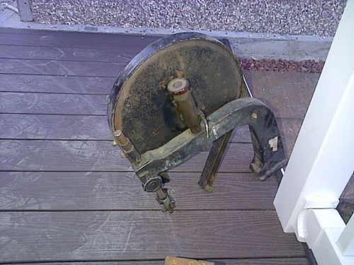

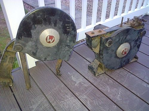

                                      I bought bought this off ebay when i was looking for a good solid small bandsaw ,But i found a much better (for my purposes) one later so this has sat in a corner. It has no table on it or tilting mechanism. The motor was totally wrecked.
                                      Would this make a decent small metal cutting bandsaw. The whole thing is small but cast iron(even the wheel doors) . The guides are all there.
