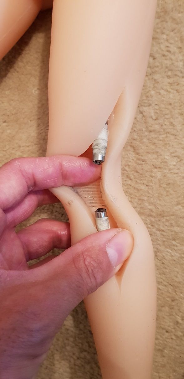

                  I think Michaels idea would work, the only problem being that the thigh and chin "bones" are both solid metal, so the screw rod of that kit wouldn't be able to screw into them.
                  I think I would either have to cut further up/down the leg to see if I could see if it is hollow tube further in, or I'd have to find a hollow sleeve to go over both pieces? To be honest I'm not happy having to expose any more of the skeleton as the silicone will probably be a bugger to try and re-seam later on. :s

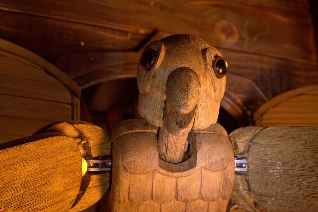

                    The "wire" you currently have in there is called Animation Wire and available in many sizes. It's often used to make a support for sculpting figures in clay. Ray Harryhausen would machine his own armatures which did consist of ball and socket joints and they're not too difficult to make. It's been about ten years since my last animation armature as CGI has almost completely taken over but the principles remain the same. I can't even remember what the advert was for but it featured a number of characters including a wooden bird living in a dolls house.

                      You would need a ball joint (or animation wire) at the hip and ankle though not only to allow for the foot to meet the ground in a flat manner but also so the leg and ankle can twist.
                      #399493
                      Chris Trice
                        @christrice43267
                        One of the original King Kong armatures that sold at Christie's about ten years ago. Note the knees are ball joints but they include a pin running through them so they only act as a hinge.
                        Edited By Chris Trice on 10/03/2019 03:16:18

                                            However, your idea sound's amazingly like a proper knee joint in theory…I think?!! But would it scale down to the tiny size needed, while still being strong enough to support around 4kgs in weight?
                                            This is the space that it would have to go into! The two metal rods are 8mm in diameter and the space between them is about 35mm. I couldn't remove the old (bendable) wire as it's been crimped in I guess some way further up the leg and I don't want to cut any more silicone for fear of never getting it back to shape. So if the joint was to fit it would have to fit over the metal rods.
                                            If you do experiment I'd be very interested in seeing the results….. even if I don't understand how you did it!!
