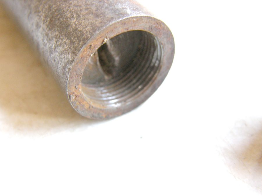

                The Merry Miller
                  @themerrymiller
                  That reminds me, I have tucked away somewhere in my workshop a 4" long, beautifully made plumb-bob. It belonged to my grandfather.
                  I don't know if he made it himself or purchased it, I have never discovered a manufacturers name on it.
                  Anyway, one day I decided to take it apart and it was a good job I was holding it upright because when I unscrewed the inner metal plug I could see it was full of mercury.
                  I ask the question, why on earth would anybody make a plumb-bob with mercury in it?
                  I suppose it could have been used as a damping medium to minimise the swing.
                  I would be interested to see other peoples comments on this rare device.

                    Les Jones 1
                      @lesjones1
                      Hi Len,
                      The thing you have found may be the weight for the end of a pendulum. I think I have heard of this method to provide temperature compensation. As the mercury expands its centre of gravity will rise with respect to the bottom of its container. This can compensate for the increase in length of the main part of the pendulum.

                      The Merry Miller
                        @themerrymiller
                        There's logic to your theory Les that I had not considered.
                        I will endeavour to find it and place a picture on the forum tomorrow with a fuller description.

                                      #88936
                                      The Merry Miller
                                        @themerrymiller
                                        PB 1
                                        PB 2
                                        PB 3
                                        As promised attached are some pictures of my grandfather's Plumb-bob/pendulum whatever.
                                        The small male tapered section you can see has a fine groove cut into the taper.
                                        When the fine wire or fine twine used to suspend the device was fitted through a very small hole in the top of the mating tapered cup it would have been located along this groove and the end passed through the cross hole visible in the picture. The mating tapered cup would then have been pushed down onto the male section thus trapping the wire/cord/twine, a bit risky I would have thought. The tapered cup disappeared years ago.
                                        The largest dia. of the taper is only 1/4", the length of the taper is 3/8". The overall length is 5 1/2" and diameter is 3/4".
                                        Note also the spool arrangement which would have been used for storing the suspending medium which I think had it been fine wire, could have caused some coiling problems!
                                        You can just make out the slotted screwed plug in the main body behind which is the quantity of Mercury.

                                          Les Jones 1
                                            @lesjones1
                                            Hi Len,
                                            I think you are right that it is a plumb bob. If you Google "mercury compensated pendulum" all the pictures show the pendulum consisting of two glass tubes containing the mercury. This is like the one I saw when i was in my teens (50 + years ago.).
