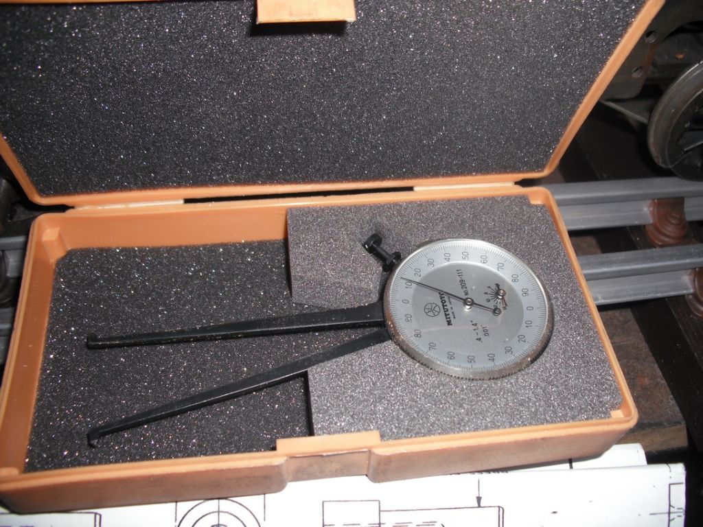

      Hi All . I am trying to bore some GM axle boxes to take a 12mm OD needle roller bearing. It requires an N6 interference fit but I cant seem to solve two issues .
      Although I am using a tool with as large a stem diameter as possible I am still getting bell mouth/ taper down the length of the bore which is appx 15 mm.
      Also any idea on how to accurately measure such a small bore please? vernier/ digital callipers don't seem to give repeatable accuracy and my expanding bore gauge doesn't go small enough.
      would greatly appreciate any input having already scrapped two boxes!

          #243719
          Bob Brown 1
            @bobbrown1
            I use this for small bores although a go/no go gauge may be an option image00003.jpg

              Hi RR
              Measuring small bores accurately is expensive.
              If you don't want to do it too often, as Bob says a Go / No Go gauge is a good way to go and you can turn them up easily enough from mild steel. You can easily measure the diameters with a micrometer.

                        #243748
                          Posted by Robert Dodds on 21/06/2016 22:55:07:
                          Is nobody prepared to offer advice on the OP's primary problem? He scrapping parts because of bellmouthing!
                          As Joseph Whitworth famously said:
                          'You can only make as well as you can measure.'

                              #243756
                              bricky
                                @bricky
                                Bore close to size and make a D bit to finished diameter to finish with.
