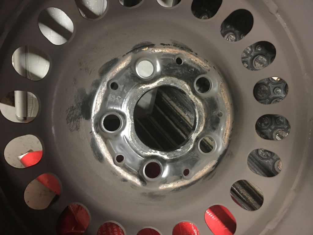

      How would I measure the PCD of the holes in this wheel.?
      'Friend of a friend' wants some spacers making. And friend said to friend, I have a friend who will make you those.! dont know He is aware you can actually buy them but they have slots and holes all over them to make them universal. These I am told he does not want.
      So I have the spare wheel which I am told is off a 1994 C class Merc. But what is the best way to measure the PCD.?
      Cheers, Nick

                  If you really feel the need to measure them:
                  • Make two tight fitting plugs, with centres, to fit the holes.
                  • Choose any two holes, and measure the chordal distance between their centres
                  • Repeat for another pair of holes
                  • Learn about 'perpendicular bisectors'
                  • Apply your new-found knowledge.

                        For five holes, measure the centre distance between two adjacent holes and divide that number by 1.175.

                              FYI the formula for equi spaced holes is:
                              PCD = chord divided by sin(180/number of holes) in this case
                              = chord/sin(180/5)
                              = chord/sin 36
                              As suggested above, tight fitting plugs in two adjacent holes, measure across, minus one diameter and that is the chord.

                                    Measure with calipers:
                                    PCD = (diameter of centre hole) + (diameter of one wheel nut hole) + 2*(distance between centre and wheel nut hole.)
